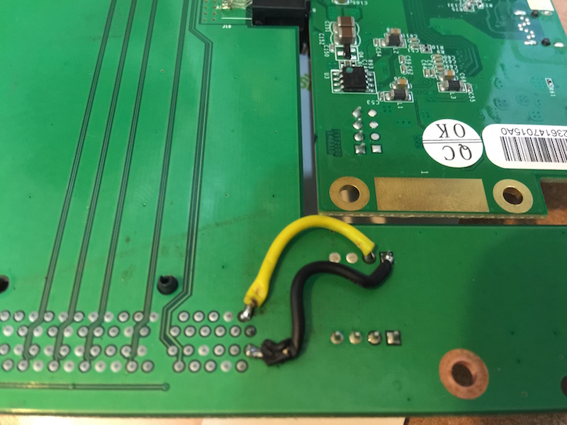

I just soldered the J6 cable like the photos and tape A123 and B123 and disconnect J4 cable (yellow/black).
After connected the Akitio default PSU (for test) nothing came up no led no fan, did I do anything wrong? Or do I need to use the ATX PSU in order to use this method?
Nando's instructions don't say anything about disconnecting that yellow/black cable. If you like to try it back powered as I did, remove the tapes as well. And please always use only the ATX PSU with a molex-to-barrel adapter, no other power sources.
So it means there are two difference methods.
1. Taped the A123 B123 and connect J4 yellow/black cable
2. Disconnect J4 cable and untaped the A123 B123
Both need power from Molex to Barrel PSU
I understand correctly,right?

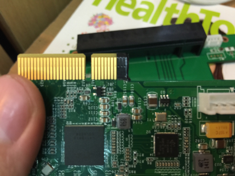

Oh and one thing, this photo from you show that you still connect J4 cable. Did you remove it later?
http://forum.techinferno.com/attachments/enclosures-adapters/14171d1424708172-c3_capacitor.jpg

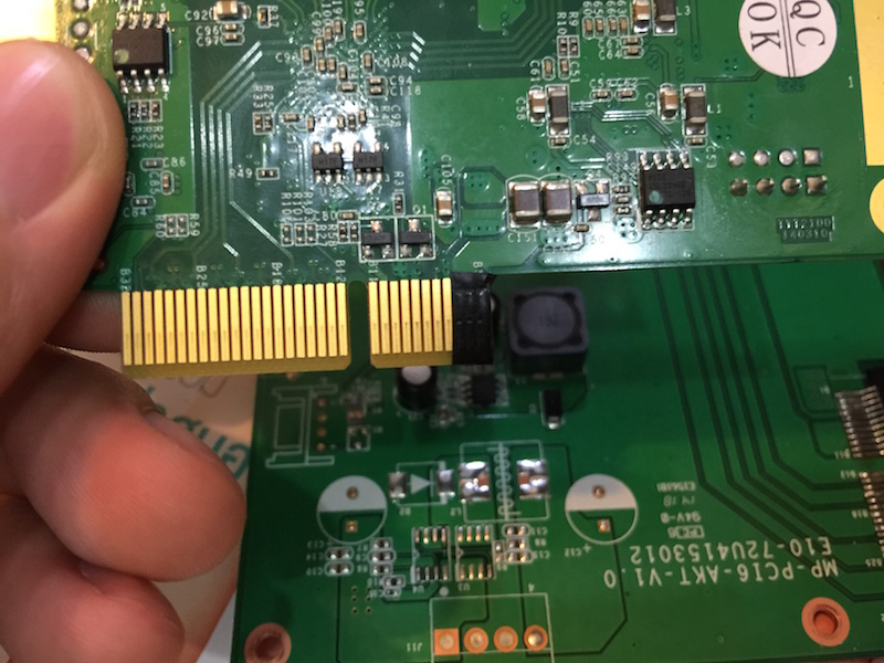

Correct, and the GPU on the x16 slot. The method 2 seems to be as stable as the taping trick with the Asus R9s, but still crashes in low power conditions.
The photo describes the taping trick situation.
Is there anything I can do to increase power stability?
Yes, solder in the missing C3 (100UF/16V) and C4 (10uF/25V) capacitors as is provided by the higher-rated but nearly identical 120W OWC Mercury Helios product to provide some additional smoothing/filtering of the 12V_ATX input power to the slot. See http://forum.techinferno.com/enclosures-adapters/8848-%24299-owc-mercury-helios-16gbps-tb2-discussion.html#post121898
Could we have more infos on the type of capacitor. I'm having a really hard time to find them online. Thank you
Edit: Found them:
Part codes are EEE-TP1C101AP and EEE-FP1E100AR in eBay

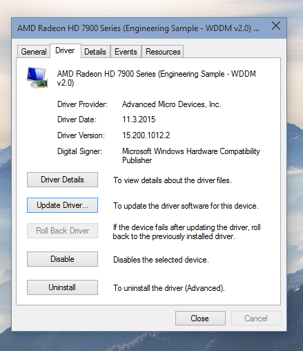

@Oscar J informed me that he got the his second Gigabyte 7970 OC working perfectly stable without a powered riser + 650M equipped MBP on OS X. The first Gigabyte 7970 was identical but crashed after 5 minutes with the Indigo renderer. I suspect the reason could be different firmware or BIOS chip. I’ve been tracking down the reason for both the black screen and booting issues of the different architecture GPUs, and I bet that the common factor is EFI version:
http://forum.techinferno.com/diy-e-gpu-projects/8619-tb2-macbooks-allow-monitors-used-nvidia-egpus-osx.html#post120215
