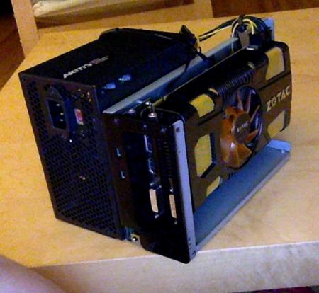

Hi,

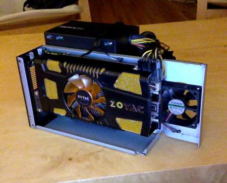

I built an external gpu combo this afternoon and encountered the same issue with the welded points. I have a slightly different solution that required far less effort;
I went to the dollar store and bought a set of cheap jewelers screwdriver then used a hammer and the flathead tool to pry it open and break open the welded spots. Start with the smallest flathead to get some leverage then use the bigger one to crack it open
It'll take a few minutes but it's not hard. Here was the end result of my build, I used lots of 3M double-sided foam tape
Thx for all the great posts, Nando- I would have posted a guide, but I finished before your request.

Wow, that look really cool. The only drawback is that yellow-black cable will get melt.
Fantastic job. Love it. Now wanting to backtrack and apply eeevan's which is now the 'best practice' in the previous post, linked from the opening page.
Definitely. The yellow/black cable is too low gauge to safely pass 75W slot power. The fix is apply the mod at INFO: passing 75W slot power without a PCIe power. That is, solder two yellow cables 18AWG cables on the reverse of the J6 location and apply cellophane to first 6 pins of the x4 board.

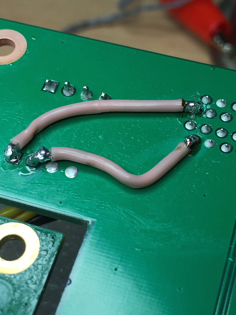

Ok so I read the guide on how to modify the Akitio to pass 75w clean to the pci-e port.
http://forum.techinferno.com/enclosures-adapters/7205-us%24189-akitio-thunder2-pcie-box-16gbps-tb2-98.html#post122901

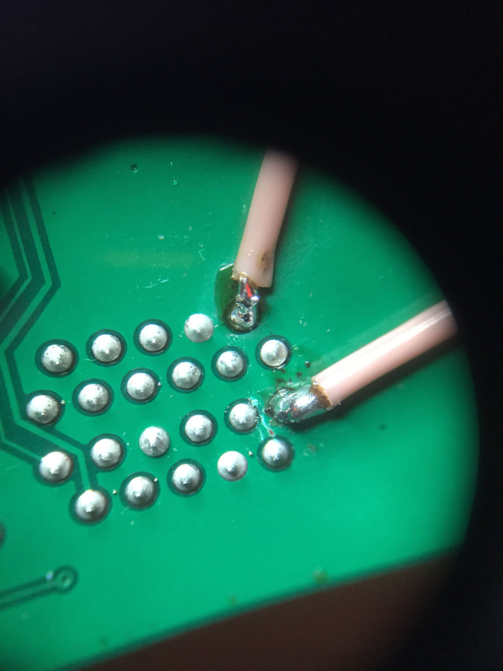

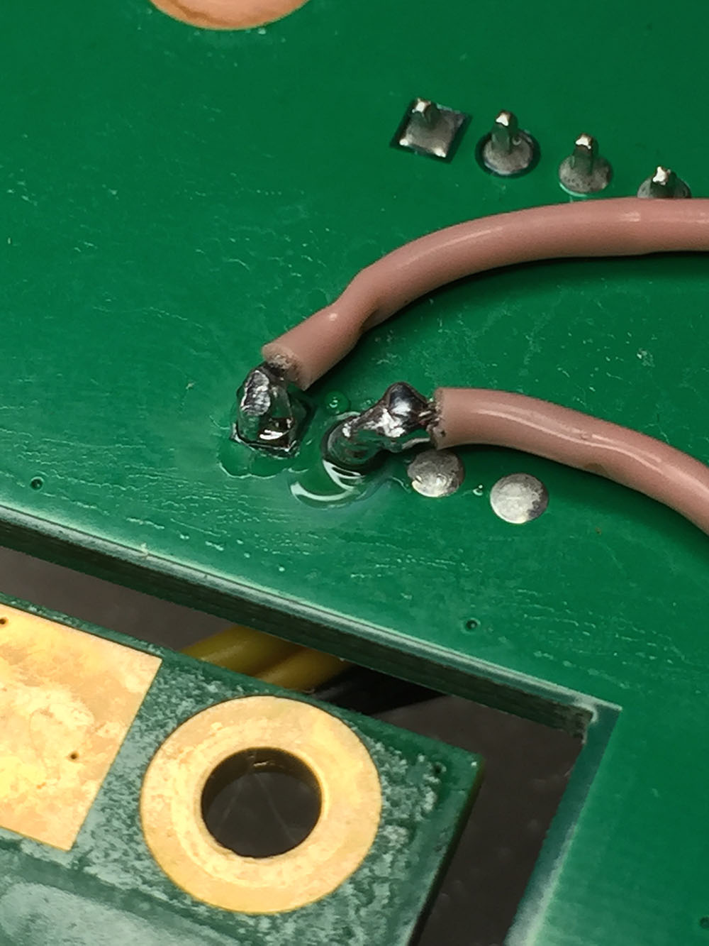

Today I soldered and from what I can tell I did an alright job but after doing some continuity tests I have some bizarre things happening. I attached photos and a diagram showing where I found continuity. Continuity are the purple lines.
Still I plugged the board with the akitio PSU and nothing blew out so I am confused. Can someone help? I am reluctant to put my GTX 970 in there right now.
Nextstep is to put the capacitors tomorrow.

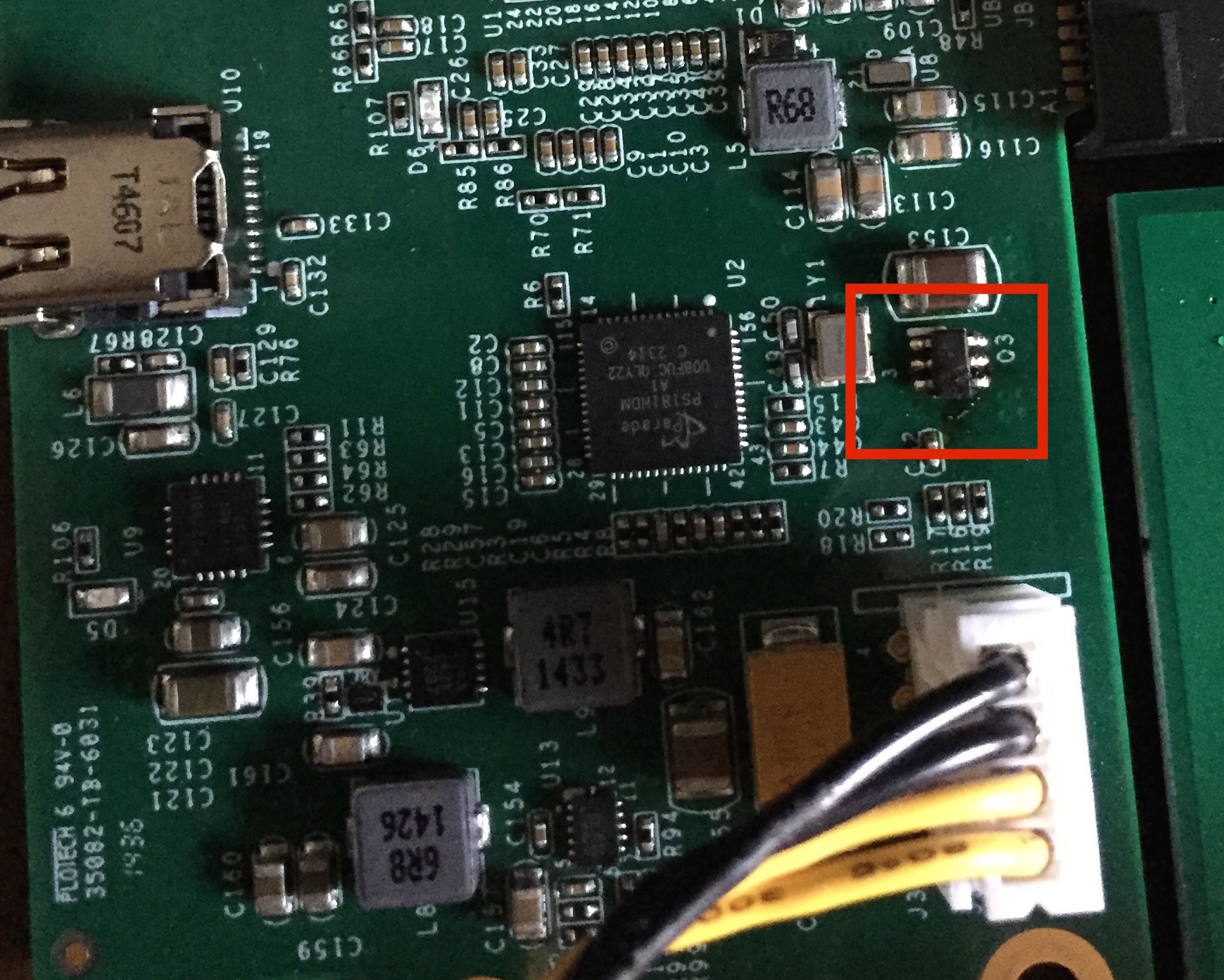

Precise work! The J6 +12V spot needs some electrical tape, so that it won’t accidentally connect to the J6 GND spot which is very nearby on the right side. All those x16 slot rear side +12V spots are connected as shown with red circles, the yellow is not connected and blacks are ground.
The three +12V corner spots is the easiest area, that's my latest mod with a single thick cable.

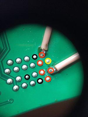

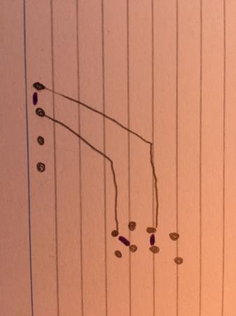

@goalque Thanks for the infos. So if all the red are connected then my continuity tests are good. Still don't understand why both wires are connected but still it did not blow up with the PSU connected (no graphic card yet) I guess thats ok.. ?

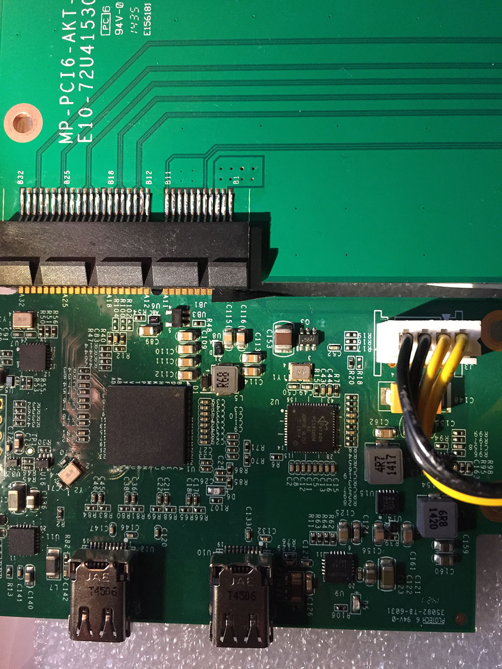

One additional benefit: you can completely detach the 4-pin yellow/black cable that may melt at higher temperatures. TB card will be back powered.

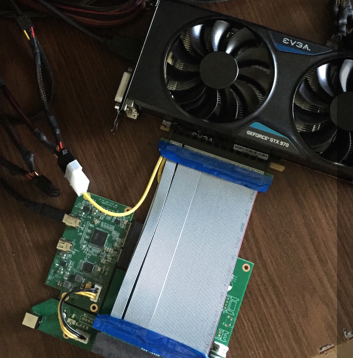

For this build, I've been following goalque's and Dschijn's implementation guide.
Parts listed here:
-Late 2013 rMBP 13" model
-EVGA 500B PSU
-Akitio Thunder2 PCIE Box
-Powered 16x Riser
-EVGA GTX 970 SC
-720p HDTV (using as an external monitor)
I'm having a problem of starting up the GPU and the Akitio.
I plugged everything in and I did the "paper clip trick" to the PSU and that is working fine.
I'm not too sure if it's the riser that's causing the problem or not.
When I directly plug in the GPU into the Akitio 16x slot, green and blue light pops up while using Akitio's own PSU (I know it's bad to have 2 PSU's connected to the Akitio)
But when I connect the powered 16x riser to the Akitio with the GPU and the PSU, nothing turns on (I'm not using Akitio's own PSU)
I then took off the GPU from the riser and I connected the molex from the EVGA PSU onto the powered riser molex and no lights pop up.
I think it may be from the powered riser due there only being one yellow wire, but I'm not too sure.
I also read on a forum that there's no need for a powered riser but I can't remember where I read it from.
Hopefully I get this situated.
EDIT: Forgot to mention that I followed all the steps on goalques implementation guide and I'm updated with Windows 8.1 and Bootcamp drivers. Sorry about that!

Your powered riser is not "back powered", I can see that from the picture. Use a molex-to-barrel adapter with this kind of riser, or get a new powered riser which has two yellow +12V and two black GND wires, and no looped yellow wire.

That may very well be the case. Just be aware that the yellow/black cable supplied with the AKiTiO is using 22AWG cable. This is fine for the specced 25W slot power + 2x10W TB power (45W total). When you are carrying 75W + up to 2x10W TB power, it's being overdriven. The danger is the yellow insulator may melt. The aforementioned mod corrects this by using 18AWG cable. In addition, by isolating the first 6 pins on the x4 board it also ensures that power is passed directly to the PCIe slot rather than via the TB board that's been engineered to provide 25W slot power.
Well, I just fried part of Akitio's board by using the molex-to-barrel adapter(I know it was fault and responsibility for frying it).
The first time I plugged it in it was fine and everything. Green and blue lights came on.
Second time I plugged it in I hear a sound of flickering and see a small fire come out of the small spot (in the red square/rectangle)
I unplugged the riser, gpu, and thunderbolt cable to test if it still works.
So far the green and blue lights still pop up but other than that I don't know.
Really frustrated with this build, got the wrong riser and burnt my Akitio board:mad:
Not sure if Akitio will replace part of the board or not but I will email them soon about the problem.
PurpDank, sorry to hear of these troubles.
Would be helpful if you knew what exactly you did wrong so we can avoid burning up more of these.
Was something plugged in incorrectly? PCB resting on metal?
Well, when I saw the flicker, the molex from the PCI-e riser was resting on that little spot, but the plastic was only touching it. But I'm pretty sure that's what caused the small fire.
I just put up everything so I don't burn anything else lol. But I plan on buying another riser like goalque said.
But I do know that green and blue light still pop up. Just hoping that it still works.
