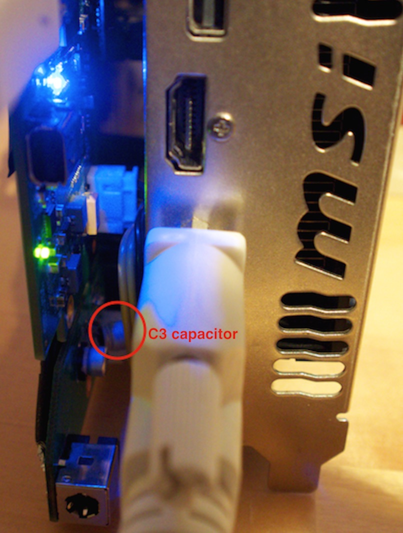

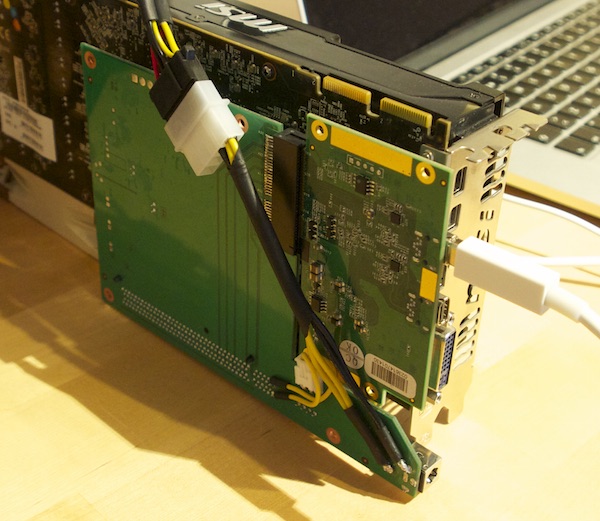

Tech Inferno Fan Posted February 23, 2015 Author Share Posted February 23, 2015 I guess so, it also works fine on OS X. Back-powering the Thunderbolt card may keep the system stable, but I would recommend the taping trick - it’s very easy to tape those 6 pins of the powered riser to achieve same results. In addition to this, you only need a molex-to-barrel adapter. My other mods were:(1) a direct power for x16 slot via J6(2) bypassing the barrel connector(3) an additional C3 capacitorThose separately or together didn’t improve significantly the physics part of the 3DMark11 with R9 280X. The taping trick showed a clear improvement in physics and in low power consuming situations.Here the pics of my new configuration:[ATTACH=CONFIG]14170[/ATTACH][ATTACH=CONFIG]14171[/ATTACH]I would like to get rid of the 4-pin cable, moving all the powering stuff on the rear side. Now there is a risk to melt that cable as it may touch the GPU.Nicely done! Can you now detach your ATX power via the soldered molex lead and run via your barrel-to-molex instead to do your 3dmark11 physics test? If stable, that would confirm C3 cleaned up the barrel input signal. If still unstable then your barrel-to-molex adapter was not delivering reliable power. Quote Link to comment Share on other sites More sharing options...
euqlaog Posted February 24, 2015 Share Posted February 24, 2015 Nicely done! Can you now detach your ATX power via the soldered molex lead and run via your barrel-to-molex instead to do your 3dmark11 physics test? If stable, that would confirm C3 cleaned up the barrel input signal. If still unstable then your barrel-to-molex adapter was not delivering reliable power.Thanks! It’s still possible to use the molex-to-barrel adapter instead of directly soldered lead. Passed the 3DMark11 test only once with the R9 280X, the second run of physics crashed. I tried again with the soldered molex, and made a new record: 3 sequential physics tests passed. But the bad news then… I couldn’t pass even the first run of physics after rebooting. Powering off the eGPU from the power strip did help to pass the physics again. Maybe the components of the AKiTiO became too hot after several 3DMark11 runs.I know that my current molex-to-barrel adapter is not properly made. It has only one black and one yellow wire and the wires are too thin near the plug.The 6-pin to 4-pin-molex cable included with the ATX PSU should have two yellow 12V wires, but it has only one. When I looked at closer the markings on the PSU, it says “IDE & SATA” for those two 6-pin connectors and “EPS8PIN/ATX4PIN” near the 8-pin connector. The soldered molex lead has two yellow wires. I am considering to get power from a free 8-pin connector to utilise two yellow and two black wires, and use that 6-pin “IDE & SATA” cable only for 12cm fan to cool AKiTiO. The blue colored 8-pin plug is for the GPU “PCIE8-PIN/6-PIN”. Quote Link to comment Share on other sites More sharing options...

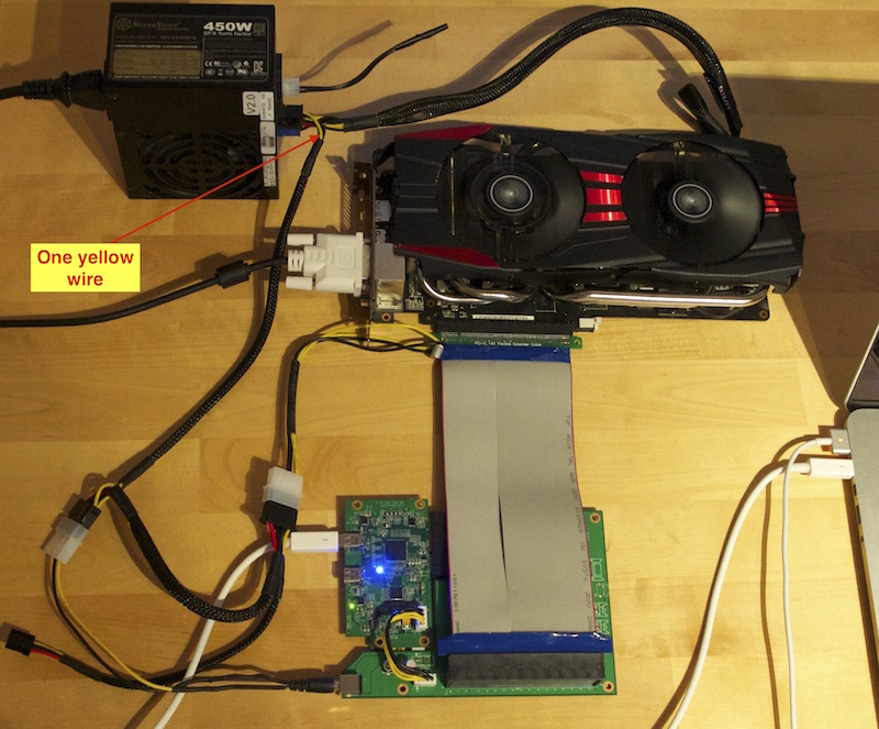

Oscar J Posted February 24, 2015 Share Posted February 24, 2015 Right. So where does the 4-pin molex attach then? I need an 8-pin to 4-pin molex cable? Does this look right? Adapter 2xMolex till 8-pin PCI-e - Inet.seIs it this 8-pin to 4-pin I'm going to make the molex-to-barrel adapter out of? Do I just use one of the 4-pin molex connectors, and throw away the 8-pin connector and the other 4-pin molex? Sorry if all these questions seem stupid. Quote Link to comment Share on other sites More sharing options...
Dschijn Posted February 24, 2015 Share Posted February 24, 2015 [MENTION=32203]Oscar J[/MENTION]: Well you already mentioned that you need 2x6-Pin PCIe power connectors for your graphics card. Before you consider any adapter for that card, you should find your PSU... If the PSU doesn't provide any of the required connectors you can start looking for adapters. Quote Link to comment Share on other sites More sharing options...
euqlaog Posted February 24, 2015 Share Posted February 24, 2015 8-pin to 2 x 4-pin molex cable is just my idea. I don’t know if this kind of cable exist, but in theory it would be the best way to feed up to 75W for the x16 slot (two yellow wires + two black wires) and ~20W for the TB card & PCIe board combo via molex-to-barrel adapter (one yellow + one black). You should have a multimeter to confirm correct voltages and polarity of the barrel adapter. It’s always a good idea to also confirm the output voltages of the PSU so that you don’t accidentally use +5V. We only need yellow +12V and black GROUND. This layout picture describes my current power configuration when using the powered riser + taping trick method. Feedback is welcome. R9 280X still has stability problems in 3DMark11 physics. I suspect that one yellow wire from the PSU’s 6-pin “IDE & SATA” connector is not enough. That’s why I suggested to use 8-pin output “EPS8-pin/ATX4PIN” but wonder where to get such a cable. Maybe I should make it myself. Quote Link to comment Share on other sites More sharing options...

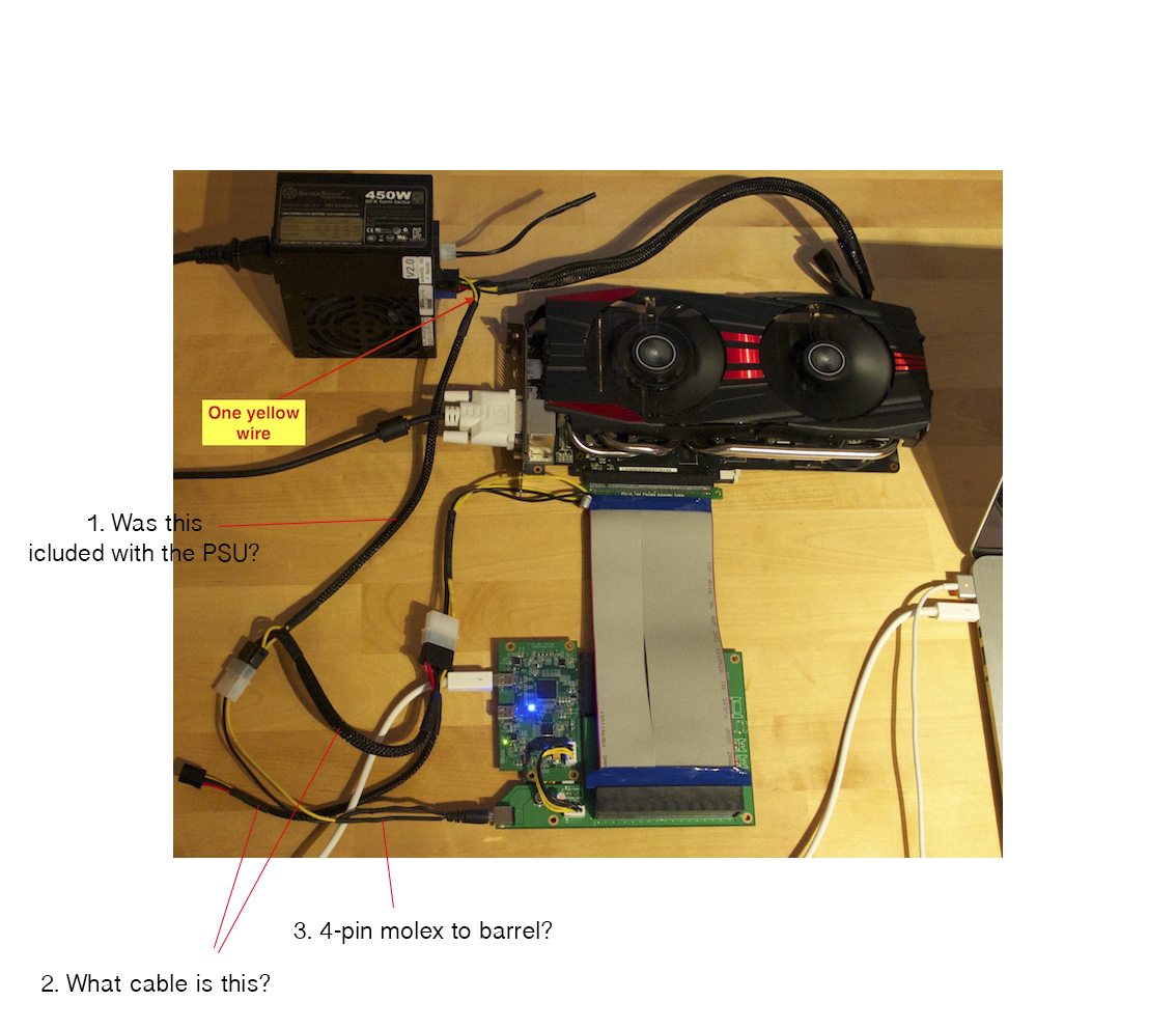

Oscar J Posted February 24, 2015 Share Posted February 24, 2015 That's a great and really helpful picture, but it leaves me with a few questions: By the way I just ordered the AKITIO Thunder2, so I guess it's happening! Thanks in advance. Quote Link to comment Share on other sites More sharing options...
euqlaog Posted February 24, 2015 Share Posted February 24, 2015 That's a great and really helpful picture, but it leaves me with a few questions:[ATTACH=CONFIG]14181[/ATTACH]By the way I just ordered the AKITIO Thunder2, so I guess it's happening!Thanks in advance.1) Yes, included with the PSU. The plug attached to the PSU is 6-pin but utilises only 4 pins (one yellow, two black, one red). At the other end it has two 4-pin peripheral connectors and one 4-pin floppy connector.2) It’s the same cable as (1)3) Yes, self-made. The wires near the barrel plug are too thin.SilverStone Technology Co., Ltd.- INTRODUCTION?ST45SF-G Quote Link to comment Share on other sites More sharing options...

Oscar J Posted February 24, 2015 Share Posted February 24, 2015 I have ordered that SilverStone PSU now. When you made the 4-pin-molex-to-barrel adapter, did you need to buy a 4pin molex extension like the one in the molex-to-barrel video guide, or was that also included with the PSU? Quote Link to comment Share on other sites More sharing options...

euqlaog Posted February 24, 2015 Share Posted February 24, 2015 I have ordered that SilverStone PSU now. When you made the 4-pin-molex-to-barrel adapter, did you need to buy a 4pin molex extension like the one in the molex-to-barrel video guide, or was that also included with the PSU?Great to hear! ST45SF-G is a very good PSU for DIY projects, the only drawback is the 8cm fan which might be the loudest component of your eGPU system. V2.0 has better fan speed curve.I had some old molex extension cables laying around. A connector that has male pins and female housing isn’t included with the PSU, if I remember right. Pins can be removed easely by pushing in the side wings, you just need yellow +12V and black Ground. Quote Link to comment Share on other sites More sharing options...
