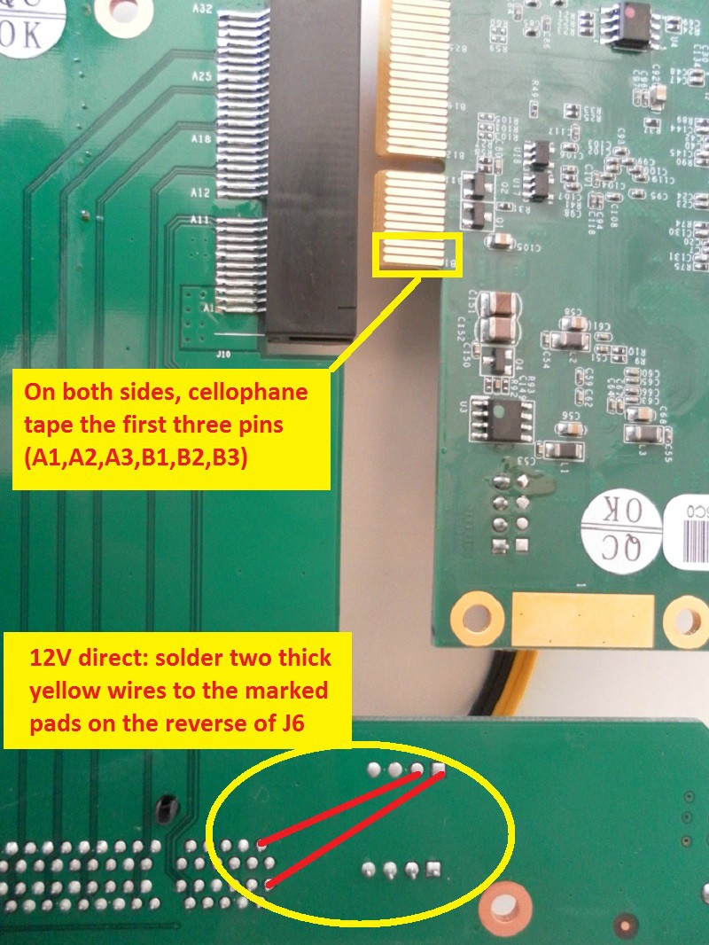

I soldered wires right to the PCB so I could connect a PSU right to the PCIE power lines going into GPU.

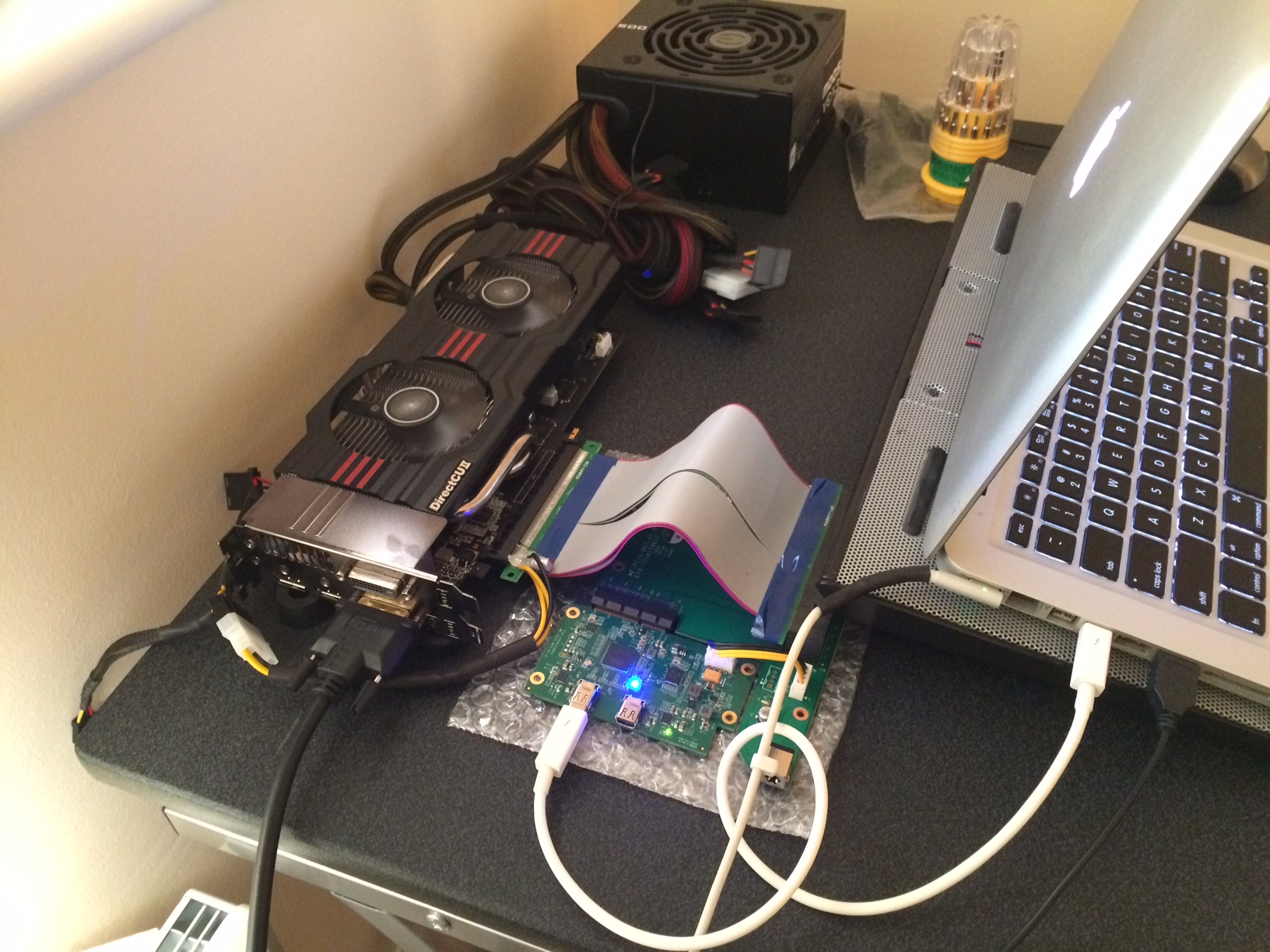

I am trying my first experience with an eGpu.
I've followed the guide here
My setup is:
- Macbook Pro 2011 13", i7, HD3000
- OS Yosemite
- Windows 8.1
- Akitio Thunder2
- Asus GTX660Ti
- EVGA 500W PSU
- pCIe X16 riser with molex
- Start option (jumper) for the PSU to start as soon as switched from the back switch
- Thunderbolt cable provided with Akitio
- DVI cable to external Benq monitor
I am using only the EVGA PSU and powering the Akitio through the molex
I have installed all the hardware following the guide.
Nothing connected to the Macbook so far.
I have made a clean installation of Windows 8.1 from the DVD using the superdrive and Boot Camp. Boot Camp did the hard drive partition and started the installation.
I have installed the Boot Camp tools/drivers.
I have then switched OFF my macbook
Connected the Thunderbolt to it and powered the EVGA PSU: The green light of the Akitio is ON, the GTX660Ti fans start to run, low speed.
I switch ON the MacBook pressing the Option button, when the macbook is ON, the blue led on the Akitio switches ON as well
Select my BOOTCAMP partition to start
The external monitor stays OFF, but also the internal switches OFF. The computer seems frozen, doesn't go anywhere and it doesn't respond to anything.
I have to switch it OFF by holding the power button for 5 seconds
A picture of the hardware setup

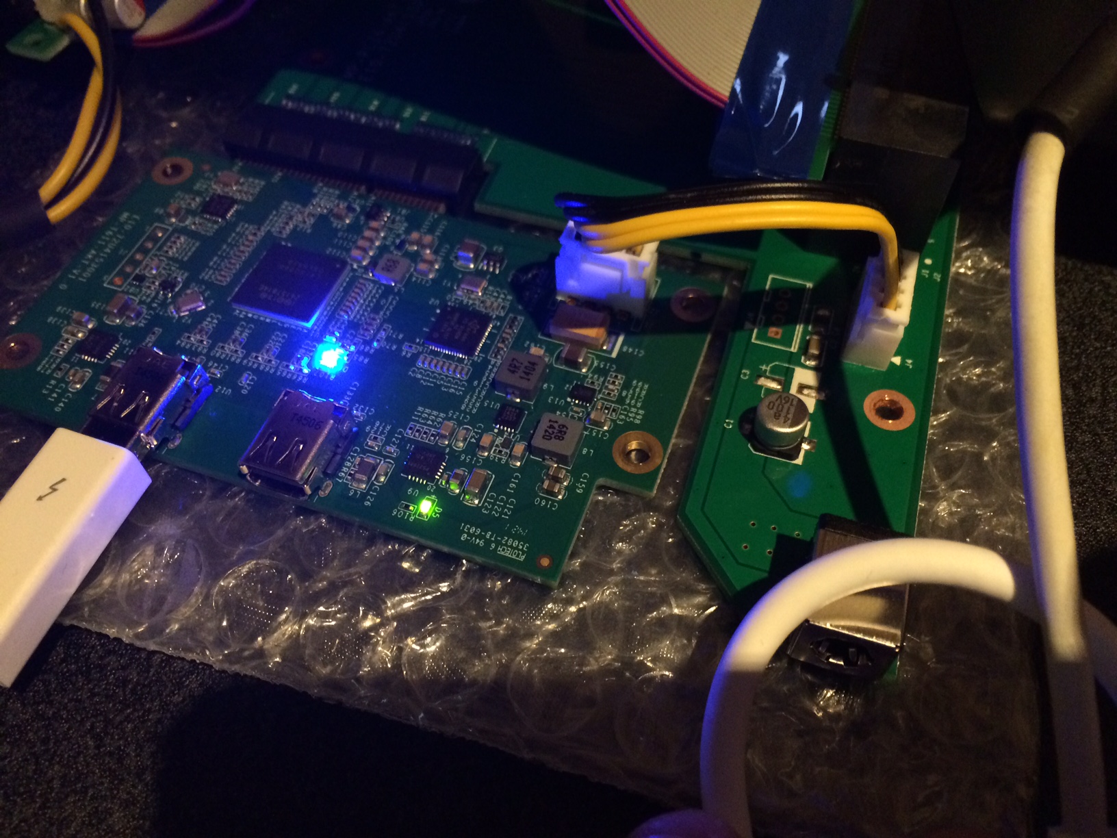

starting the computer with the EVGA PSU ON and the Thunderbolt connected, but the 4 wires (2 yellow and 2 black) cable on the Akitio connecting the Thunderbolt board with the pCIe board disconnected.
A picture of the cable:

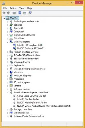

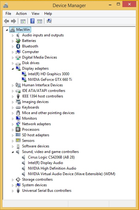

Magically Windows starts and my GPU is recognized, I can install the drivers, the external monitor works.
Even after installing the drivers etc, everything written before doesn't change, the only way it works is by the "4 wires cable" trick on startup, otherwise it either freezes or starts without GTX660Ti.

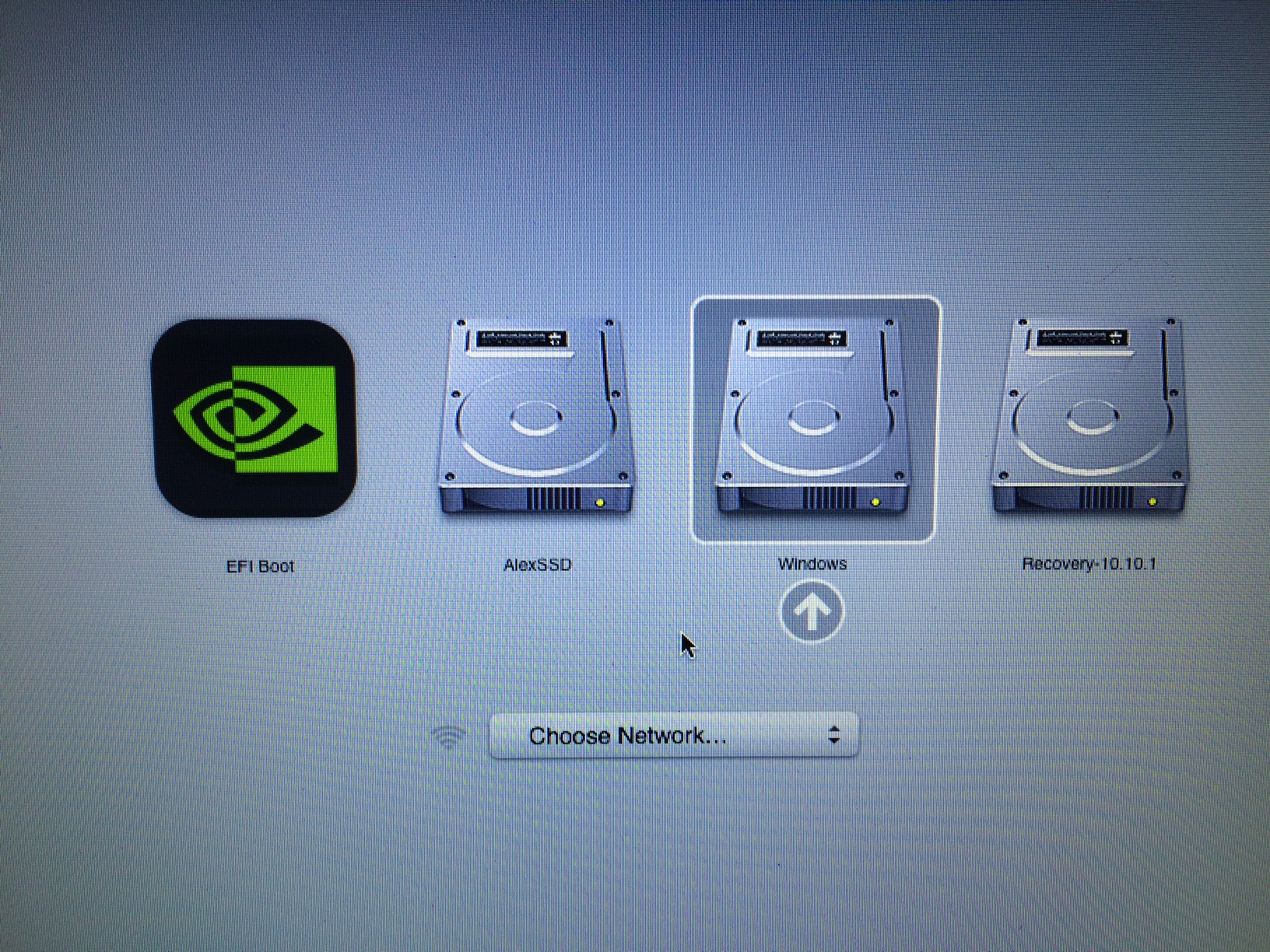

I get the EFI NVIDIA icon on startup, all good.

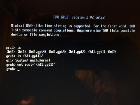

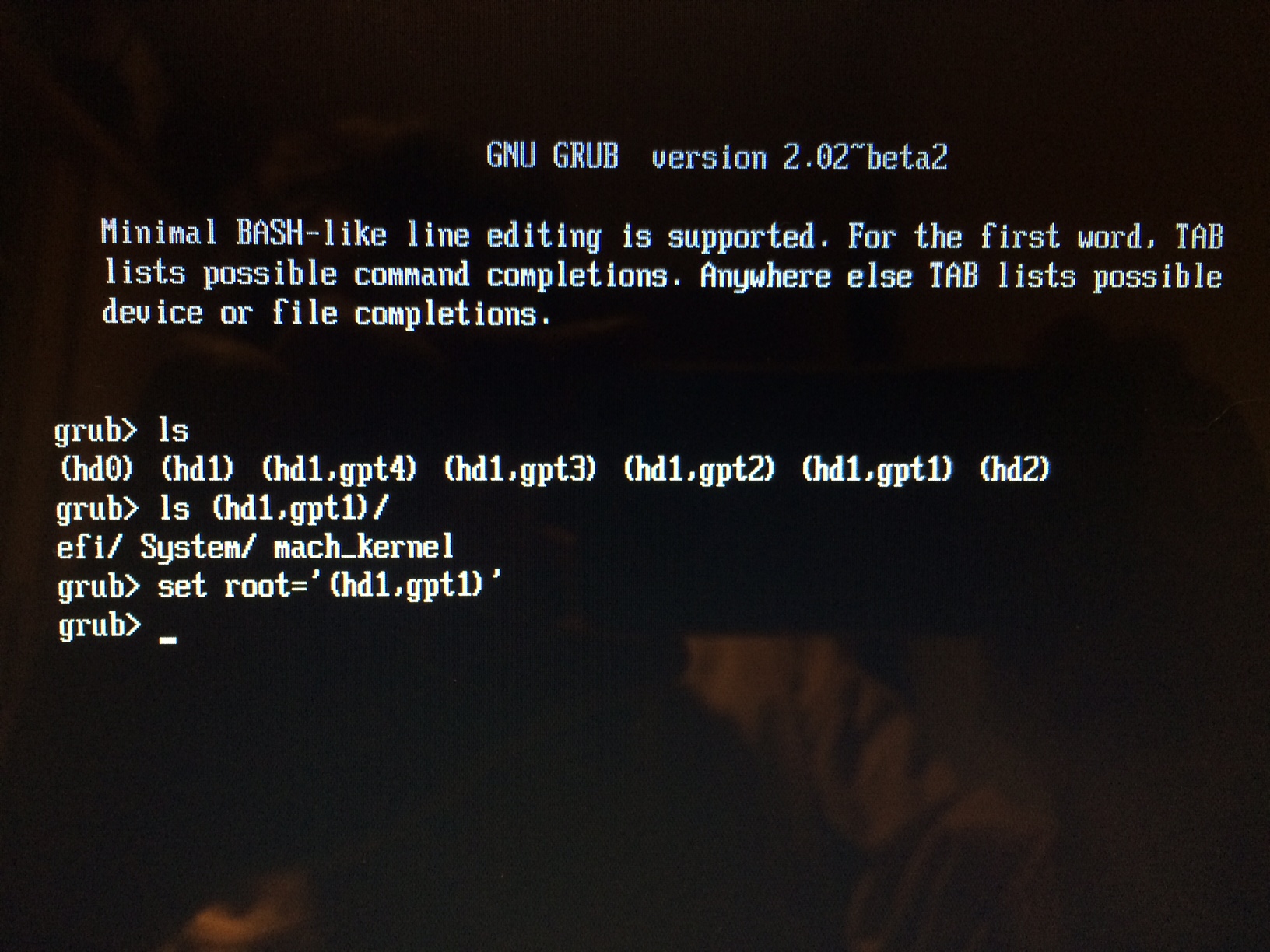

I click on the EFI Boot to start, I get the console
No matter if I do the procedure ("ls" etc etc) to declare the EFI partition, every time I try to start from EFI Boot it opens the console

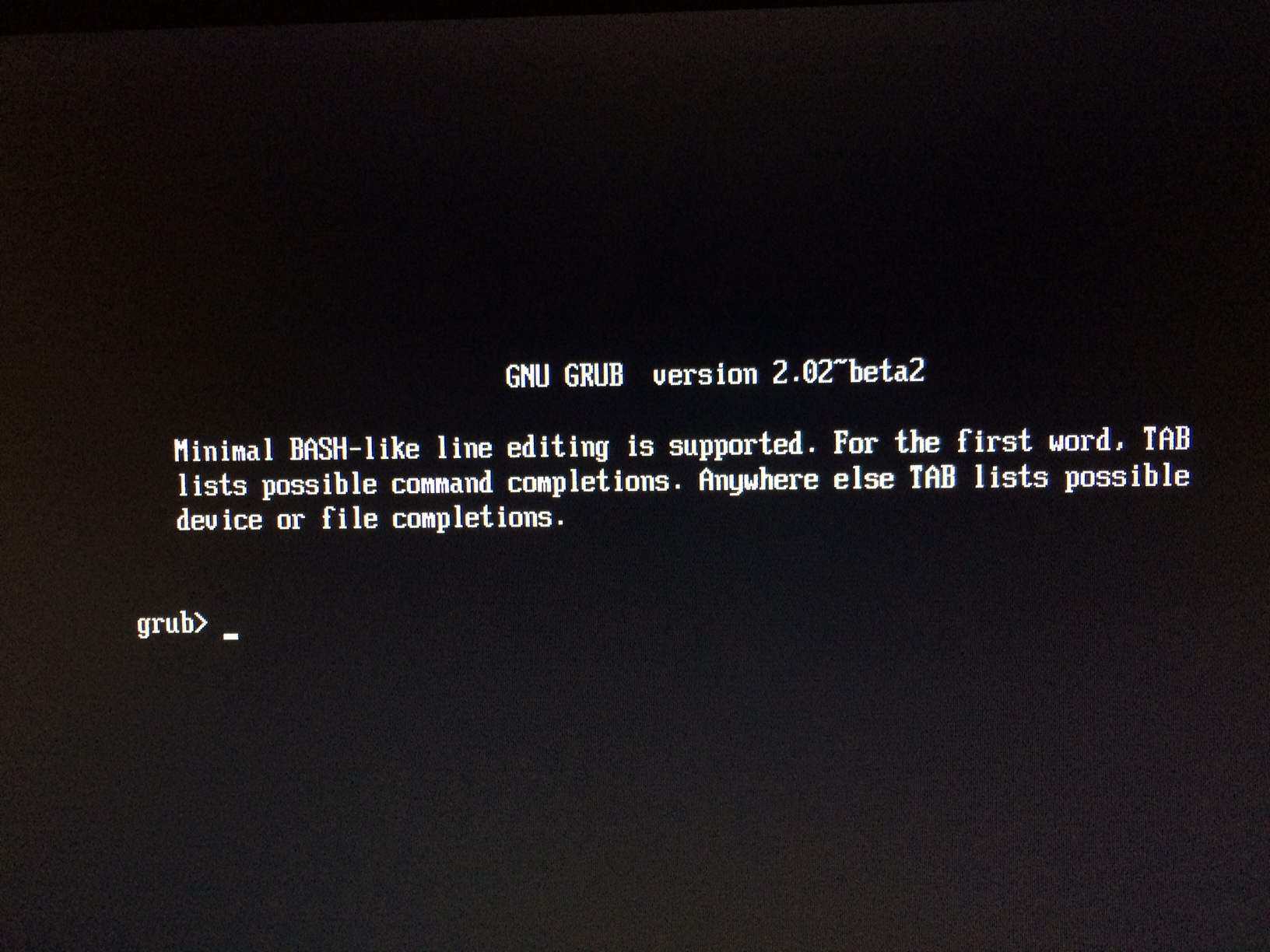

What happens if you boot from the "EFI Boot" Partition?
Hi Dschijn,
if I try to boot from "EFI Boot" it goes straight into the Grub 2 console (as in picture). I tried the procedure on the guide to declare the EFI partition on GRUB, but it still just goes on the console instead of starting Windows...

Hard to tell, because imo you did it right. You had the chance to install the Nvidia driver in Windows 8.1, right?
Can you try:
- to fix the GRUB problem? Step 6: http://forum.techinferno.com/implementation-guides/8558-%5Bguide%5D-macbook-enabling-optimus-internal-lcd-mode.html#post110757
- when you "boot" into Windows with the eGPU and all the screens are black, can you see anything happen on the MacBook screen during the first seconds? Like the Windows spinning circle? Sometime I boot into Windows and the external display is "grey'ish" (not crashed). So apply the following steps without any visable interface: I can press any button 1x, enter my password and can go into windows.

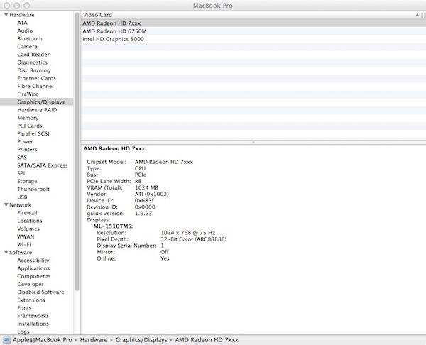

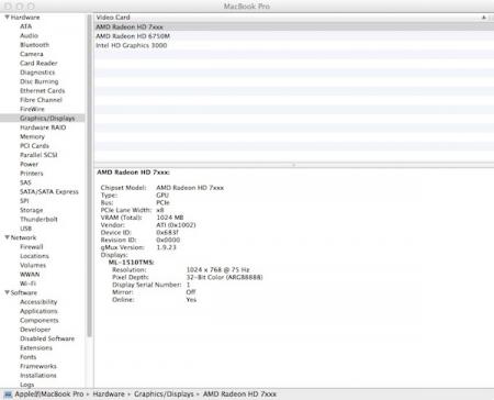

I found a screenshot for you:

I must have hit all the bad combinations... I am hoping with some help here I can get it sorted, even without Optimus at least that it works without haing to pug a connector every time...
Tried again that... no success

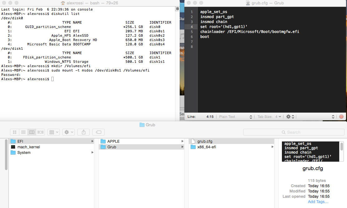

this is the configuration I have on GRUB when I start the system and I select "EFI Boot"
And this is how I configure the grub.cfg inside the EFI partition

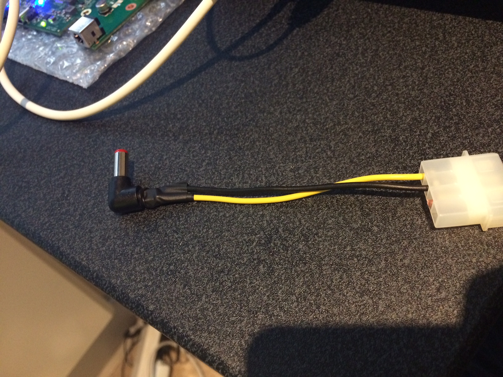

If you don't want to use it's power supply, you can rig it to the EVGA PSU.
Good idea, I tried this as well just now. Bad news is it didn't fix the issue :( It still freezes
This is the cable I made

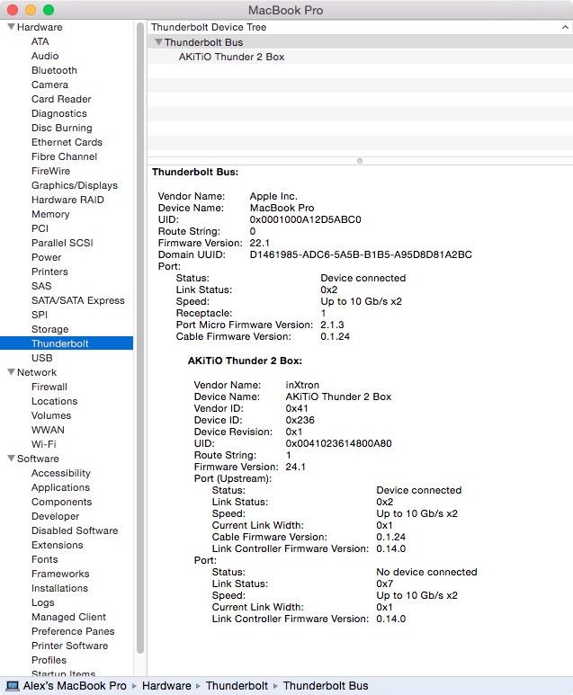

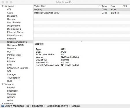

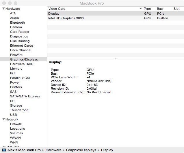

THough it doesn't see the GTX660Ti on OSX, it does see the Akitio correctly, here is from the system info

@Ramses82: Have you tried to type “quit” or “exit” (at least twice) when you are stuck at GRUB console? For me that worked and continues booting if I get the console screen (maybe because of the external USB SSD).
Good call!!! "quit" didn't work, but "exit" did. Same as before, I have to leave the yelloe/black Akitio cable unplugged and plug it back just when I press "ENTER" after exiting.

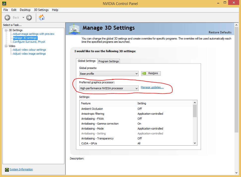

Tried then to run windows normally, selected nvidia for all the applications by default and the hardware acceleration is working on the built-in screen! Does it mean we've got it working? :D
I hope it is going to work, I have ordered a single double pole single throw switch, I will put together the 2 yellow and the 2 black wires and use the switch to do the "plug" trick before I ruin the contactor... in theory the 2 yellow and the 2 black wires are the same in parallel, they both measure 12V when powered and I tried when unpowered to check for continuity between the 2 yellow and between the 2 black and the multimeter says there is continuity... fingers crossed.
Here is the configuration on the nvidia settings

I can get Yosemite to see there is an Nvidia card now, no need to do yello/black cable pull on macos, as before.
BUt still from the Nvidia settings the option to select that card is greyed out... I can't chose it. Like it really doesn't see the card.

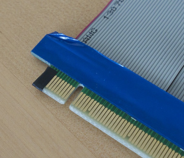

The purpose of the 4-pin cable is to share +12V current between the Thunderbolt controller and PCIe board. The direction of the power flow can be either from the powered riser or from the DC jack / J4. The PCIe board needs only ~9W-10W:
http://forum.techinferno.com/diy-e-gpu-projects/8844-targeting-akitio-thunder2-pcie-boxs-stability-issues-3.html#post121721
Be very careful, avoid ground loops, double check the correct voltage and polarity. Some tips:
- The 4-pin wires can be released by pushing the side wings with a sharp tool
- You can modify a floppy drive plug with a knife. The best would be a plug that AKiTiO uses, but I haven’t found similar.
I'll try to put a switch on that, I would be fine with switching it every time I turn on the computer, as soon as the trick works and it doesn't compromise the hardware.
Another thing that I was thinking about doing is taking another +12V and GND from a molex of the PSU and provide it straight to that pin as well on top of the already powered riser... that should bypass any diode or other circuits that may restrict the current capacity down to that part of the board... I'll see what I can do, if just the switch trick works I'll stick only to tha
Some kexts are not loaded.
1) Check that you are running OS X 10.10.2 (14C109)
2) Check that “grep IOPCITunnelCompatible /var/log/system.log” does not output anything. If it does, you haven’t correctly modified the kexts. I am not certain if your GPU is supported, but examining the system log will often help.
Thanks for this, it must be it... I am quite happy at the end that the thing works at least on Win, I do play games only on that at the end... but I'll give it another go when I've completed the Windows configuration ;)

INFO: passing 75W slot power without a PCIe riser
I've been working with a user who get PCIe signal instability when using a PCIe riser, but gets power instability without it. So how can 75W power be routed directly to the PCIe board of the Thunder2, eliminating the need for a Gen2 signal degrading riser? The following process done successfully by goalque, resulting in a fully stable AMD eGPU implementation. Details at http://forum.techinferno.com/enclosures-adapters/7205-us%24189-akitio-thunder2-pcie-box-16gbps-tb2-101.html#post124478 .
Two other positive side effect of doing this are:
1. the yellow/black J4 cable rated at 22AWG and the Thunderbolt board itself would no longer be overdriven past it's specced 25W.
2. Users who have or are choosing a powered PCIe riser instead of above soldering could also benefit from the cellophane tape isolating of the first 3 pins on both sides as shown in (1) below or even easier by doing the same on the PCIe riser itself as shown in the spoiler. That then separating their two different 12V inputs (12V_ATX and 12V_filtered) to increase stability.
Spoiler
How is power routed to the PCIe slot?
Some continuity tests with a PCIe slot schematic referring to slot pins as Ax, By where done with reference to the J4 12V-Yellow and GND-Black wires, finding:
* 12V (B1, B2, B3, A2, A3) are NOT wired directly to 12V-yellow. They go via the Thunderbolt board providing filtered_12V input specced at 25W (max)
* GND (A4, B4, B7) are wired to the BLACK so there is a common ground
How can we bypass the 25W (max) input board limit and pass 75W to the slot directly?
We also know from http://forum.techinferno.com/enclosures-adapters/8848-%24299-owc-mercury-helios-16gbps-tb2-discussion.html#post121898, using a nearly identical internal board, that the input DC barrel plug and lines to J4/J6 have been specced to accept up to 120W input power -> 75W fits easily within spec.
So then if you have a clean input 12V from say a ATX PSU via the DC barrel jack, the simplest solution to provide dedicated 75W to the slot while continuing to providing the filtered_12V input to the TB board is as follows, shown pictorially below:
1. disconnect the x4 board and use cellophane tape to isolate the filtered_12V pins A2, A3, B1, B2, B3. Perform continuity tests to ensure this was done correctly.
2. 12V_direct: solder two 18AWG yellow wires from the J6 (yellow pads) to A1 and B2. 18AWG is what your PCIe power leads use. These are wired to pins A2, A3 and B1 by the slot. J6 mirrors J4, which in turn is attached to the DC barrel connector and is a more convenient solder point than J4 since it can be more easily reversed without obvious tampering. A1 and B2 were chosen as the most convenient solder points to attach to.
Is there anything I can do to increase power stability?
Yes, solder in the missing C3 (100UF/16V) and C4 (10uF/25V) capacitors as is provided by the higher-rated but nearly identical 120W OWC Mercury Helios product to provide some additional smoothing/filtering of the 12V_ATX input power to the slot. See http://forum.techinferno.com/enclosures-adapters/8848-%24299-owc-mercury-helios-16gbps-tb2-discussion.html#post121898
