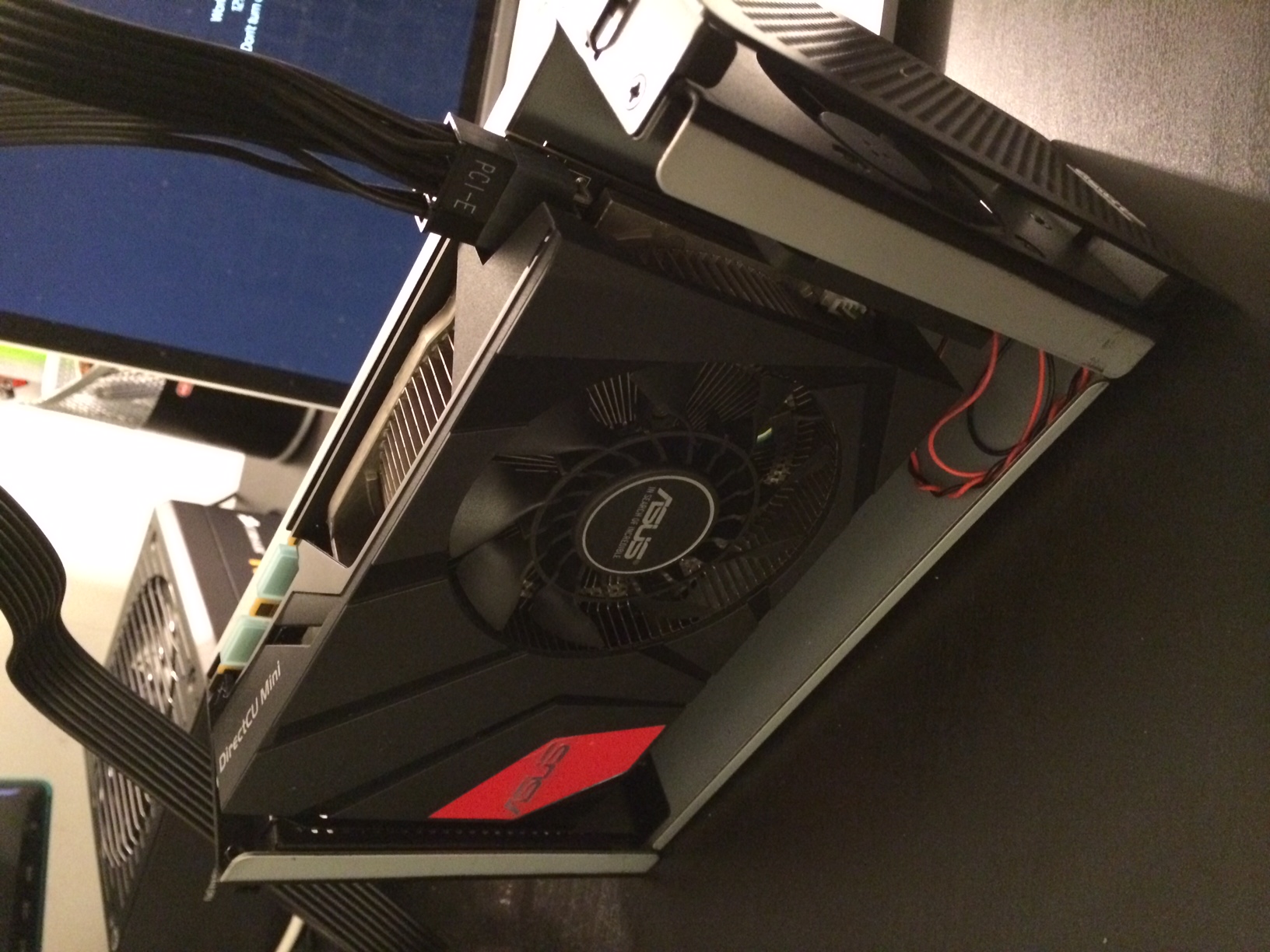

I have a ASUS GTX 970 MINI, corsair rm 450, akitio thunder 2 and an external monitor. I plugged the card into the akitiobox directly and powered the card with the corsair power supply. Then I connect the card to an external monitor using hdmi cables and applied paperclip trick. When i start in windows, both the fan of the power supply and the card runs, but the card does not get recognized under device manager. The only thing under graphic adapter is the gt750m from my mbp.
I tried infall driver but the card still can't get recognized.
Any help plz?

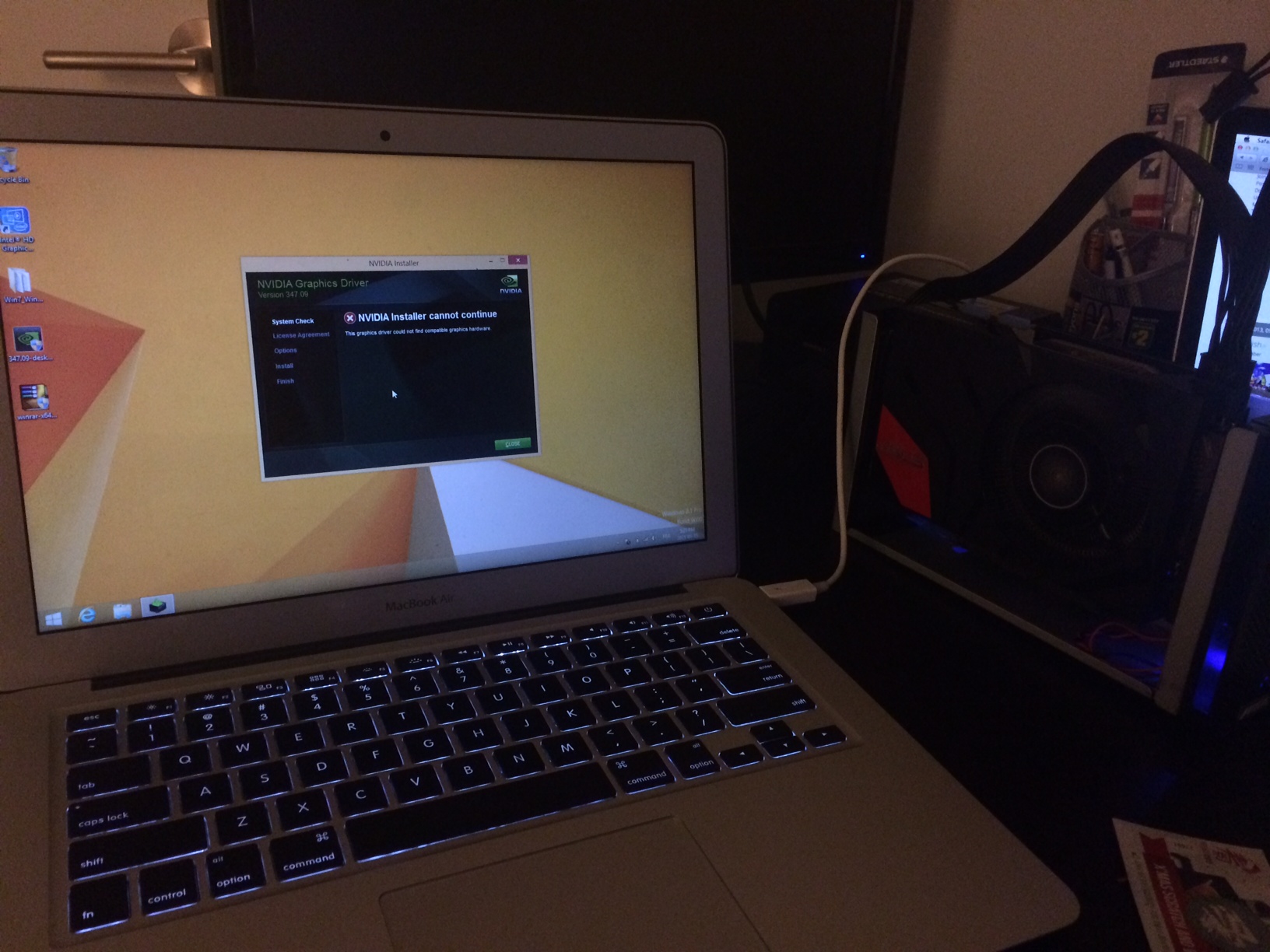

After several attempt with my set up, I still couldn't get my my egpu to work. The card can not get recognized. I tried it on both of my macbook pro(late 2013 with dgpu) and mac air (with intel graphics only) both under win 8.1. The fan on the card spins but can not see under device manager. Also i can not install nvidia driver it says"the driver can not find compatible hardware". Any suggestions to how to get the card detected?
I tried restart several times it did not work.
Could you please open a new thread? It is quiet hard to follow / help you if we need to search for your informations (setup) everytime.

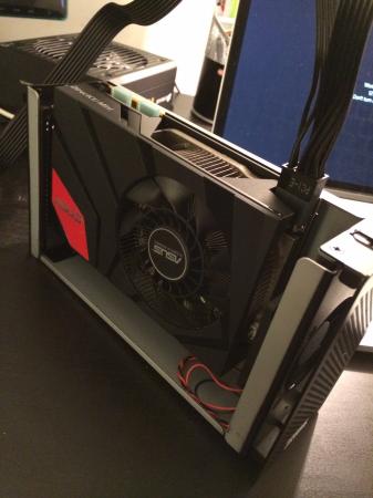

My set up:
MBP retina late 2013 with gt750m dgpu /macbook air 2012
Akitio Thunder 2 Box
Asus GTX 970 MINI OC
Corsair RM 450 ATX PSU
external monitor

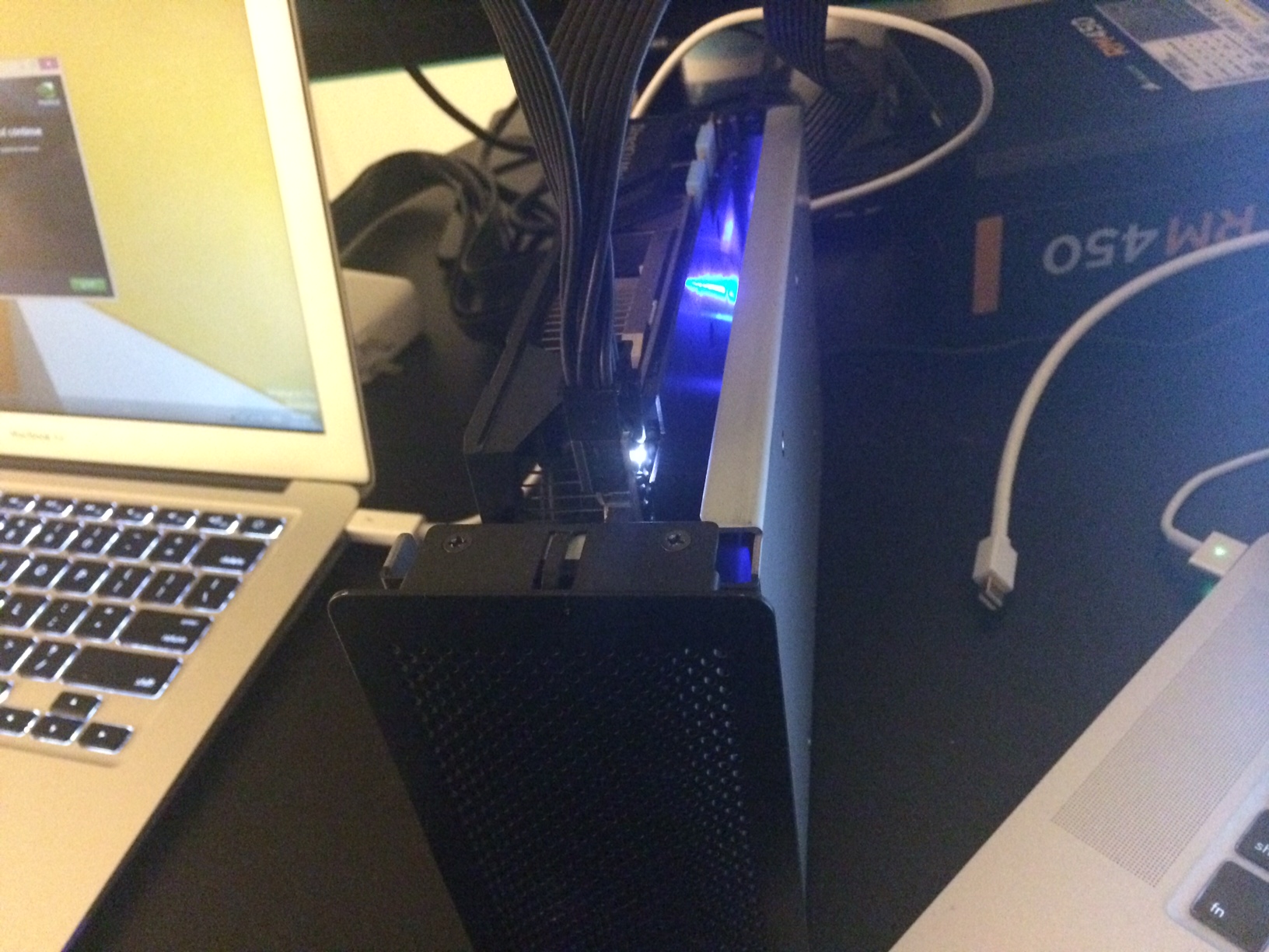

I connected the card directly into the akitio box, plugged the 8 pin power supply to the gpu and connected the akitio box to a my macbook pro via thunderbolt. I also applied the paperclip trick and connected an external monitor to the card using hdmi.
Problem: I tried this set up with both of my rmbp and mba, i can boot win 8.1 with the egpu card running. The fans on the egpu runs but it is not detected. I also can not install nvidia drivers since it says "the driver could not find compatible hardware".
I tried restarting several times, the card is not detected but the gpu fan is spinning. This is really frustrating its been 2 days and no progresses have been made.
Appreciate any help thx!
The AKiTiO PSU was connected?

yes i tried ur steps, still didn't get the card recognized. Sometimes the fans on the card suddenly stops spinning i have to unplug and replug. However, it has never got detected by windows. Im thinking maybe i have a bad thunderbolt line or my windows edition have problems. I don't know if the windows I'm using is the pure version from microsoft. I downloaded it from dreamspark. Thx for the help anyway.
