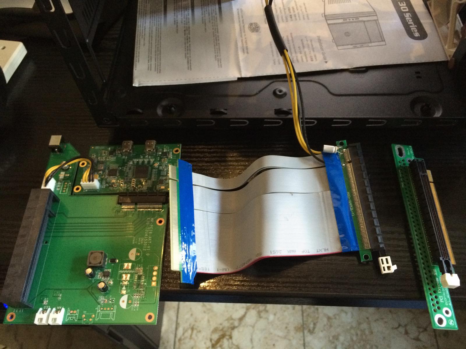

Shadow_Bullet Posted December 1, 2014 Share Posted December 1, 2014 Thanks! Did you do any research on this and picked this one by any special reason? Did you cut any lines of the riser to prevend powering the AKiTiO?Could you post pics without riser and just the card in the Akitio? Quote Link to comment Share on other sites More sharing options...

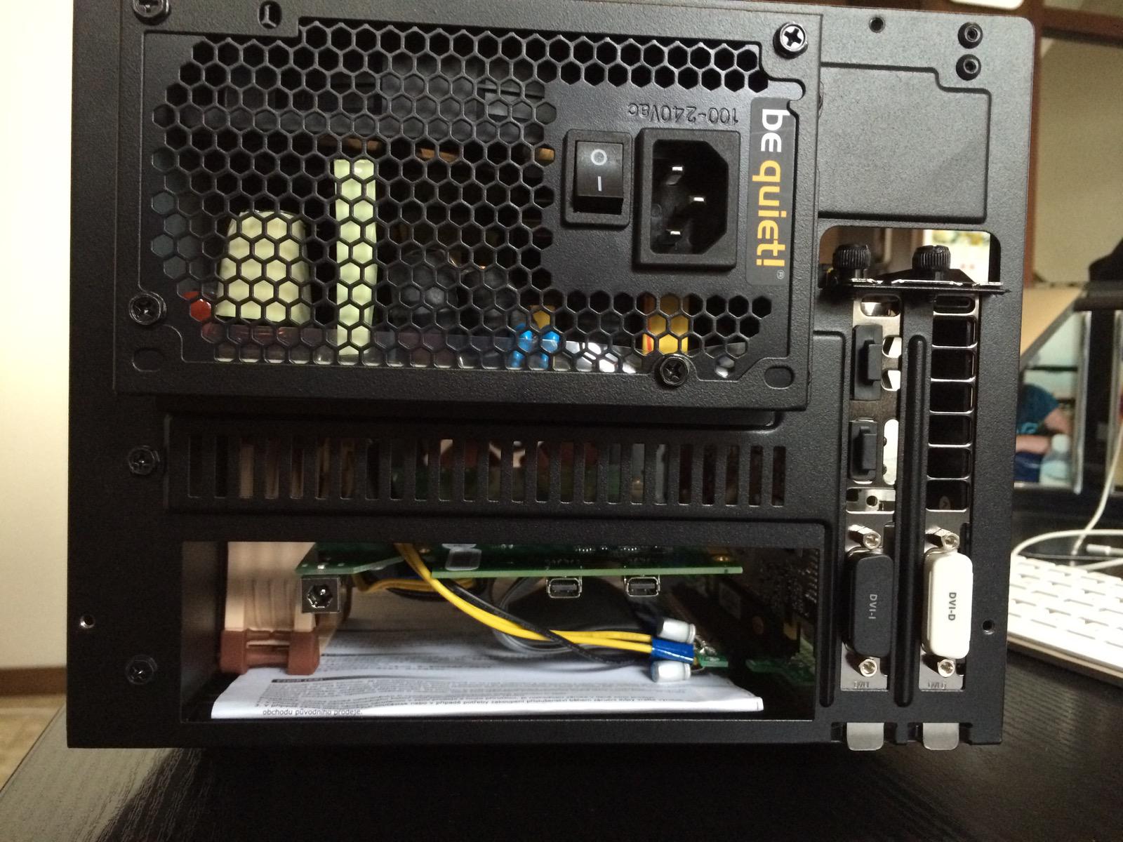

Shadow_Bullet Posted December 1, 2014 Share Posted December 1, 2014 Tested my AKiTiO rig today:MBPr late 2013, 13", 8GB, i5AKiTiO Thunder2, MSI GTX 970, be quiet! 500W, no riser!Followed goalques guide and have it running under Windows 8.1: http://forum.techinferno.com/diy-e-gpu-projects/7580-%5Bguide%5D-2014-15-macbook-pro-iris-gtx780%4016gbps-tb2-akitio-thunder2-win8-1-a.htmlBenchmarks (compared to my desktop rig, both external monitor):MacBook vs. Hackintosh3dMark - Fire Strike: 9763 vs. 12367 (Graphics Score) - 78,9% of desktop performanceUnigine Valley - ExtremeHD: 1232 vs. 2274 (Score) - 54,2% of desktop performanceWhat I don't like:- AKiTiO PSU and board are noisy (electric noise)- MSI GTX 970 was noisy in my desktop system as well (electric noise)Will do more benchmarks (any wishes?) and will try a powered riser.Could you post pictures of your setup? Quote Link to comment Share on other sites More sharing options...
Dschijn Posted December 1, 2014 Share Posted December 1, 2014 Here you go: 1 Quote Link to comment Share on other sites More sharing options...

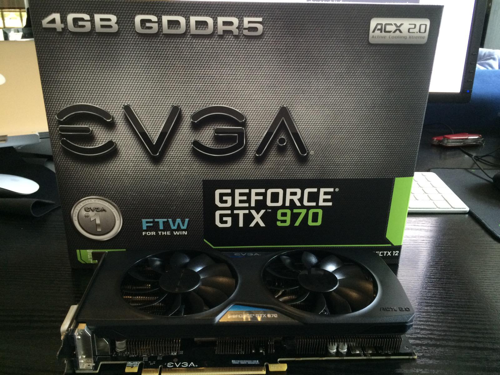

Shadow_Bullet Posted December 2, 2014 Share Posted December 2, 2014 Okay so I have changed my mind I am deciding to go with a Gigabyte ITX GTX 970 so that I am able to completely fit it in the enclosure with it sealed. I just need to order the card, Akitio, TB cable, and PSU. Let me know if any of you have used the new Gigabyte card because I am still undecided on what card I would like to use. I don't want to use a riser however for portability purposes. Quote Link to comment Share on other sites More sharing options...

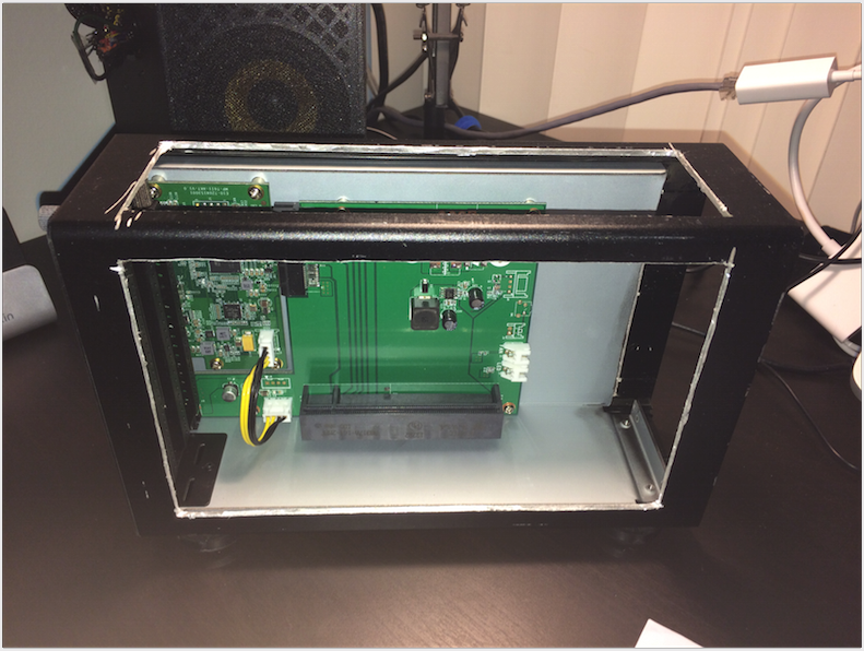

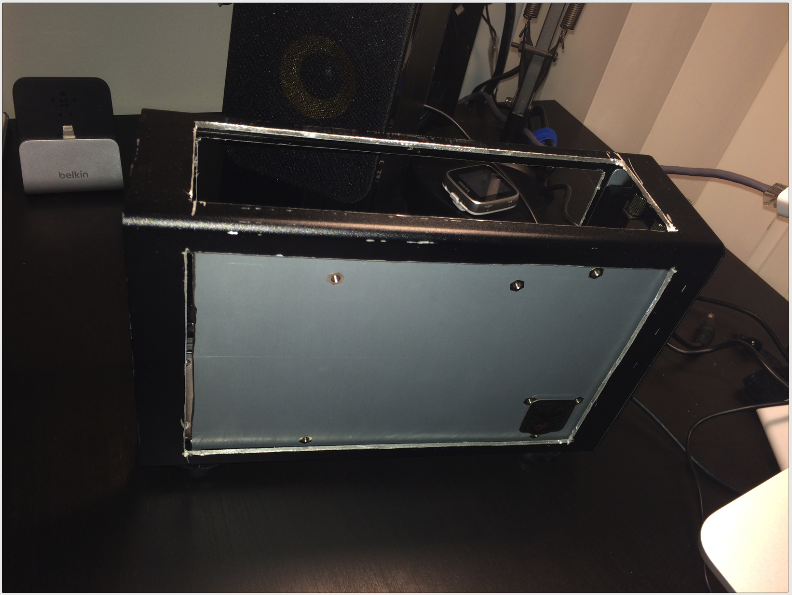

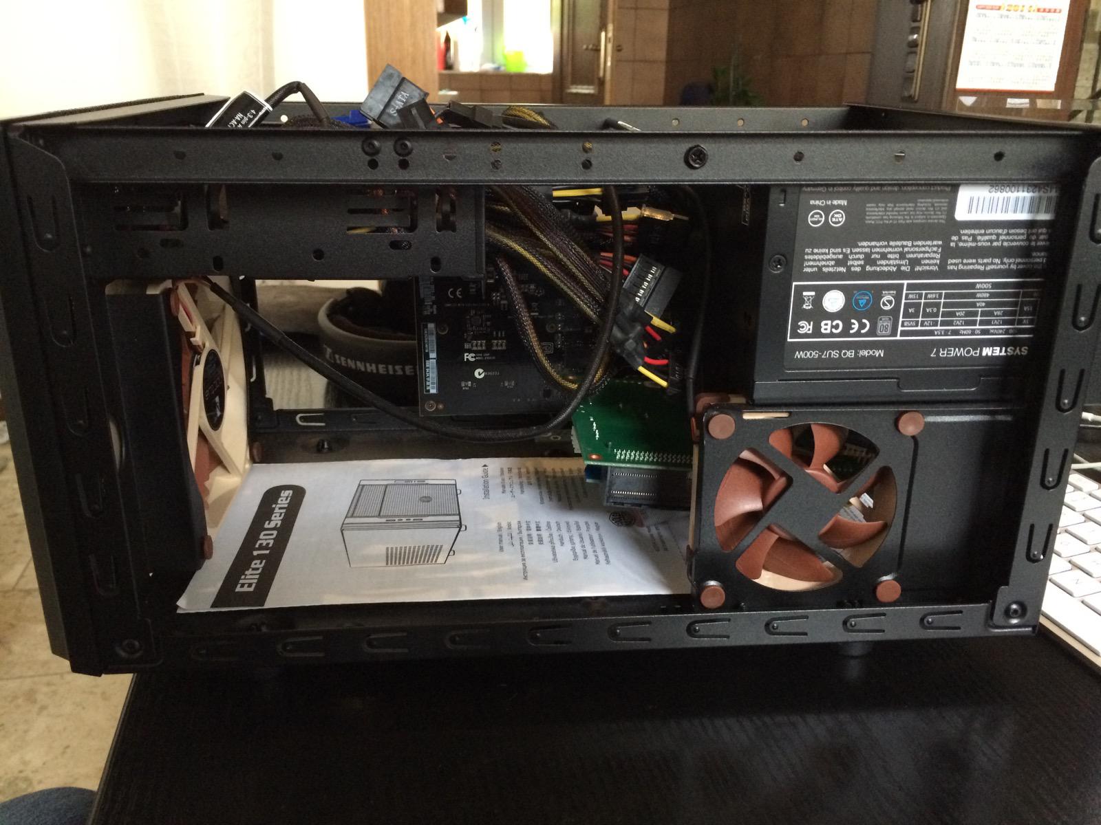

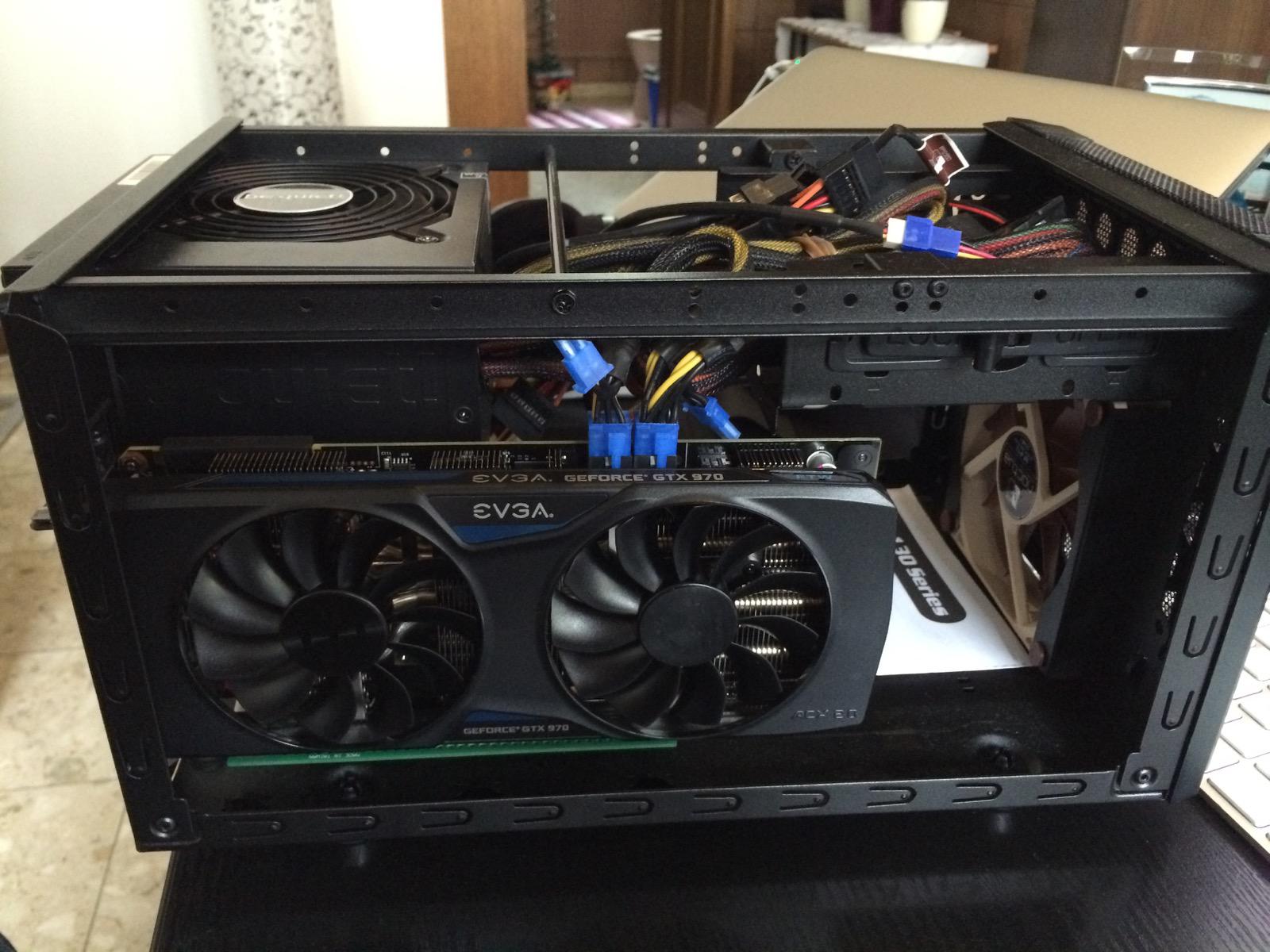

Shadow_Bullet Posted December 2, 2014 Share Posted December 2, 2014 RE: http://forum.techinferno.com/implementation-guides/8030-%5Bguide%5D-2013-15-macbook-pro-gt750m-gtx780%4016gbps-tb2-akitio-thunder2-win8-1-a.html#post109807 [ATTACH=CONFIG]12846[/ATTACH] [ATTACH=CONFIG]12847[/ATTACH] [ATTACH=CONFIG]12845[/ATTACH]Late 2013 15" Macbook Pro GT750M + GTX780@16Gbps-TB2 (AKiTiO Thunder2 without riser) AKiTiO Thunder2 is not big enough for ]GTX 780 get in. So I bent the box of AKiTiO TB2 Anyone knows how to disable GT 750M? I cannot use eGUP in the inner screen. Do I need to modify the EFi? And in the Win8.1, Iris Pro is disabled, I cannot use inner screen with GTX 780. Using OSX 10.9.5. Thanks Is there a way that you can take off the part that you bent like with a screwdriver? Quote Link to comment Share on other sites More sharing options...

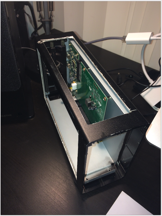

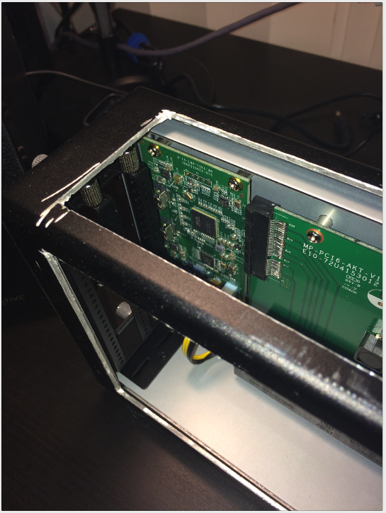

Dschijn Posted December 2, 2014 Share Posted December 2, 2014 Is there a way that you can take off the part that you bent like with a screwdriver?No. The case is in that shape. You can only unsrew the PCB from the case and use it without the case at all. Quote Link to comment Share on other sites More sharing options...
Shadow_Bullet Posted December 2, 2014 Share Posted December 2, 2014 Okay then I will probably stick with the same card that I had originally intended to use the EVGA GTX 970 SC and just bend the enclosure.- - - Updated - - - @Tech Inferno Fan Is there any more photos of an EVGA card in the enclosure with it bent that you can find?- - - Updated - - - Quote Link to comment Share on other sites More sharing options...
Tech Inferno Fan Posted December 2, 2014 Author Share Posted December 2, 2014 @Tech Inferno Fan Is there any more photos of an EVGA card in the enclosure with it bent that you can find? There's a EVGA GTX770 at http://forum.techinferno.com/implementation-guides/7598-%5Bguide%5D-2012-mac-mini-gtx770%4010gbps-tb1-akitio-thunder2-osx10-9-4-a.html#post104243 . Though that post is a bit unusual. If you look carefully you'll see a 9.5" GTX760 and a 10.5" GTX770 in there. I've made a note of it. EVGA's GTX970's are 9.5" with the pcie power connector about 3/4 way across so would be awkwardly placed beneath the AKiTiO top cover if using it that way. EVGA's GTX980 are 10.5" so would get the same ease of access to pcie power as the above linked EVGA GTX770. Problem is the GTX980's are pricey. Only other GTX970 card that is 111mm tall, 10.5" long, PCIe connectors on the far left and is available in the US is the reference GTX970: NVIDIA GeForce GTX 970 4GB GDDR5 PCI Express 3.0 Graphics Card Silver 9001G4012510000 - Best Buy . Though it's not going to get a high binned ASIC that can be greatly overclocked. I did find a 111mm, 10.5" Gainward GTX970 in the Chinese market. Has a backplate too and runs a 1266Mhz boost clock. This would be perfect for use with a bent AKiTiO. °üÓÊ˳·á ¸ûÉý GTX970 ÕÔÔÆ°æ 4GD5 ÃëGTX780·ÇÓÎÏ·ÖÁ×ð°æ OC°æ-ÌÔ±¦Íø. Don't seem to see them in on any Western sites Quote Link to comment Share on other sites More sharing options...

328115208 Posted December 6, 2014 Share Posted December 6, 2014 RE: http://forum.techinferno.com/implementation-guides/8030-%5Bguide%5D-2013-15-macbook-pro-gt750m-gtx780%4016gbps-tb2-akitio-thunder2-win8-1-a.html#post109807Is there a way that you can take off the part that you bent like with a screwdriver? The screwdriver can not take off the part, u will need Dremel 4200. Take a look of what it looks like now. 2 Quote Link to comment Share on other sites More sharing options...

jacobsson Posted December 6, 2014 Share Posted December 6, 2014 @328115208Holy shit dude, nice work!Are you planning to put in some guard mesh or just leave it naked? =) Quote Link to comment Share on other sites More sharing options...
328115208 Posted December 7, 2014 Share Posted December 7, 2014 @328115208Holy shit dude, nice work! Are you planning to put in some guard mesh or just leave it naked? =) Ha ha, naked AkiTion is fine to me, it will look more technical Quote Link to comment Share on other sites More sharing options...
