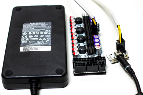

I am stuck on whether to get a macbook pro 15" and build an akitio egpu, or wait for thunderbolt 3 which will be late 2015...
But if I were to build an akitio egpu, I would try to fit a gtx 970 and the power supply all within the akitio chassis. I am not sure if this has been discussed before. This company called HDplex sells a miniature 250 watt modular power supply module. It requires the use of a 240 watt dell/alienware ac adapter brick. The HDplex module has 2 connectors for 6/8 pin for pci-e. There is an additional 4 pin that can be used for sata or molex, so a molex to barrel plug can be used to power the akitio box. If using the mini-itx gigabyte gtx 970, it looks like this power supply could be made to fit inside the akitio chassis as well. There would be some drilling involved for the screw mounts. Has anyone tried this?
The Akitio chassis is small and can't fit anything more than a GFX card (a mini one at that).
