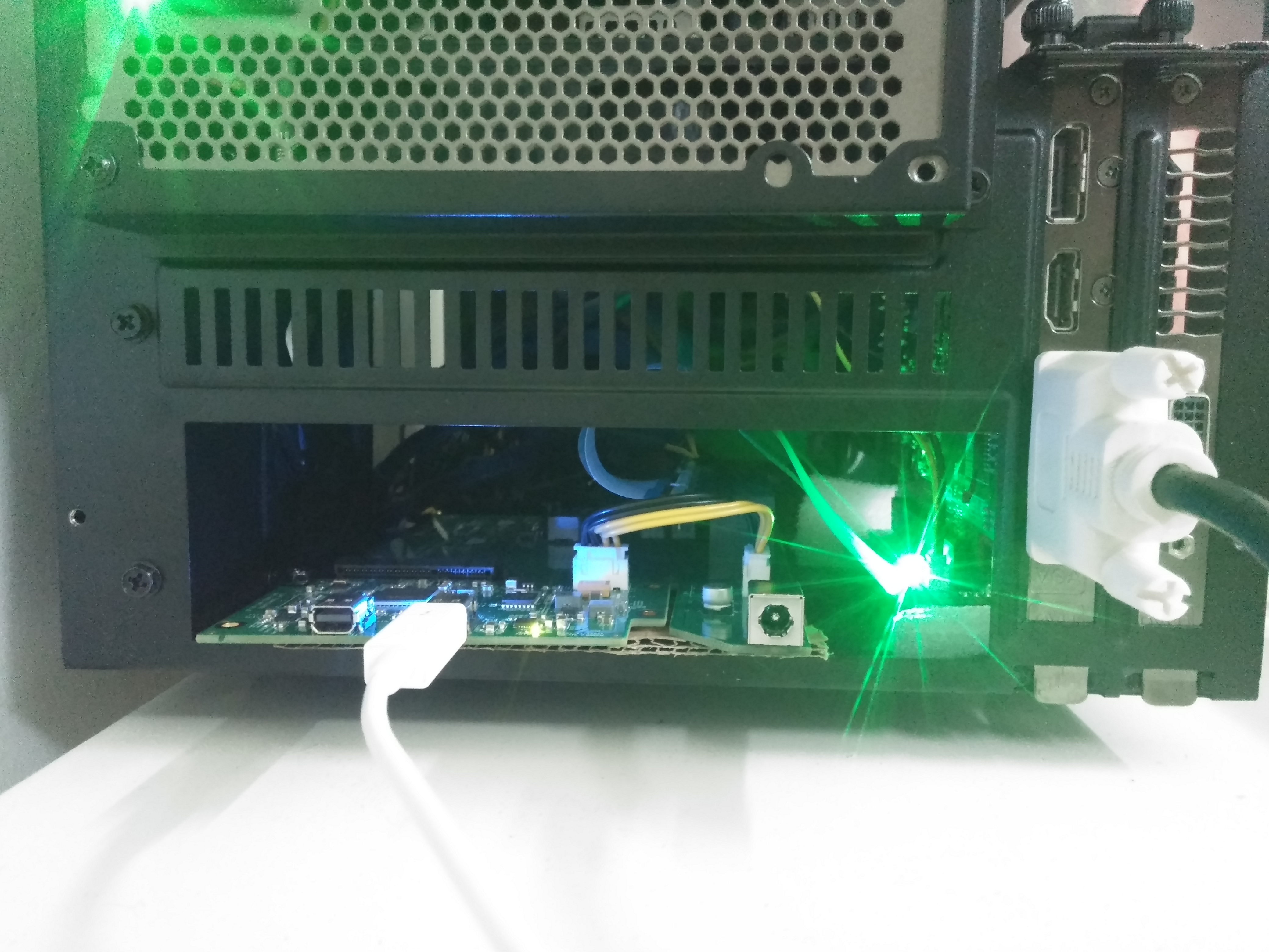

Will do! I'm thinking in the same lines of re-using the AKiTiO Thunder2 enclosure but there are a few issues with this approach:
  • Very limited room to fit extra cables/molex adapters
  • Not tall enough to accomodate PCIe 6/8pin connections to the GPU (1-2 mm above the inner metal bracket)
  • Inadequate ventilation - the outer case has to be drilled to provide ventilation otherwise air flow is constrained by the small stock fan and the circular cutout on the inner case (it could still be fine for Maxwell cards but other GPUs may overheat)
  • Mid-size GPUs can fit on the inner case provided that the fan is removed/mounted outside or by bending/cutting the front bracket like (but then the outer case will be too short to enclose the GPU)
All of these problems can be solved by replacing the outer case/cover with one both longer (2+ cm) and taller (1-2 cm), with a vent on the GPU side. The original end plates could be replaced by custom ones to close the gaps and maybe provide extra functionality (i.e. separate barrel connector for a Dell DA-2/other PSU, power switch, fan and LED mounts).
They can also be fixed by not using the outer enclosure altogether :) That's my plan at least. I'll just use the outer enclosure for protecting the GPU while transporting it, since it slides in very easily, even with the slightly bent back plate to accommodate GPU length.

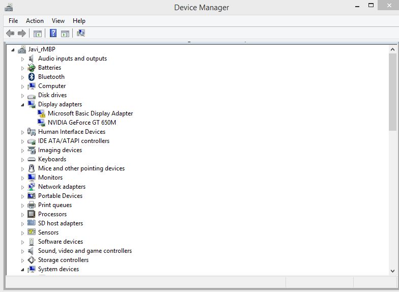

Hello everyone,
I´ve failed with my implementation. I´ve tried with these components:
Macbookpro retina 15" early 2013 with geforce 650m
MSI Geforce 970 gaming
Akitio Thunder2
Corsair cx600m PSU
Powered raiser
The thing is that Windows 8.1 recognize the card as a default video card. Seems like it doesn´t find an appropiate driver.
And in OS, after installing Cuda, adding the lines to the 3 kext files and reseting the caches, it crashes at the beginning.
I don´t know if it is possible to do something else.
Can anyone throw some light here.
Thank you very much.

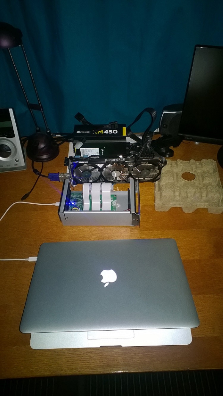

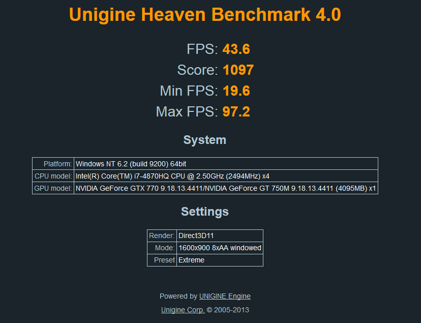

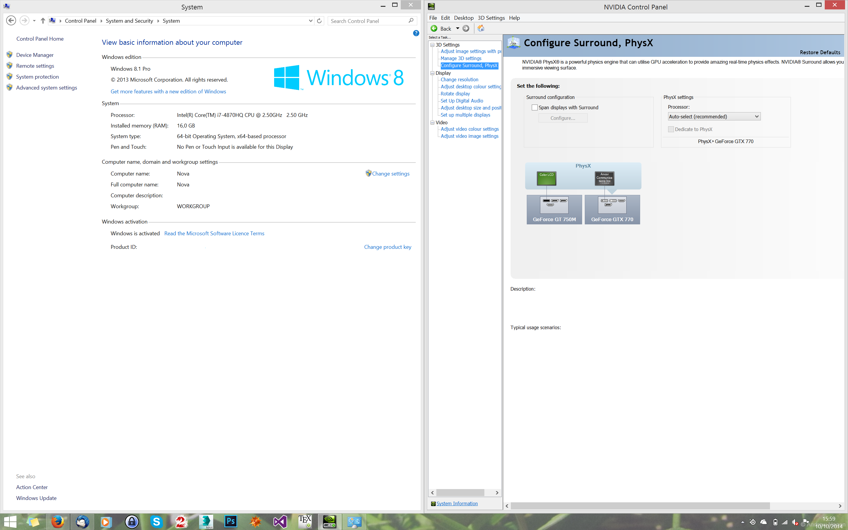

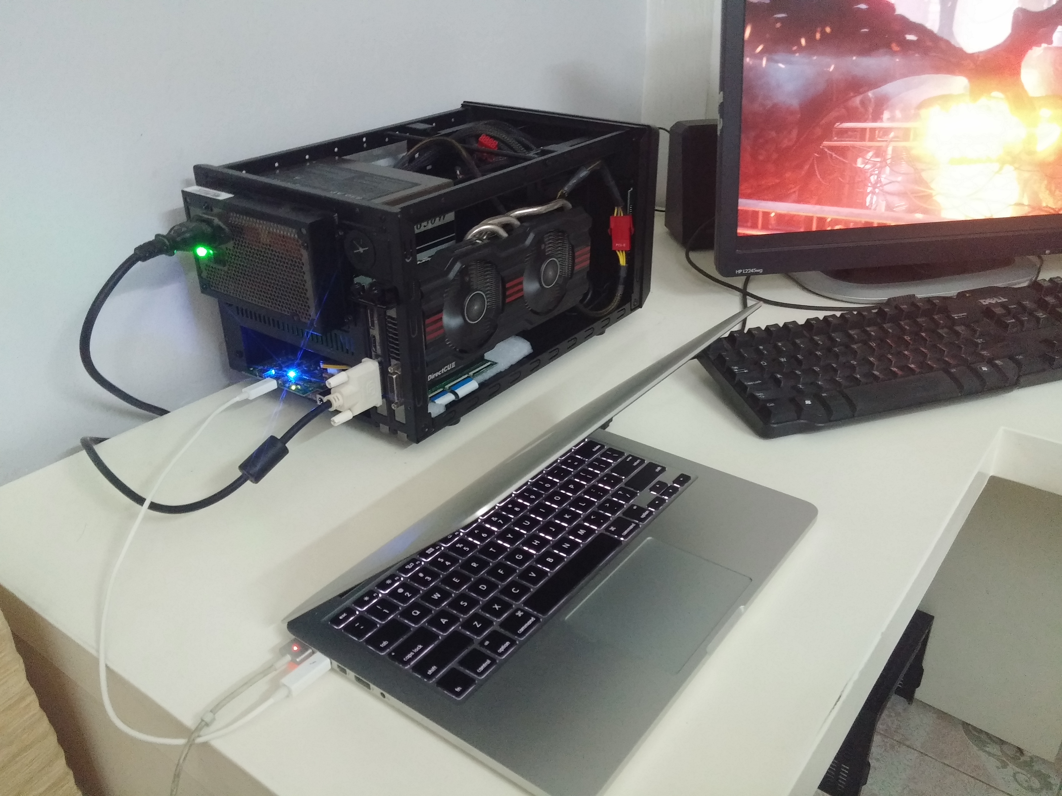

Alright! I got all my parts, made a quick set up and everything seems to work! :D
My setup:
- Macbook Pro (2014 - nVidia 750m)
- Akitio Thunder2
- Powered Riser
- Gigabyte GTX770 4Gb
- Corsair RM450 (this is the only PSU, Akitio PSU is not necessary)
Installation was simple enough:
- Connect MacBook and Akitio
- Turn on Akitio
- Turn on MacBook
- Install nVidia drivers
- Et voila, shit works! :D
I would like to thank this entire community for their extensive knowledge base and help!
If I can provide any further info or help, just ask. :)
EDIT:
3D Mark11: P9103
Uniengine heaven: 1097 (whatever that means)
True but then it's not really enclosed - I'd rather not leave the GPU or inner wiring exposed. The AKiTiO inner case already does a good job at supporting the GPU and TB card so it shouldn't be too difficult or expensive to come up with a new outer shell that fits similarly to AKiTiO's but with extra room to fully enclose a longer GPU with extra wiring.
I'll try to draw up something in CAD in the next few weeks. Then I'll start with trying to source a simple box from enclosure makers like Protocase. There's a laser cutter I could use at work to make some custom acrylic end plates.

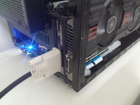

Just finished my transition from PE4L to Akitio TB2 implementations, everything is pretty much plug and play but internal LCD is not working no matter how I tried (had it working with PE4L + Sonnet Echo ExpressCard).
Setup:
rMBP13" 2013
Asus GTX 660
Riser with powered molex.
Benchmark comparision:
PE4L (x1.1): NVIDIA GeForce GTX 660 video card benchmark result - Intel Core i5-4288U,Apple Inc. Mac-189A3D4F975D5FFC
Akitio (x4 2.0): NVIDIA GeForce GTX 660 video card benchmark result - Intel Core i5-4288U,Apple Inc. Mac-189A3D4F975D5FFC

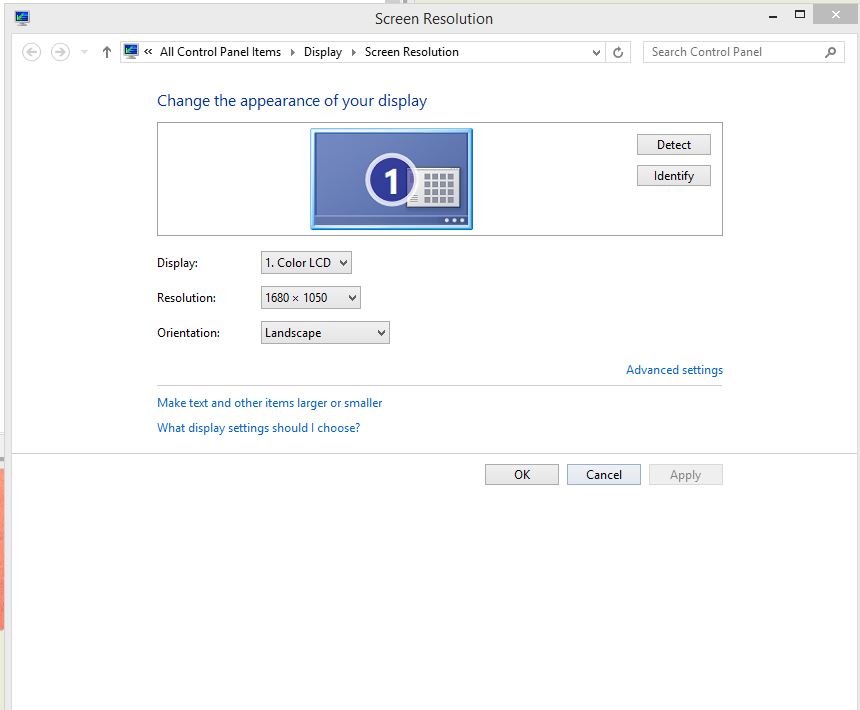

anyone had problems with optimus tried my workaround?
Pulled out the cable (yellow black) connecting akitio thunderbolt board and akito 16x board. (thunderbolt cable plugged in)
Started mac with alt and waited in boot options.
Started akitio with powered riser. (no akitio adapter)
When waiting in boot options I plugged the cable (yellow black cable on the akitio board) and boot in windows.
@linh1987, please try fixes below to enable Optimus support.
Pulled out the cable (yellow black) connecting akitiothunderbolt board and akito 16x board. (thunderbolt cable plugged in)
Started akitiowith powered riser. (no akitioadapter)
When waiting in boot options I plugged the cable (yellow black cable on the akitioboard) and boot in windows.
