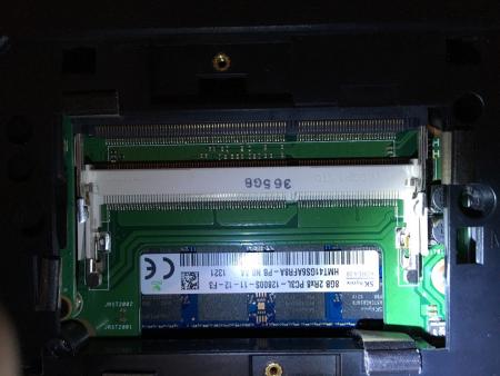

On my G75VW, there are 2 jumpers JRST2001 and JRST2002 near RAM. Those are for CMOS+Bios reset. I don't know if you have similar feature with your laptop.

I can confirm those two jumpers are next to the user replaceable memory sockets on Asus G750.

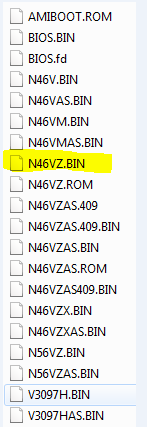

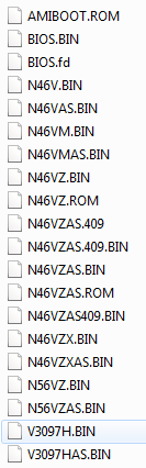

hi, i already did the ctrl+home, the usb did flash differently, but after that nothing happen, the screen still blank.
i dont know if the BIOS filename in the usb is correct or not, but i already tried a bunch of names, but nothing.
u can see all the names i've tried below :

hmm, but in the list that i showed u earlier, i got one of them right :
or, because the PhoenixTool shows 2 of them does that mean, in my usb i should copy the bios twice and rename one of them to "N46VZ.bin" and the other one to "N46VZ.409" ?

You only need one file, but assuming your "desperate" situation, I will assume you will try both names anyway, whatever it works. :)
Try maybe with a different USB stick like mentioned above.

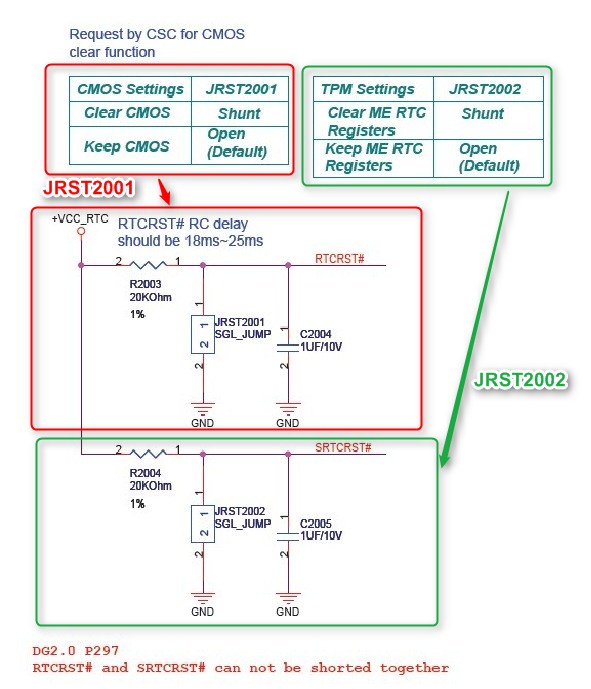

also i get this image from french forum, and JRST2001 is indeed for clearing CMOS.

From my testing those jumpers will clear the CMOS data (whatever that means) and the time.
But it will not clear NVRAM settings (stuff you mess up while in BIOS menus) so it will not help with making your laptop bootable.
