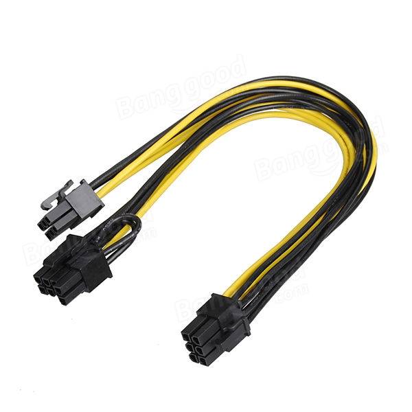

I have eGPU "GTX 970" and it has 6 and 8 pins for extra power. I am using eGPU power port to give this power to GTX 970, so what will happen if I connect 6 and 8 pins directly from power supply ?
More details please!!!
You have to power the GPU with both plugs! Also your eGPU base has to get power too and enough power as well, to be able to power the GPU from the slot, too.
I am connection 6 and 8 pins as shown to eGPU (EXP GDC Beast). can I connect them directly to PSU instead of eGPU ?
Sorry, I can't help you with the EXP GDC Beast. But if the EXP GDC Beast gets the power from the same PSU, you should be able to get the power directly from the PSU for the GPU!

I was wondering if somebody could link me to a 6 pin to 8 pin pcie power adapter? I bought the exp gdc beat external graphics card and i cannot find the correct adapter. I need a male to male 6 pin to 8 pin. I've tried two adapters already but i keep getting the wrong ones.
Any help from this awesome community?

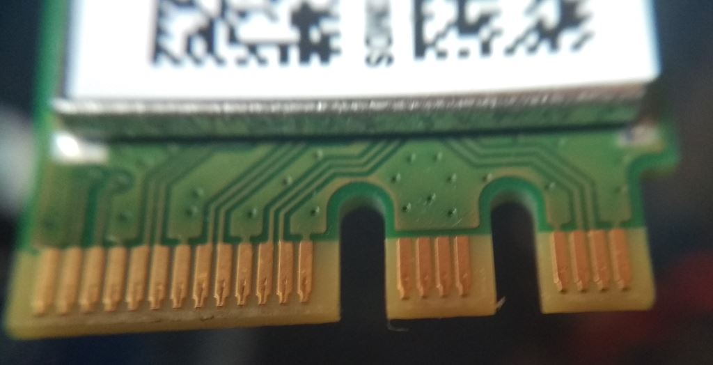

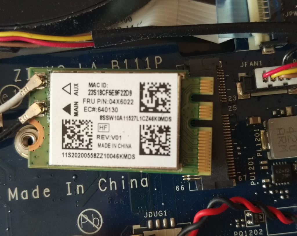

Hey, everyone!
Lenovo y50-70 owner here. Does anybody know, what kind of interface is this? It is not mPCI-E, but looks like NGFF. Still not sure, since NGFF's look quite different. So before ordering this device, I wanted to check with you, guys.
Any help appreciated!

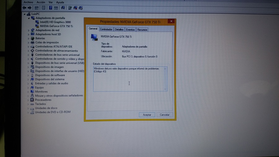

Hi everyone i have an error with the Exp Gdc Beast V8
My setup:
-Acer aspire 5750g (this model came with 1x4gb ram but i upgraded to 2x4gb ram)
-Exp Gdc Beast V8
-Gtx 750 Ti 2gb
-Power supply Nox urano sx 500

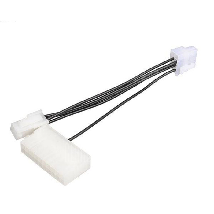

I connect the  1 x 20/24 pin and the 1 x 4 pin of the power supply to the cable the EGBeast came with
And I use 2 molex to power the gtx750ti
Cable Molex 4 Pines X 2 A Conector Pci Express 6 Pines 15cm
As indicated in the manual i had to change the bios graphic mode to integrated and diseable the network boot to start the pc and not having the black screen issue so i did.
The problem I have is that after having installed the gcard drivers and have it recognised by pc, I have this problem
It says its error code 43
I've tried unninstalling and searching  for hardware changes aswell but no solution
I'd apreciate some help, thank you
My setup:
-Exp Gdc Beast V8
-Gtx 750 Ti 2gb

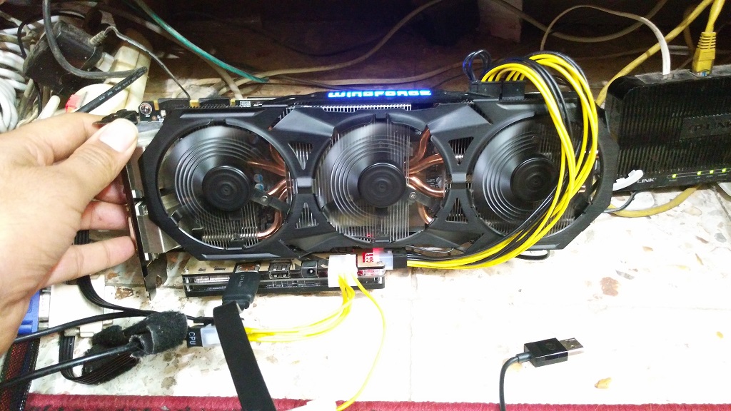

Hi. I'm new and this thread is the very reason I signed up.
I have a Dell Precision M4800: i7 4810MQ, Firepro M5100, 8Gb, Windows 8.1 64-bit.
eGPU setup: GDC Beast V8 expresscard version, R9 280x Gigabyte Windforce.
I plugged all the needed cables (ATX pin, 4-pin to the V8, 6 and 8-pin to the card) and of course the expresscard to my laptop.
Problem:
- Windows recognized my vga as "Microsoft Basic Display Adapter".
- When I try to install Crimson 16.3.2 for Radeon, 14.12 Omega, the lap BSODed.
I really hope there's some solution so I can pair the sexy CPU with the feisty GPU.
Thank you in advance.
EDIT: YAAAY! I found an installation guide for R9 290 by darky and now my Egpu runs rock solid!

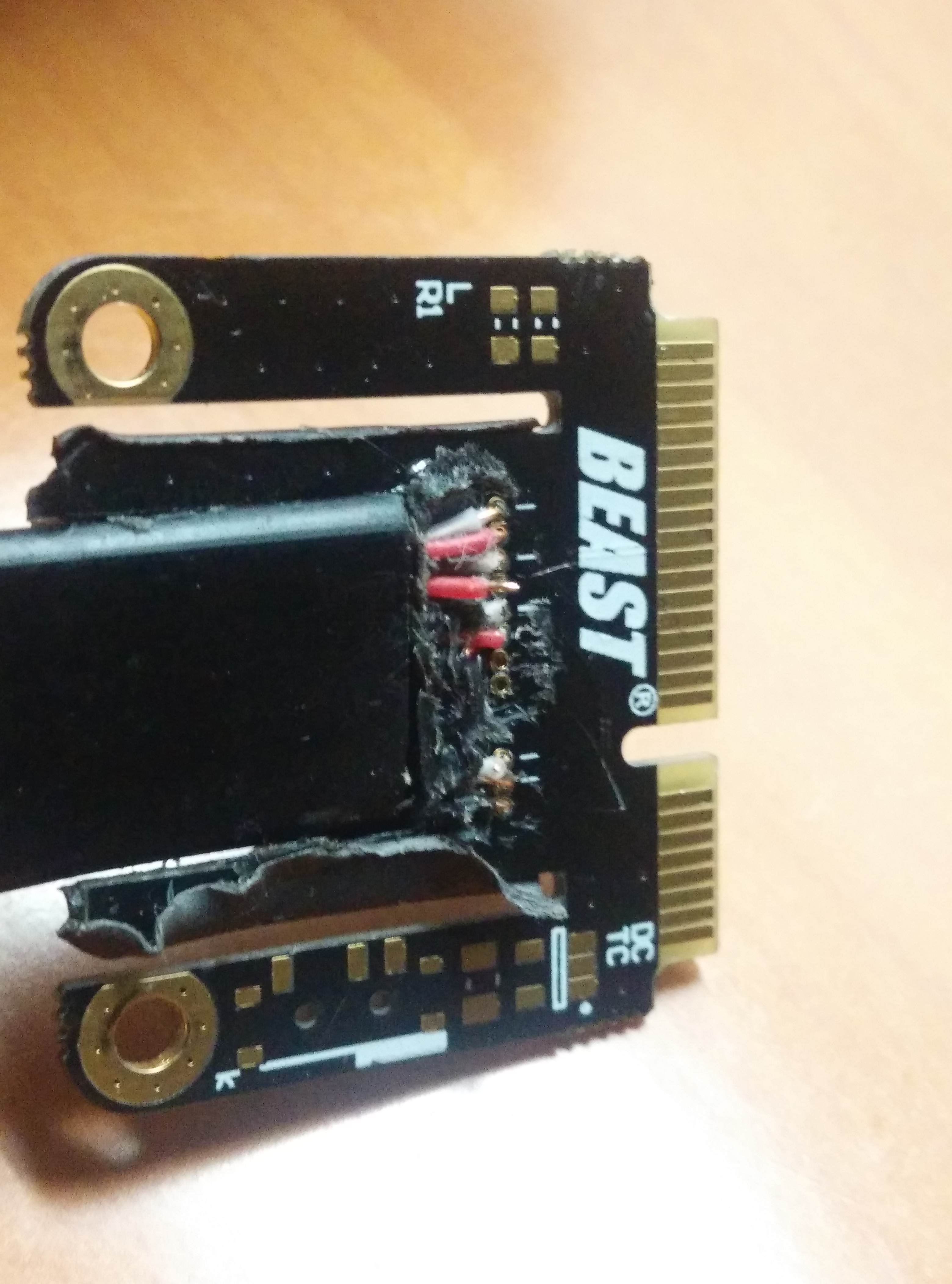

-HP spectre x360 (13-4009na)
-EXP GDC v8 ngff
-Dell 220w psu
-GTX750ti
when i boot the laptop there is no response from the card or the dock, the gpu fans do not spin and no indication leds come on. I cant find anything useful in the bios and hotswaping has no effect. i have also tried the ptd switch in all positions. there was no ctd switch only 3 pins, connecting the 2 left pins also had no effect.
When does the docks indication led come on? what should i try?
edit: the dock is definitely getting power as the LED on the psu is on. any help is appreciated. I'm at a loss for what to do.
