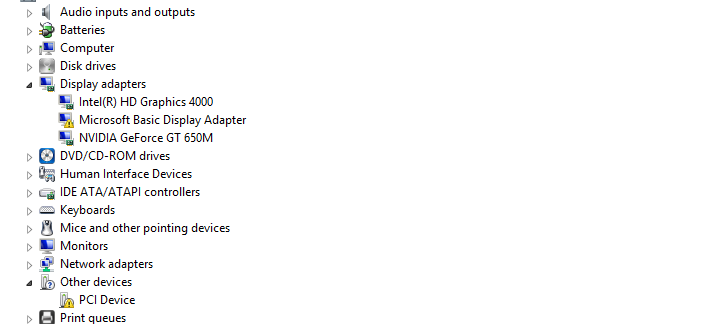

Hello!
I also ordered the beast.
I think that this is a really interesting idea and thought to try it out with a nvidia gt 520. Nothing too special.

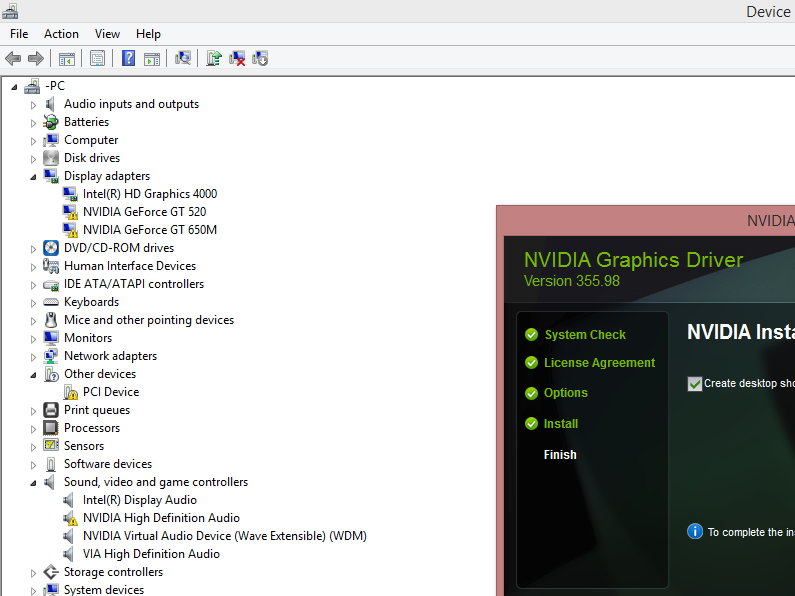

I had a 450W coolermaster psu lying around and gave it a go. Connected the PSU to the unit, and the mini pcie to the laptop. After powering my laptop on, the psu started working, red light on the beast started working and all good. Could boot up and everything.
On the device manager it detected a microsoft display adaptor or something similar. So I went ahead and uninstalled everything from add/remove programs related to nvidia. (the laptop has a 650m).
Disabled the 650m and downloaded drivers for the 520. The driver version was 355.98.
So I started the driver installation, everything working well, it detected the 520 and finished the installation. Prompted me to restart my computer. Here is a screenshot after the installation.post-39524-14495000837476_thumb.png
As you can see, it says 520 in the device manager now, this image is taken just before the restart. For some reason, I noticed that the 650m was enabled for some reason again, so I went ahead and disabled it again.
Now after the restart, after windows has done loading, the PSU stops and after a short while I get a blue screen, saying video_tdr_failure (nvldd mkm.sys). And the computer wont start. It will start if I remove the beast though.
So hopefully someone has any idea about what is going on. I think it might have something to do with the 650m drivers, I am not sure though since I did disable it.

A quick update. I thought that the problem was that windows automatically keeps reinstalling the 650m driver and the blue screen during windows start up might be the conflict of the 520 and the 650m drivers.
So what I did was first connect the beast normally, so in the device manager I would see the intel hd, a microsoft display adapter and the 650m.
Then I went ahead and disabled the 650m and proceeded to install the 520 drivers. The installation was completed successfully and in the device manager the 520 was now shown.
To prevent the automatic 650m driver installation during windows start-up, I went to gpedit.msc and enabled "Prevent installation of devices not described by other policy settings. I tested this before with just the 650m and it indeed stopped windows from automatically installing its drivers.
But still no luck, after the restart I get a blue screen saying video_tdr_failure. So I think, that the problem isn't the 520 and 650m drivers preventing the startup. Since the 650m drivers were in theory atleast not present during this test.
[ATTACH=CONFIG]16145[/ATTACH]

Hello everyone. My system is samsung ativ book 8 np880z5e-01at , i7 3635qm cpu , 8gb ram , hm76 chipset , igpu hd4000 , dgpu amd radeon hd8870m , egpu1 amd r9 290 , egpu2 nvidia gf440gt. As an adapter I bo7ght an Exp Gdc v6 Beast.
I conected all conectors to adapter : 4pin cpu and 24 pin to 620w cooler master psu , 8pin to adaper , 6pin and 8pin pcie conectors of psu to r9 290 and the hdmi to adapter and in the notebook pulled out wifi card and inserted minipcie conector. All conections good and red led lights up and egpus and psu fans work when notebook turned on.
On win10 with dgpu disabled in dev manager CTD off and PTD 12sec got to see 290 in dev manager but code 12. Used setup 1.3 to do compaction but couldnt get from win loading to startup screen. Disabled dgpu in setup 1.3 and i could see r9 290 in dev manager. Installed manually latest catalyst driver but could not see nothing on external monitor tried 440gt and got same result. Tried dsdt override with Dsdteditor and used fix errors in compile menu which got me 4 obj not exists errors. An aml file did though compile and I loaded its table but that resulted in windows boot bust ☺. Got win 8 up and tried with Ctd off Ptd off dgpus disabled in setup to boot but with 290 it hangs before win start screen. Tried powering down and up psu and got after a few attepts to see 290 in dev manager. At first I had bsod when I had hd4000 on win basic driver but when I instaled samsung driver I got both igpu and egpu2 to be seen properlly in dev manager (seems samsung driver contains last catalyst drivers so i didnt need this time to manually install them). Even though both could be seen I could not get egpu2 to display on external monitor. Than I switched on 440 gt and with dgpu disabled in setup 1.3 I got to boot without problem and installed manually nvidia driver. Got desktop to display on external monitor but when starting games id get nvidia drivers hang. Installed dxwebsetup and that made the system see external monitor as main monitor. Switched pcie from x1.2 to x1.1 and driver hang stoped but the performance is poor on external monitor like its on igpu that makes me think igpu reders but it displays thru egpu1. The main monitor switch done by dx install seems odd. Also id be glad for any advice on how to make 290 speed god to work. Btw considering how much u need to learn about dsl files dsdt override aint so easy. Tnx for bearing with my text wall.
