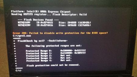

I've Y510P and i dump bios using Intel FPT Tool (probably latest version 9.5.1.1458). I mod (remove whitelist) BIOS 3.05 (without Windows Key, i have no OS version) with EZH20 Tool (Option - "Removed module" -> 11D378C2-B472-412F-AD87-1BE4CD8B33A6). But when i try to flash with the same tool that i make dump Intel FPT Tool and i have error -> Error 280: Failed to disable write protection for the BIOS space!
I enable/disable option Flash Back in BIOS but flash is still without sucess :-/

OK... i try to use FPT tool in DOS mode and i have the same information about Flash Protect (error 280)... then i try use PRR2 tool:
@svl7 - maybe you can up to date the prr2?? I must replace the 2230 to 7260AC because of wireless range in my house :-/
[ATTACH]9853[/ATTACH]
Maybe Y510P have a function of recovery bios (the recovery file must be name Yx01.bi) but i don't know that i can use the dump from FPT Tool or i must use the FULL ROM with EC and MEI and which combination of keyboard button launch this recovery mode.

I'm also getting the same error with a Lenovo Z510. I think the chipset Intel HM86 is to blame which powers the Haswell generation. I've tried almost any solution to flash the whitelist modded bios but no luck.
