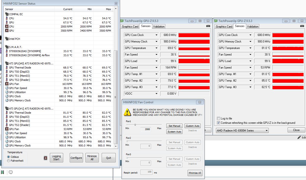

Hi Martin, this is what I'm seeing with the system half open and furmark running at full blast (all options selected with 1280x1024). This is after adding new paste to both GPU's and doing a retention mod to GPU 2 (i added a c clip + plastic washer to GPU 2 to increase tension on the core).
Hm, both ~99% loaded and same clocks.. IMO a cooling issue - heatsink, thermal dissipation or a GPU chip with bad thermal characteristics..

Brian, according to that screenshot the fan on GPU2 is running at much lower speed than GPU1. Can you audibly check the fans when loading to see if GPU 1 is running noticably higher than GPU2?
If that is the case, could be a dying fan. If the fan is OK, then it is a bios issue and needs an update.
What I would do is try run a few wires from GPU2 fan to GPU1 fan header to test if the fan runs at the same speed, or just swap the fans around. I would say thats your issue.

Nice catch Ash those are very possible. Maybe all of them are suffering from this and need the gpu fan replaced and or need fan control updated.
How do you know that GPU2 fan speed is much slower, do you judge based on the GPU-Z reported fan speed (or HWiNFO32 fan speed under the GPU)? If yes, then forget this reading - it's invalid, because the GPU doesn't control the fan here. Just like on other Alienware models I had to implement the model-specific fan speed reading via EC, so use only those values for fan speeds. Unfortunately for M18x I don't know how to read both fan speeds yet. I can read 2 fans only now: CPU and GPU (probably GPU1). I'm not sure if Compal offers the GPU2 fan speed read, I could try something - make a special build to test if I can get the GPU2 fan speed too. Let me know if you want to give it a try.
Yeah, I figured as much Mumak, that's why I asked him to audibly check, because if he has done a retention mod the only problem left would be a dodgy fan.
-Ash
The fan is okay because it eventually kicked into high after I ran furmark at 1080p. Mumak's program also puts it into full blast so the problem seems to be something else.
