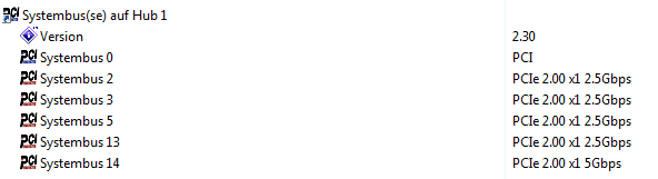

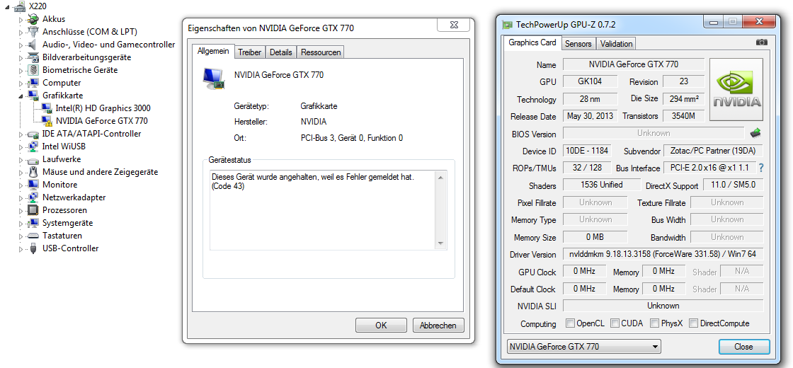

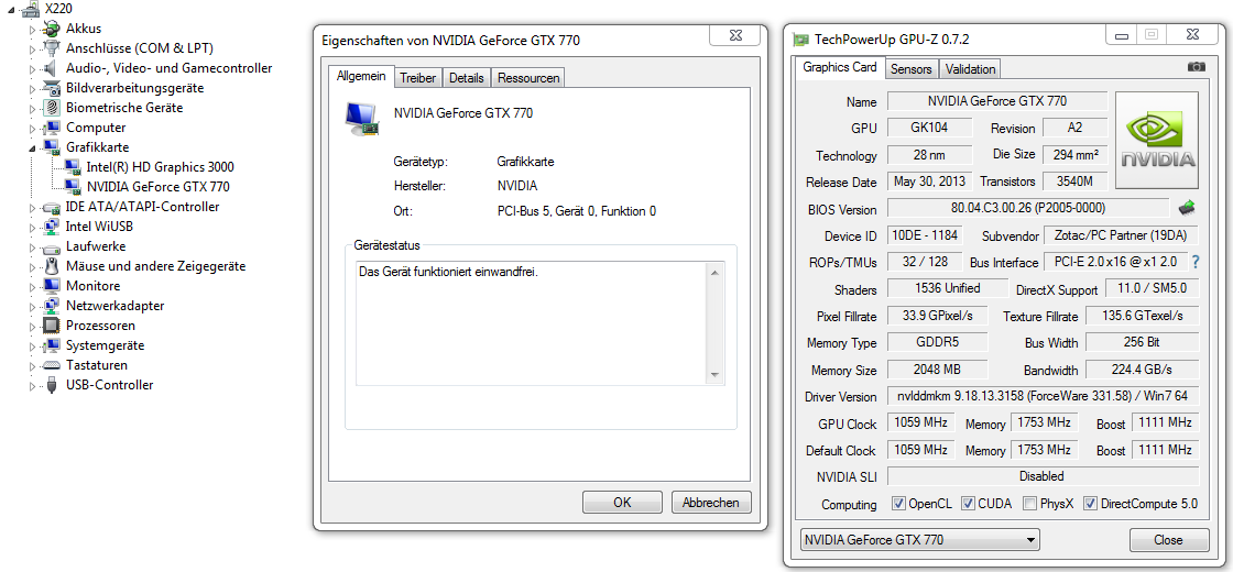

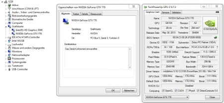

Ivxy Posted November 19, 2013 Share Posted November 19, 2013 Hi there, I bought a KZ-B26 to test for my X220 to see if this mastered PCi-E 2.0. Since the Lenovo x220 has a whitelist, I get a BIOS version 1.39 without whitelist, this also works without problems. The problem is that the ePGU not want to work with my KZ-B26 , I get the error 43 and also tried to switch to PCI-e 1.0 and to PCI-e 2.0, but is not help. So the pictures show you my Problem (the problem, the normal, my PCie- bus): So anyone has an idea what can I do? Would the Setup 1.x help here? Quote Link to comment Share on other sites More sharing options...
Tech Inferno Fan Posted November 19, 2013 Share Posted November 19, 2013 Hi there,I bought a KZ-B26 to test for my X220 to see if this mastered PCi-E 2.0. Since the Lenovo x220 has a whitelist, I get a BIOS version 1.39 without whitelist, this also works without problems. The problem is that the ePGU not want to work with my KZ-B26 , I get the error 43 and also tried to switch to PCI-e 1.0 and to PCI-e 2.0, but is not help. So the pictures show you my Problem (the problem, the normal, my PCie- bus):[ATTACH=CONFIG]9610[/ATTACH] [ATTACH=CONFIG]9611[/ATTACH] [ATTACH=CONFIG]9612[/ATTACH]So anyone has an idea what can I do? Would the Setup 1.x help here?Setup 1.x has a Video Cards->initialize function that can overcome error 43 on NVidia cards. That's assuming it's not a hardware error. Error 43 has also appeared when users have had mHDMI cables which could also be the case with your kz-b26 though with a FFC cable. Quote Link to comment Share on other sites More sharing options...

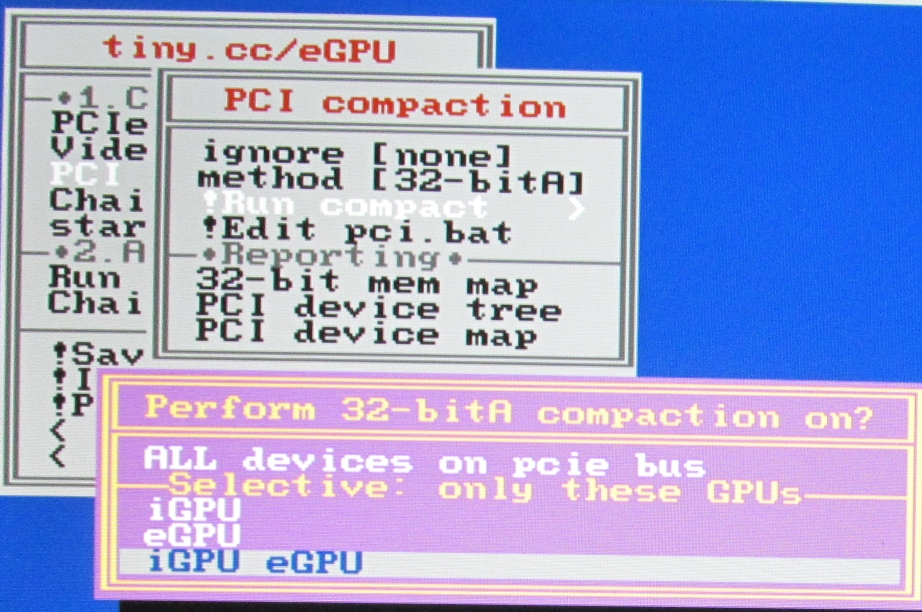

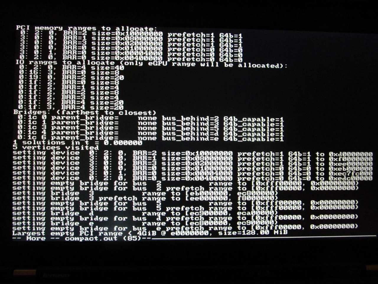

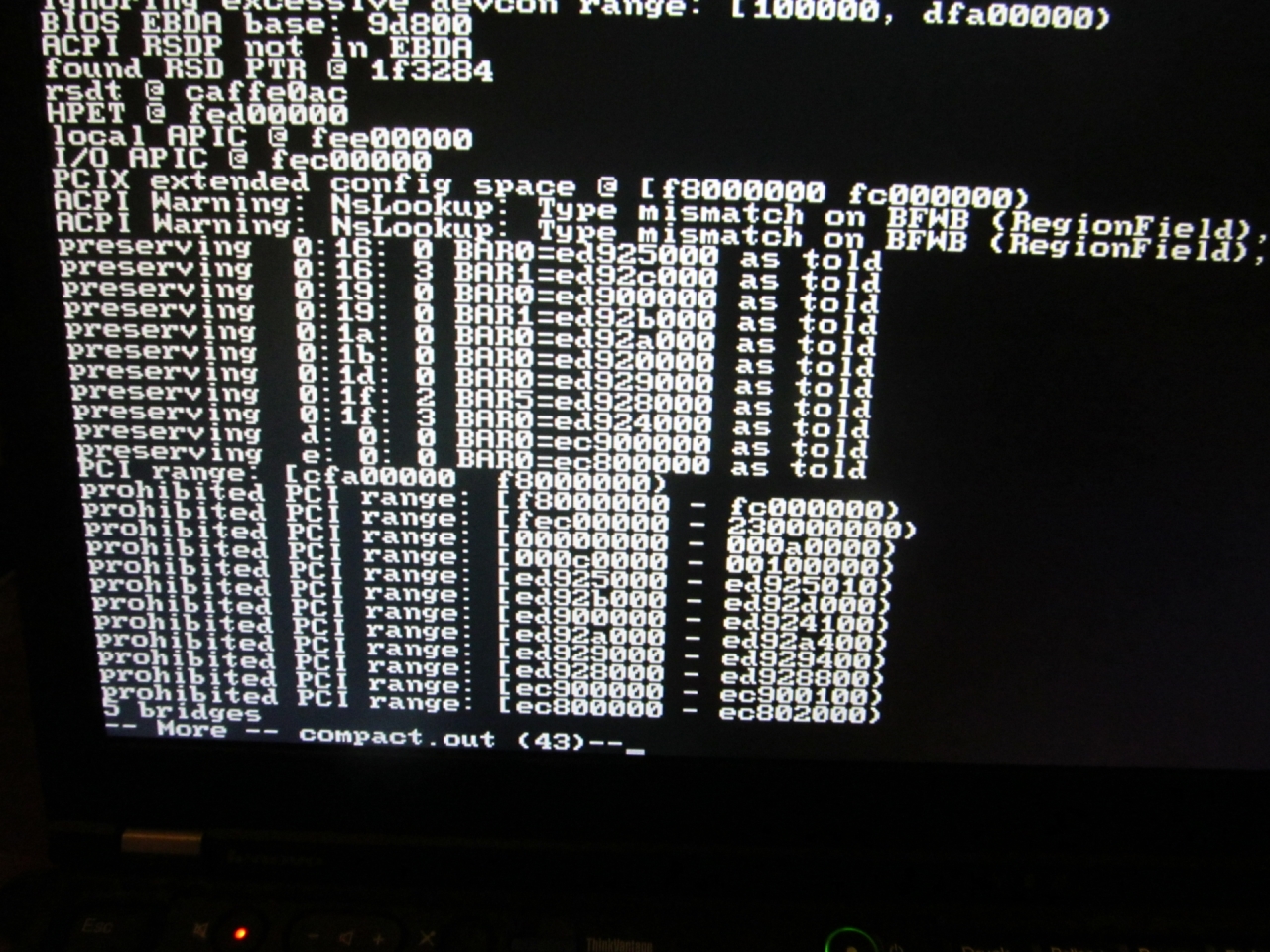

Ivxy Posted November 20, 2013 Author Share Posted November 20, 2013 Setup 1.x has a Video Cards->initialize function that can overcome error 43 on NVidia cards. That's assuming it's not a hardware error. Error 43 has also appeared when users have had mHDMI cables which could also be the case with your kz-b26 though with a FFC cable.So I installed Setup 1.x and tried to work the eGPU over the KZ-B26 . However, I will not get her to work. Do I need appoint options in a correct order or there are options which must only be carried out and others that I should not do? I tryed many things but I it does not want to work.[Edit]Make it a diffend if I use Setup 1.x V 1.1b5 and not the new 1.3? Quote Link to comment Share on other sites More sharing options...

Ivxy Posted November 21, 2013 Author Share Posted November 21, 2013 Now I have tested many combinations of possible settings, but no wants to work. Form hot plugging the 'PM3N' end after you bootup from Windows and Setup 1.x. This by the Setup 1.x with the Video cards->Initialize setting. And all this with and without PCI Reset Delay from my PE4L by 6,9s. And a lot of others combinations of settings. After look at , I have tested it, but without the dGPU off. If I make this step message. Maybe a error or something? But if I use my Expresscard, all settings work. Maybe the KZ-B26 has a damage? But I can' see a physical harm. [Edit] Really nice comment, and one thing I have not seen so. But I also made up my mind how useful this is. And what is going on intern, I study Mechatronics (Electrical engineering, computer science and Mechanical Engineering). And I realize that the KZ-B26 is more or less a KZ-B22. But this does not mean that they can only PCI-e 1.0, maybe. A reason why I try it, it is because my Professor say: "tested always the limit" what I try. A other reason is, that if I buy a new Laptop, with whom I will have an eGPU again. I know on what should I look for, and what I should avoid. But a working connection I would still like to build, even if it is only one PCI-e 1.0. [Edit 2] So, after further testing, it is not possible for me to activate the eGPU in the Setup 1.x and Windows with the KZ-B26 adapter, if I hot plugging the EGPU. And if I start the eGPU before the X220 I can't activate the eGPU without the error 43, with all reasonable combinations of settings. Quote Link to comment Share on other sites More sharing options...
