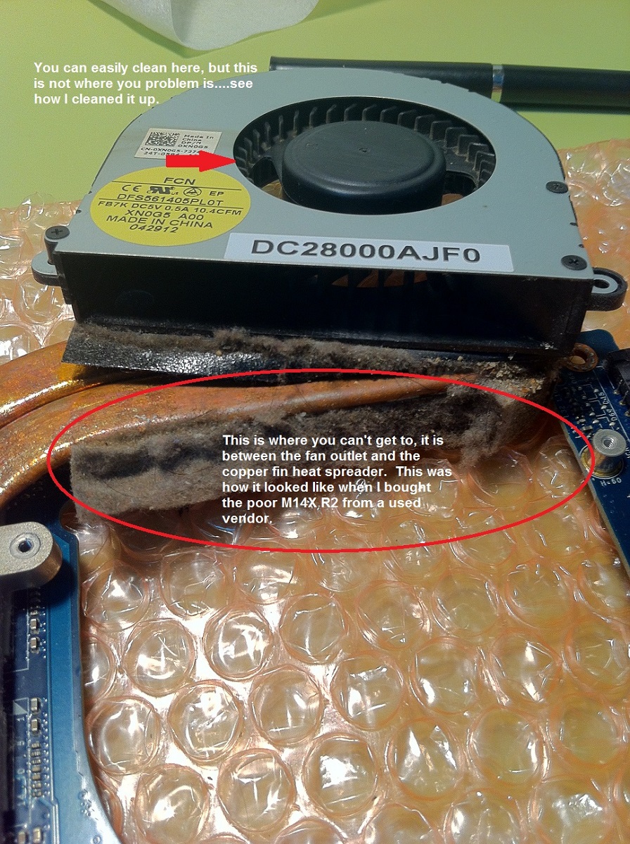

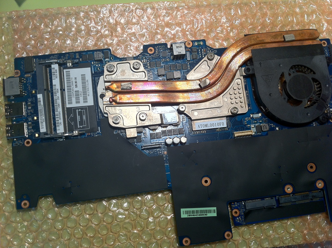

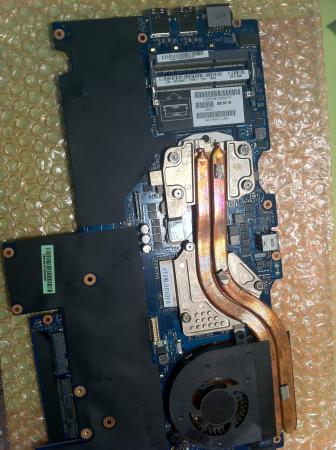

If you follow instructions carefully, you will finally have access to the motherboard which you will have to unscrew the heat sink+fan combo. It's not a very good design as you can see both the CPU (On the extreme left), GPU (in the middle next to the fan) are extracting heat via two copper pipes, they both goes to the same heat spreader fins setup which the fan blows against.
You can easily get the dissemble info, a good one I followed here:
Alienware M14x Disassembly/Teardown and Upgrade Guide!

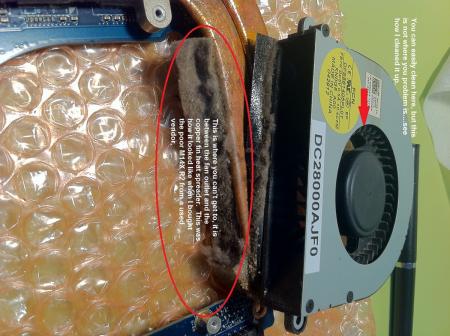

Check out the above, when I got the machine via a used vendor, it got dents, hair, dust, skin (OMG) all kinds of horror on it. When I took it apart I basically sterilized the machine.....with gloves and a mask, it was that horrible. The area I highlighted is actually where it cause all your problems, accumulated dust/hair/otherwise non air blow-able particles/dust/gremlins/....etc.

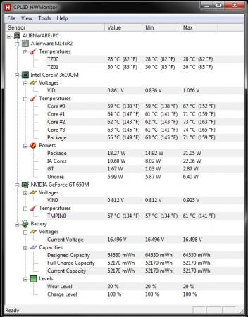

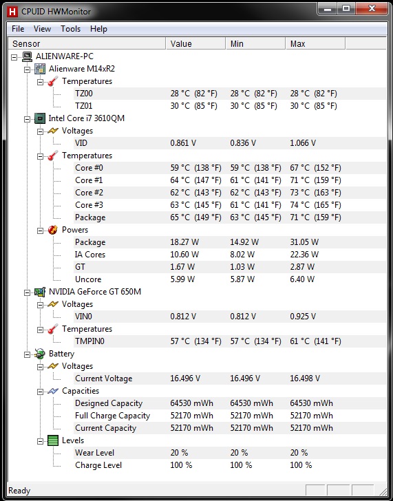

Here is the system temp on normal usage (60C average and peak around 80C++) I have like 40 chrome web pages and a VMWare running at the background.) If I put some door stoppers behind I probably bring down the temperature further as suggested.
Before the cleaning, temperature for both CPU/GPU stay constantly above 65C, reaching an ungodly 102C under load and emergency system shutdown (not to mention the fan was constantly loud). For repaste I recommend you review the web a little, I used Cool Master's E1, anything that's easily to spread, cheap and good review will do.
