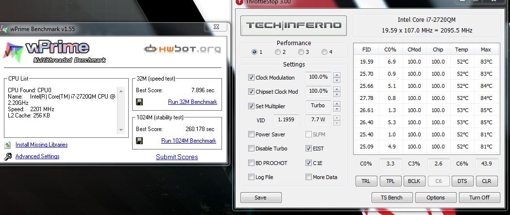

2720 here: ran the 1024 wprime
it stays at 30x for like 5 sec then drops to 29.5x for 90 sec or so, then drops t0 28x for a few secs then the reminder of the test is at 27.5. max temp at 85. also have my bclk at 107.

everything was done in the bios. i took me a couple of tries before 107 was accepted for some reason i was able to set it higher after the laptop has been warmed up, on a cold boot i wasn't even able to go past 105 sometime less. 107 was been good so far for me, been like 2 weeks with no problem, been lazy to go any higher.
