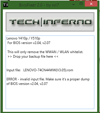

Hello all i have been having kernal display driver has stopped responding but has recovered errors CONSTANTLY, fkn impossible to game ( excuse my french ). I have done everyhing besides this and the only solution is to downclock my CPU+GPU even though my temperatures dont go above 70* i get these errors. I have just finished backflashing my bios to 3.05 from 3.08 however for the step:
(2) - Download Lenovo_Y510p-Y410p_[v3.05]_modified.zip and  put the files of folder [1] to the root of your prepared USB DOS stick.
Let the BiosFixer prepare your BIOS for flashing by drag and dropping your backup file on it. Put the created "v305mod.bin" file to the root of your USB DOS drive as well.
It is saying i do not have the credentials to download it. May someone help me out here please? im really anxious to get this bios mod mixed into my rig and mess with the voltages and crap to HOPEFULLY be my remedy, my cure to my last 3yr nvidia crashes every 2-5min PLEASE I AM BEGGING!!!!
Okay I have all the files and right now im trying to put my backup bios on the BIOSFixer and when it opens it says for v2.04 and 2.07 ( I am on 3.05 bios )  anyway i drag my 3.05backup bios in the program still and says: in pic below
What do i do ? please help!
Hi!
For modify bios v3.05, you should use BiosFixer for v3.05. You can search it in "Lenovo_Y510p-Y410p_[v3.05]_modified" folder from the first page of this thread.
