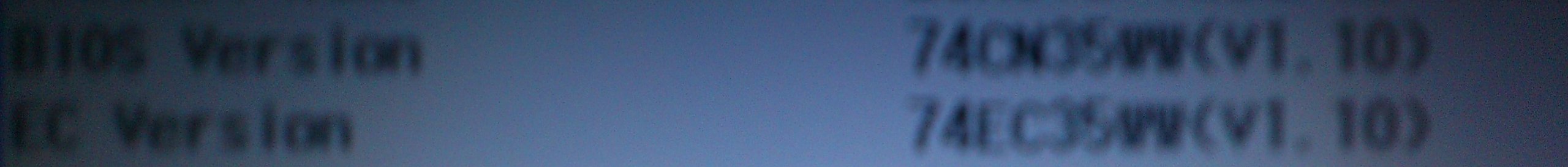

flash failure
1.boot in dos run EC.bat
post-15178-14494997918503_thumb.jpgwaiting for a second, Ctrl+Alt+Del restart
2.restart
3.restart again,in the bios setup EC version not change.

The new .bin works. although the flashing quite long and the fan spinning at full speed(very fast).post-20850-14494997953757_thumb.jpg

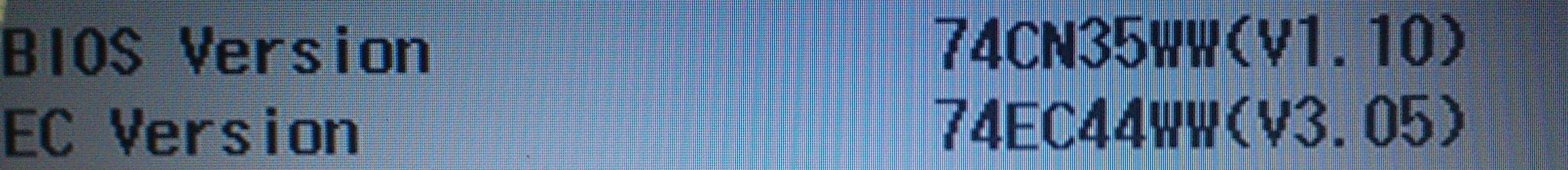

But now i understand,in the Official BIOS,search "iflash_ec_img" ,from 02 00 70 02 ...cut 131072 bytes. It's EC file.
Use flashit xxx.bin /EC.
Now my EC version is 3.05.
