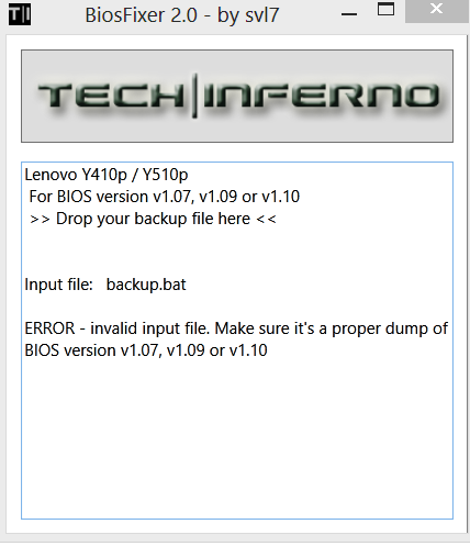

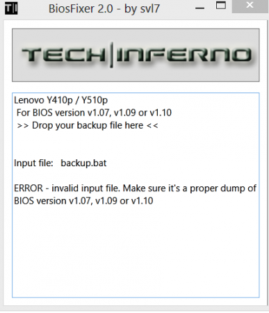

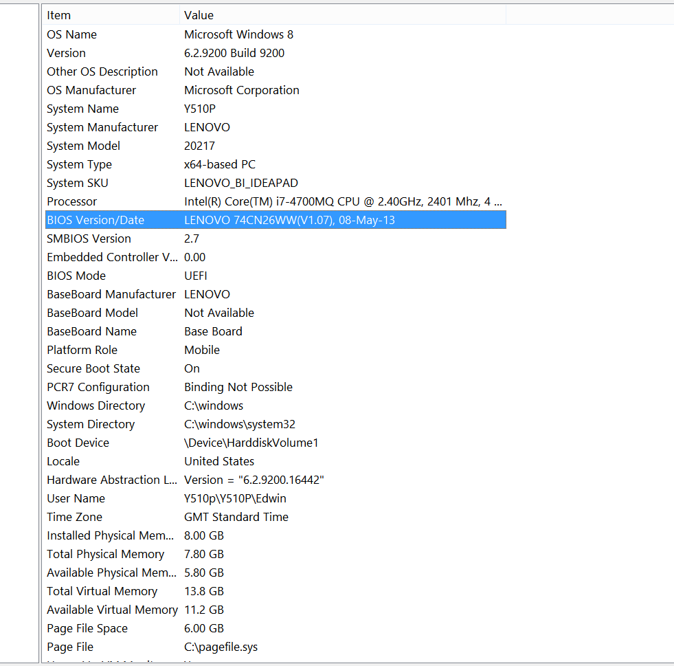

What am I doing wrong here? I tried to follow the steps in the OP but it kept saying its not 1.07. Please advice.
what program are you using in that first screenshot so I can check against mine

mibix... you were dropping the batch file to patcher, you need to drop
actual BIOS file to patcher, and then re-flash the patched file back
Heh, I never had any problems applying this mod. I was quoting 3dwin4tor, but nice grab I didn't even notice he was putting in the wrong file :P
@3dwin4tor : I will take a screenshot when I get home but I think joom00 is right, you are just putting the wrong file in to the patcher
