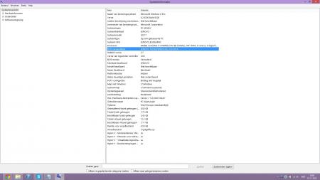

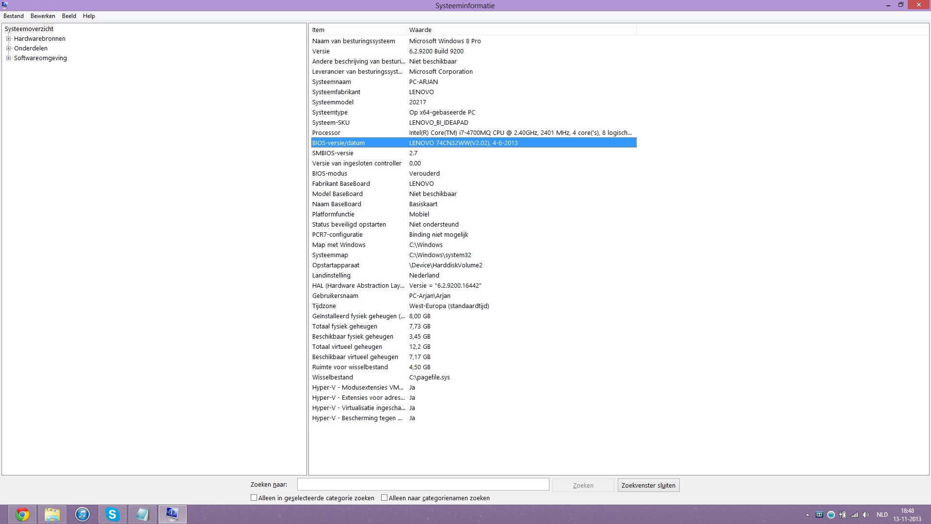

Hello svl7!
Unfortunately my y510p has bios version 2.02..
Can you help me by adding v2.02 support to the tool? Or is it possible that I update my current bios to a white-list-tool friendly version?
Thanks! :)
Are you sure it's 2.02 and not just the utility, if it's true svl7 needs a copy of your bios. He have written a nice guide on the first page.

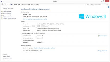

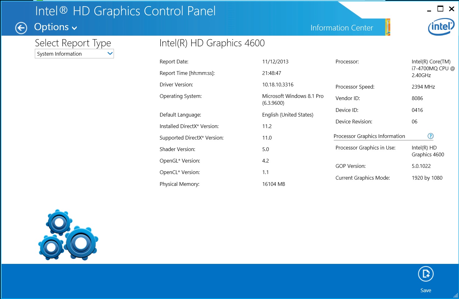

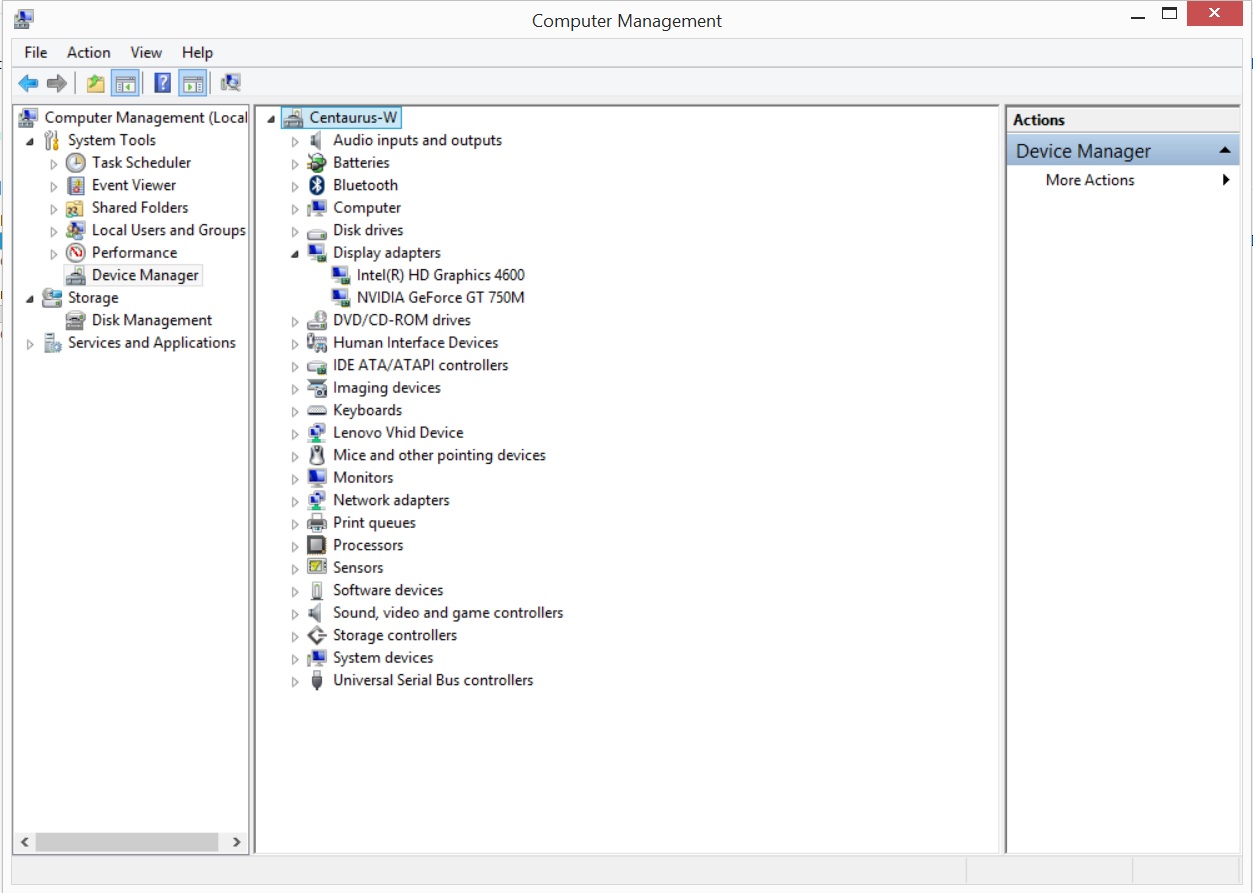

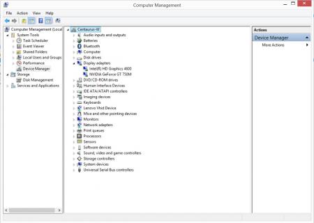

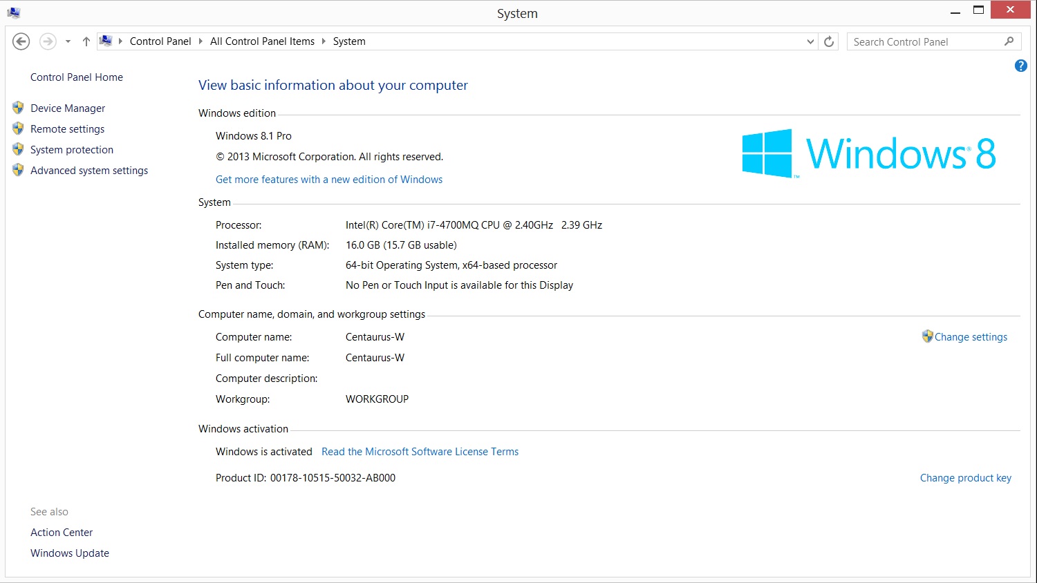

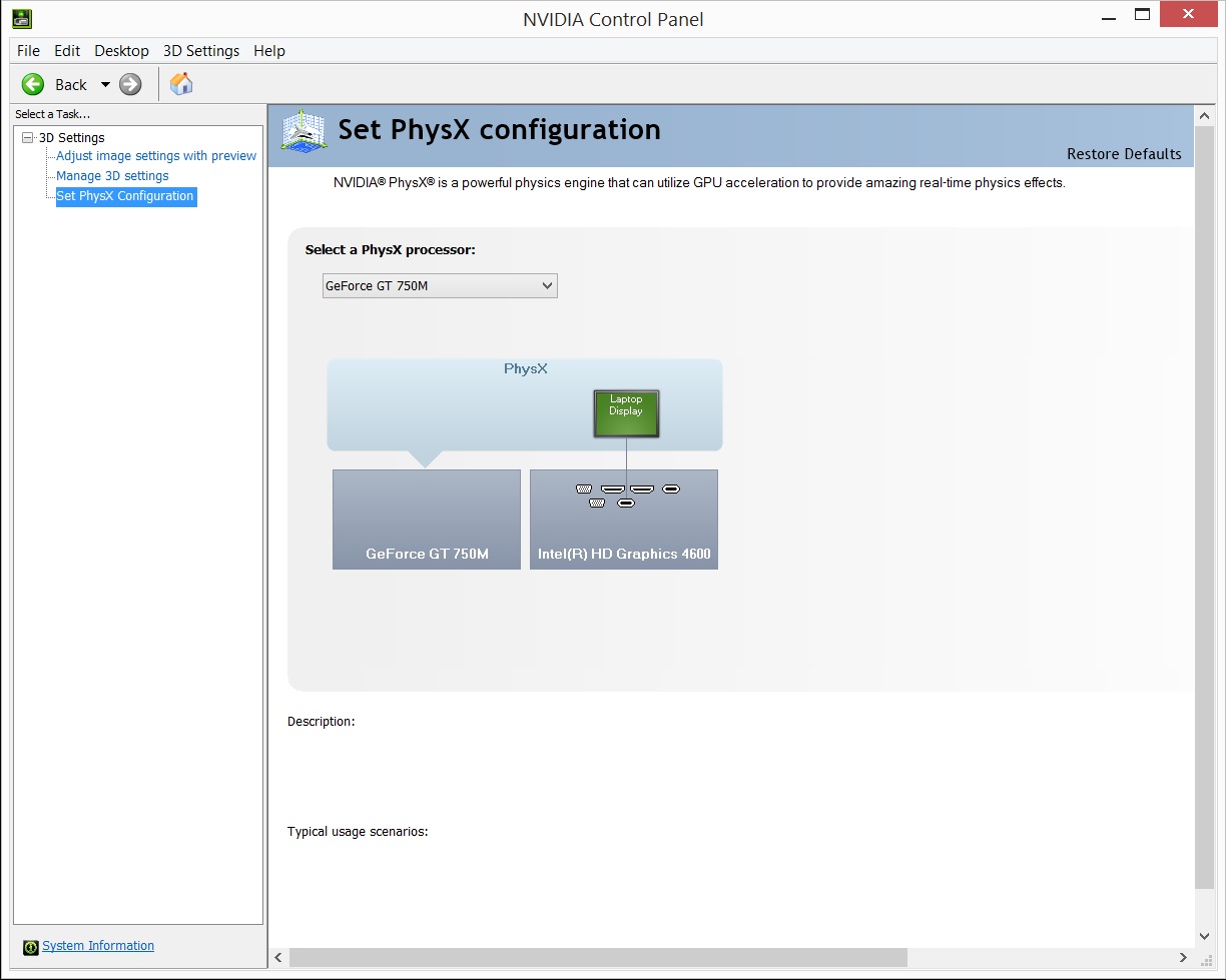

@crux161
So I would agree that my IGU was disabled when I was running Win 8 Pro, but not in Win 8.1 Pro,
I am not sure how or why, but if you take a look at my attachments, I think you would agree that the IGU is most definitely not disabled.
Note that these are not with my second SLI GPU in the system.
I will gather that information when I get home to my second GPU.
Cheers
I'm afraid not.. And this is also what it says at the bios screen.
Anyway.. My bios backup is send via PM.
