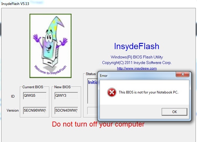

I have flashed accidentally my bios with wrong version. I have Y580 (v bios: 5dcn40ww) but instaled bios from G580 (v bios: 5ecn96ww). Flashing proces went smoothly w/o any errors but after restart my HDD is not visable in bios (only SSD work).
When i tryied reflash it back, pop an error:
I googled a bit and find the way to skip this error (extracted 5dcn40ww.exe using winzip and edited

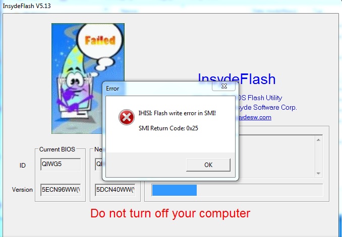

It helps, but in next stage, during flashing it returns an error:
After many attempts and edits platform.ini i couldn't solve this error. If any1 know how to do it please tell me!

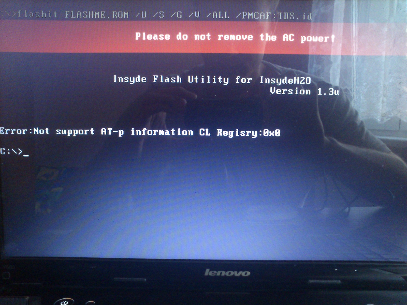

I have found following solution:
How to flash InsydeH2O EFI under DOS enviroment - Lenovo Community
I have done every step but unfortunately it doesn't work. After i boot my pendrive i can see this screen:
I don't know what else i could do. Please help me.
Please attach it to a post, that crap filehoster requires a download manager and I'm not gonna touch it.
Just click on 'go advanced' when posting and you'll find the attachment options.
