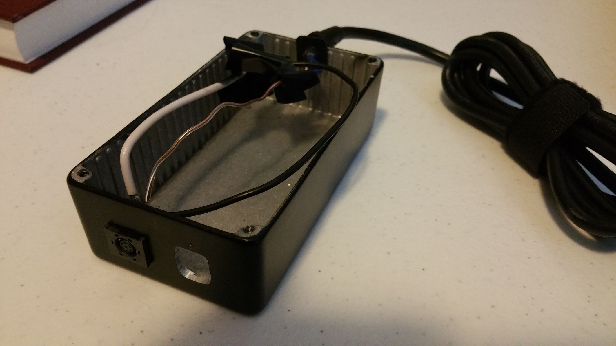

Steve135 24 Posted August 29, 2015 [MENTION=119]Mr. Fox[/MENTION], I'm getting the equipment together to perform this mod. I've got an additional PSU coming but wanted to create a setup similar to your v3.0 (cast aluminum with plug in connectors). However to do this I need an additional wire to connect from the project box to the computer itself. Since I don't need the whole PSU setup I was contemplating on purchasing an 150W M15x PSU and just chopping off the wire portion and using this. However I'm not sure if the M15x or other Alienware laptop PSUs have the same signal wire connection as the M18x. It would also be drawing more current through the wire then an M15x would but I'm not sure if that matters. Do have any expertise here?Also I noticed an option in my BIOS that lets me deselect the computers checking for a official PSU, though I'm not sure if works. Does your v3.0 also connect the signal wires just like your v1.0?Thanks,- - - Updated - - - [MENTION=119]Mr. Fox[/MENTION], I'm getting the equipment together to perform this mod. I've got an additional PSU coming but wanted to create a setup similar to your v3.0 (cast aluminum with plug in connectors). However to do this I need an additional wire to connect from the project box to the computer itself. Since I don't need the whole PSU setup I was contemplating on purchasing an 150W M15x PSU and just chopping off the wire portion and using this. However I'm not sure if the M15x or other Alienware laptop PSUs have the same signal wire connection as the M18x. It would also be drawing more current through the wire then an M15x would but I'm not sure if that matters. Do have any expertise here?Also I noticed an option in my BIOS that lets me deselect the computers checking for a official PSU, though I'm not sure if works. Does your v3.0 also connect the signal wires just like your v1.0?Thanks, Quote Share this post Link to post Share on other sites

Steve135 24 Posted August 31, 2015 Thanks [MENTION=119]Mr. Fox[/MENTION], saving the strain relief boot is a great idea. I'll be putting it together in the next couple of weeks and let you know how it goes. Also I'm just curious in your benchmarking with the M18x are you using any type of laptop cooler or upgraded fans? I seem to remember a post a while back stating that you could get 11.7 cfm fans to replace the stock fans but I couldn't find anything with that spec on e-bay. Also I've read that if you just elevate the laptop, it will be just as good as a dedicated cooler. Do you have any advice here? Thanks again.Sent from my SM-P900 using Tapatalk Quote Share this post Link to post Share on other sites

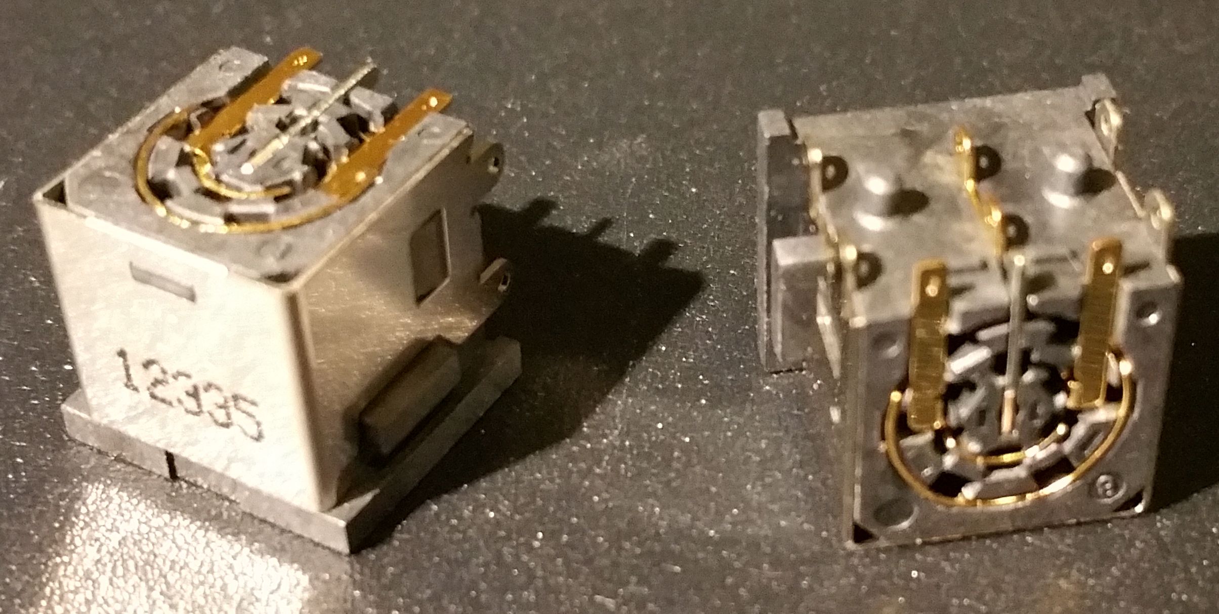

Steve135 24 Posted September 3, 2015 [MENTION=119]Mr. Fox[/MENTION], so these puppies came in the other day, got the same ones you recommended in your post 65. They didn't come with any wiring diagrams or direction though. I'm guessing the pillar looking things with small holes on them at the top are what I need to connect the wires to. The center connection appears to be connected to the center post (+ve) and I'm guessing outside connection are the surrounding -ve. What I don't see clearly is where the signal wire is connected. Does the signal wire connection pass through these little devices? If so, what pillar is it connected with? If not, how did you make a plug in box with signal wire functionality? Thanks, Quote Share this post Link to post Share on other sites
Guest Posted September 3, 2015 @Mr. Fox, so these puppies came in the other day, got the same ones you recommended in your post 65. They didn't come with any wiring diagrams or direction though. I'm guessing the pillar looking things with small holes on them at the top are what I need to connect the wires to. The center connection appears to be connected to the center post (+ve) and I'm guessing outside connection are the surrounding -ve. What I don't see clearly is where the signal wire is connected. Does the signal wire connection pass through these little devices? If so, what pillar is it connected with? If not, how did you make a plug in box with signal wire functionality? Thanks,[ATTACH]15862[/ATTACH]To answer your question, below is an image that @Nospheratu posted in his dongle tutorial thread.The signal wire is handled exactly the same as the original mod with the cables hardwired. You are merely soldering the wires inside of the box to the center pin (labeled ID line) on the socket. Quote Share this post Link to post Share on other sites

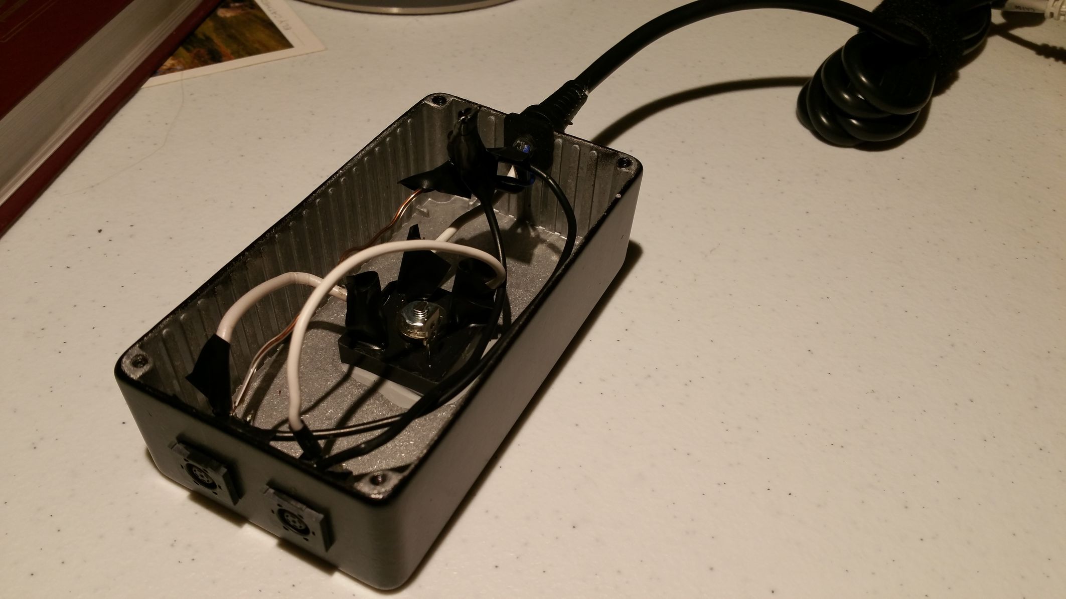

Steve135 24 Posted November 28, 2015 Here's some pics of my build. Unfortunately it doesn't let me pull anymore then about 360w. It may be because I used a different bridge rectifier (I used the 50A 1000V version). I'm getting the correct one from mouser and going to try it instead. The cable going to the computer was ripped from a much cheaper M15x PSU and fits in the M18x like a champ and the ID wire works perfectly. I'm not sure if this may be an issue as well or not.I'm using the power jack connections pictured in one of the posts above. Of note I initially tried out the mod with just one power adapter going through the power jack connections and tested performance. It does result in a slightly reduced performance when wired through a power jack connector as compared to plugged straight into the computer.With this current setup, even with 2 PSU's and overclocked cards, I actually get reduced performance from what I get with just a single PSU plugged straight into the laptop. The duel setup will only pull about 360w at any amount of decent overclock and simply crash. It is stable at higher clocks and voltages though as compared to just a single PSU. [MENTION=119]Mr. Fox[/MENTION] if you have any ideas I'm all ears otherwise I'll just see if swapping out the bridge rectifier will work.Adapter with just one PSU connected to test the power jack connection (caused slightly reduced performance as compared to plugged straight it)Final Result (setup maxed out at 360w and actually reduced performance as compared to a single PSU plugged straight in) Quote Share this post Link to post Share on other sites
Guest Posted November 28, 2015 Might be the bridge rectifier. The smaller capacity seems to do better for some reason. If using the one recommended does not work, then I'm not sure. I've built three of them and they all work good for me. Quote Share this post Link to post Share on other sites

Steve135 24 Posted November 28, 2015 Another thing I can think of is that the M15x power cord that runs to the laptop just has one white wire, whereas I believe the M18x cord has two (at least according to the pictures in [MENTION=119]Mr. Fox[/MENTION] 's guide). I don't know if this would make a difference or not since the power should all run through the center pin in the connector that plugs into the laptop either way.My plan so far it to first try the new bridge rectifier, if that doesn't work I may just bypass the bridge rectifier all together and see what happens, if that doesn't work I'm going to chop into my PSU cables and hard wire the whole thing. It may take me another week or so to find the time to do this but I'll let you guys know what happens. Quote Share this post Link to post Share on other sites
Steve135 24 Posted December 14, 2015 Update: I've just rewired my design using the correct bridge rectifier and still have no luck. For whatever reason, whatever overclock I place on my system, it will actually reduce the performance in 3DMark11. Additionally, I'm not able to pull more then 370W or so from my setup. I'm now wondering if it's something to do with the R1 circuitry as compared to the R2 which @Mr. Fox and most others use. I noticed in an earlier post that @Prodigal was going to try the mod with an R1 but didn't post any follow on comment as to whether this was successful. If anyone has successfully used this mod with an R1 I would be most interested to hear from them. Any other ideas from anybody on what might be the issue I'm all ears. Quote Share this post Link to post Share on other sites
