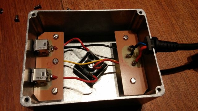

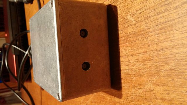

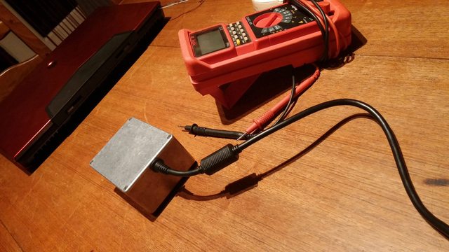

Guest Posted March 29, 2014 Share Posted March 29, 2014 Wow, that looks great. Nice job, Brother Riri-Fifi. I like the aluminum box. That would eliminate the need for a heat sink. Do you have information on the brand and part number for the box?I cannot see the ID cable in the photos. Is that the yellow wire? How did you attach the sockets to those boards? Epoxy, or solder to the prongs protruding through holes in boards? Quote Link to comment Share on other sites More sharing options...
Riri-Fifi Posted March 29, 2014 Share Posted March 29, 2014 Hi Mr Fox thx Concerning the box i bought it in France and don't know if you can find same on in US. ID cable is the yellow one indeed. Socket has been attached by soldering to the prongs protruding through holes in boards http://radiospares-fr.rs-online.com/web/p/usage-general/5173333/?searchTerm=517+3333&relevancy-data=636F3D3126696E3D4931384E525353746F636B4E756D6265724D504E266C753D656E266D6D3D6D61746368616C6C26706D3D5E5C647B337D5B5C732D2F255C2E2C5D5C647B332C347D2426706F3D313426736E3D592673743D52535F53544F434B5F4E554D4245522677633D4E4F4E45267573743D353137203333333326 1 Quote Link to comment Share on other sites More sharing options...
