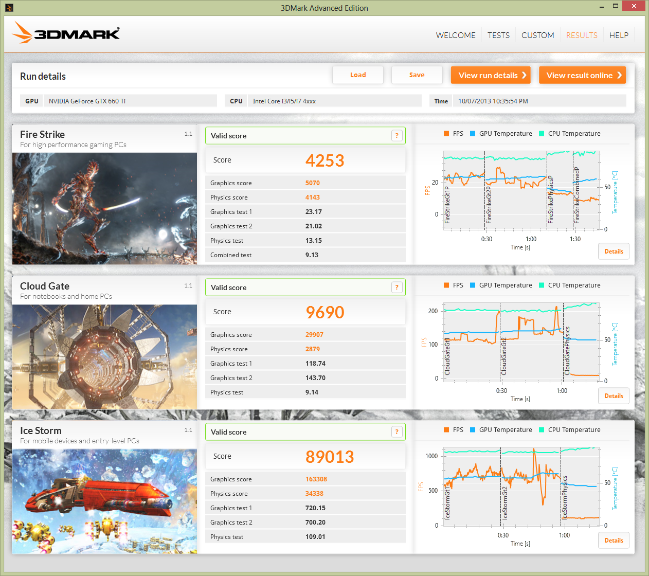

Just moved my old Windows 8 EFI (from my old mac built using my good'ol howto: http://forum.techinferno.com/diy-e-gpu-projects/2494-%5Bguide%5D-2012-11-macbook-air-11-gtx-660ti%40x2-2-win8-efi-th05.html) ... to the new one.
After a lengthy dd command and 5 minutes on the phone with MS re-activating windows, re-downloading the appropriate driver package from apple via the boot camp assistant in OSX, I found out that:
1. The SSD gives 710MByte/sec write speed and 730MByte/sec read spead (using black magic disk speed test on OSX). Holy cr@p. That's screaming fast.
2. Apple's main windows driver installer (that installs all other driver installers) doesn't work on win8-64/efi/mba2013. Have to install the individual drivers all one-by-one.
3. Intel HD5000 works (woo!)
4. The Cirrus Logic sound card works (woo!)
5. The bluetooth controller doesn't work and the bluetooth driver in the driver pack doesn't recognise the MBA2013 bluetooth chip. Meh.
6. The keyboard brightness and audio functions work! Yay.
7. Processor subscore went from 7.2 to 7.1 (that's the 1.7GHz haswell taking the place of the 2.0GHz ivy bridge from last year). A bit slower. Pretty much everything else is faster. Primary hard disk got 8.2.
8. Neither 3DMark nor 3DMark11 agreed to run in 64-bit mode. Both ran in 32-bit mode.
9. 3DMark11 gave the 2013 1.7ghz i7 haswell a score of P5690. Contrast with the 2012 2.0ghz i7 ivy bridge that got P5802. This year's is a little bit slower.
10. 3DMark: post-7708-1449499568029_thumb.png
