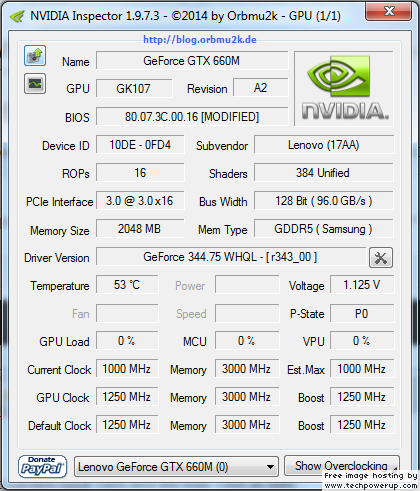

crazydawid 10 Posted November 23, 2014 Download Link :- "http://www.uploadmb.com/dw.php?id=1372379820" <----------- This Is '1.125V' For svl7's Unlocked 2.07 BiosHello!I used this bios on v2,07 and i have problem.Its showing default clock at 1250 and memory at 3000 but current clock 1000 and est max 1000 as wellWhat to do? Quote Share this post Link to post Share on other sites

romasik 10 Posted April 27, 2015 Hello!I used this bios on v2,07 and i have problem.Its showing default clock at 1250 and memory at 3000 but current clock 1000 and est max 1000 as wellWhat to do?[ATTACH=CONFIG]13226[/ATTACH]Hello i have same problem? how solution this ???? Quote Share this post Link to post Share on other sites

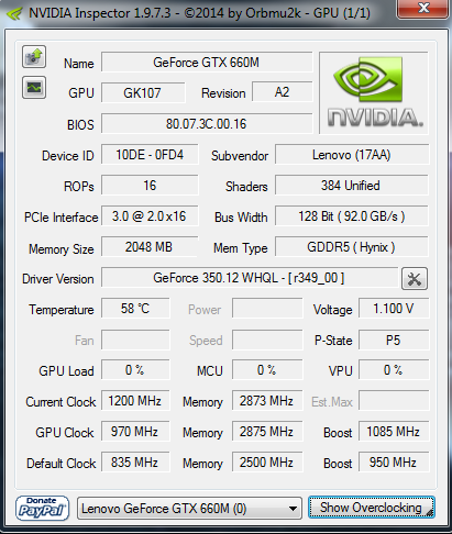

mangoost 10 Posted April 29, 2015 Hi, i've boosted my video card to this settings thru nvidiainspector as it shown at the pic. Do i need to up voltage??? Quote Share this post Link to post Share on other sites
