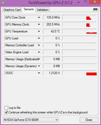

ErYani, why voltage 1.2120V instead of 1.2500V? :([ATTACH=CONFIG]8258[/ATTACH]
Maximum Voltage Is V.12120V :( , If U Go Over That Big Risk You Destroy Your GPU :( , Sry Mate

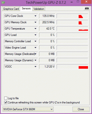

Repasted, currently not using HHD and DVD bay so both areas are empty so allows for slightly better airflow. I use two coolers (long story) and sits next to my window where its cold. Max temps are 74-76 under normal conditions. ill post a gpu z screenshot after an hr of skyrim or something later
EDIT: After 2 hrs of dota 2:
EDIT 2: After ~hr of skyrim
That's nice! Well guess I could remove the DVD but it's a bit dusty here so probably not the best idea for me.
I want to repaste and did some research on it. But some said if overheating is not a problem and you are not confident, better keep it that way :P
Well I guess it's a great improvement already. Btw as expected, the battery life drop a bit but I guess that's not a bad tradeoff
