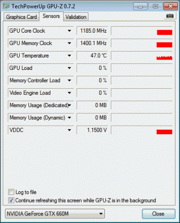

I Finally Managed To Increase The Voltage For Y580 GPU "GTX 660M"
Download Link :- "http://www.uploadmb.com/dw.php?id=1372379820" <----------- This Is '1.125V'
"Request Any Voltage And I Will PM It To You , Thanks To @schranzmaster @jester_socom

big thanks man! :)
Edit: [ATTACH=CONFIG]8014[/ATTACH] 1,15 V works..
but the 1,175 V - mod doesn't work... :/

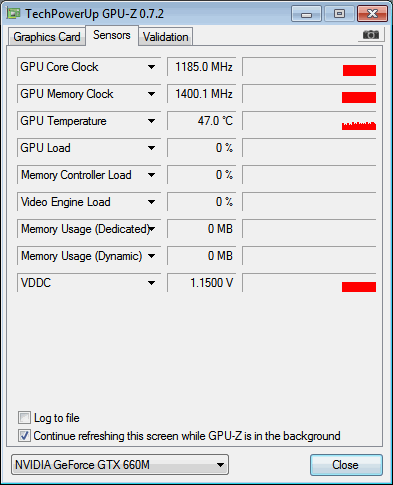

Here Is Another Link After Fix =) UploadMB.com
Proof :- post-10506-14494995613821_thumb.gif
P.S:- Be Careful It May Become So Hot =))

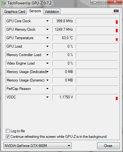

here it is. v8.00 with 1,175 V overvolt.

Y580_v8.00 (5DCN90WW)_660mGHzEdition_OV-1,175V.zip
I flash my bios with the v8.00 1.17v and the temperatures saws, is it possible for you all to find the best voltage and best overclock settings?

what is your current overclock an temperature with the overvolt?
Edit: for some people 1,125 V may be great for stable 1300 mhz on core, for some others 1,175 V. thats because of the chip-quality... the lucky people have a great one
2800 mhz on memory should be fine.
