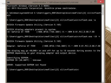

Hi, i have this same error like deli_gt.
You can see it on screenshot.
is there a safe way to flash this or to awoid this error?
I have lenovo y510p and now im trying to flash first GF on it.post-29434-14494998350069_thumb.png
