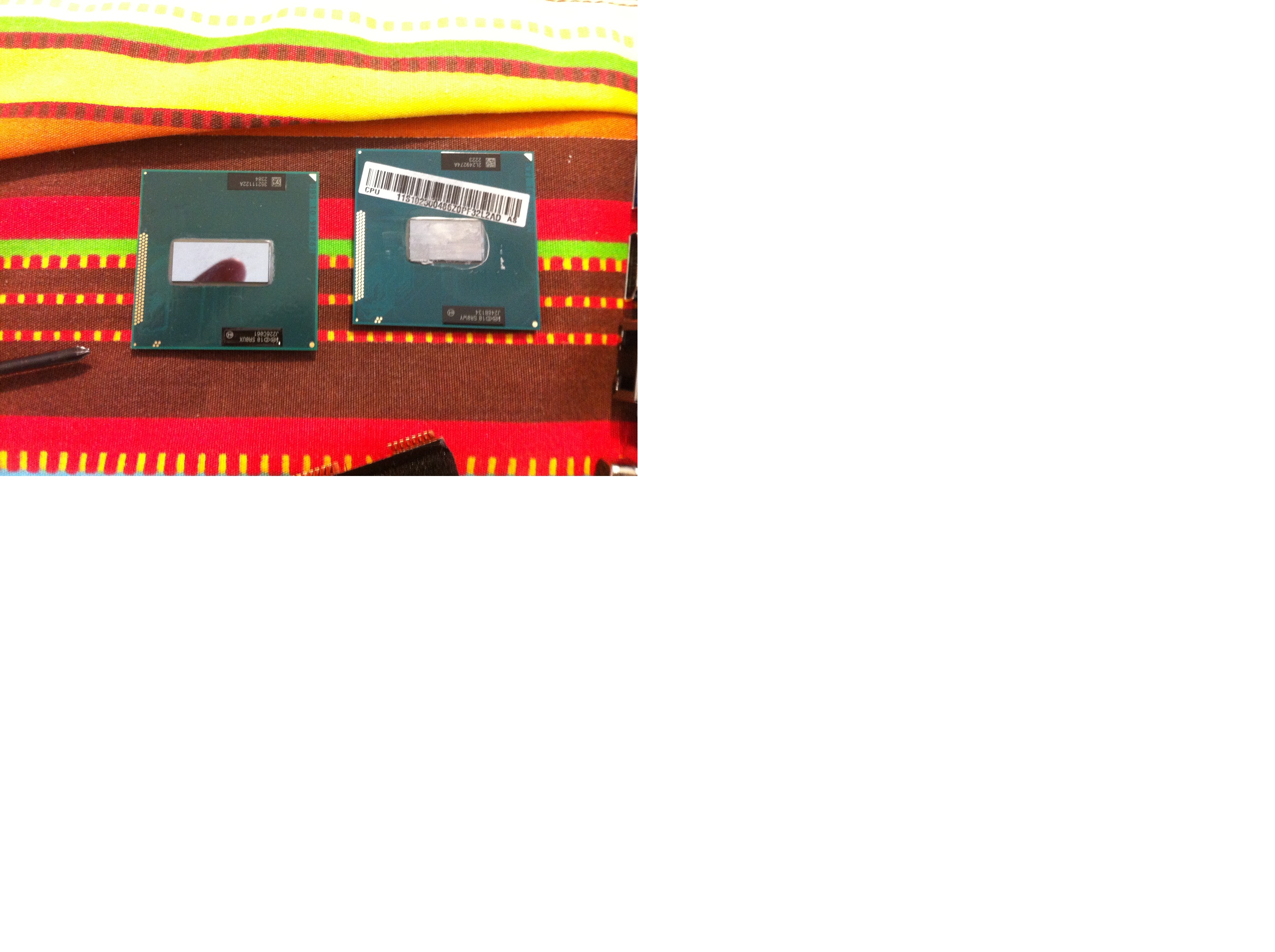

boloheadrat 10 Posted June 15, 2013 I don't use the laptop too much, so I didn't notice a difference in day to day, but I did get a pretty big bump in my physics scores in 3dmark 11. It went from high 3000's to mid 7000's. Something I thought was kinda was the difference in die size: Quote Share this post Link to post Share on other sites

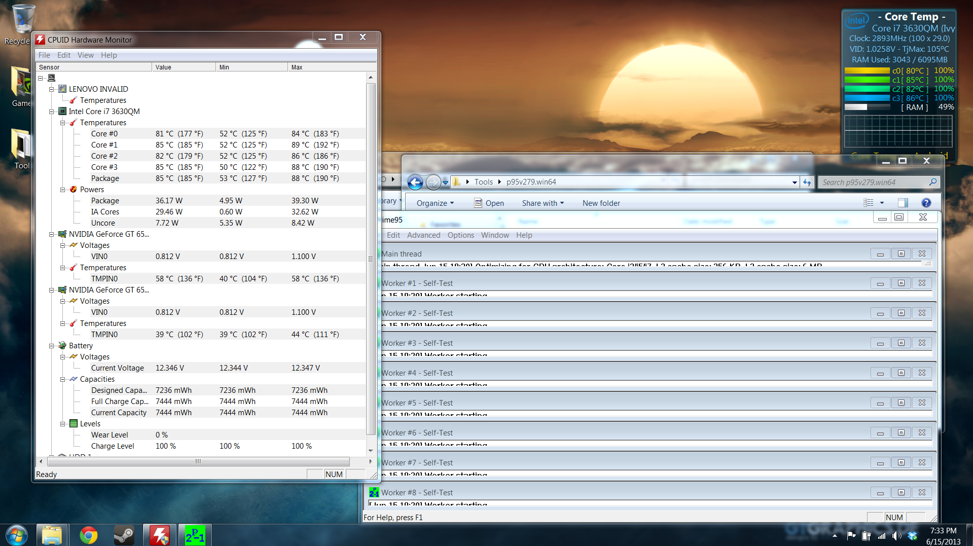

boloheadrat 10 Posted June 16, 2013 Heres a shot of HWM and Prime. If core temp is correct, then the multiplier is stuck at 29. I tried to increase it via throttle stop, but it didn't seem to make a difference. Quote Share this post Link to post Share on other sites

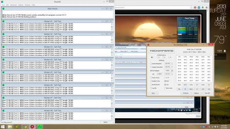

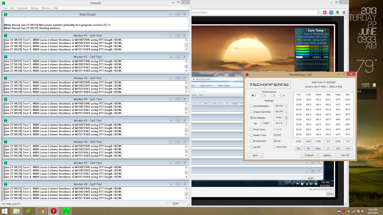

n1smo 39 Posted June 22, 2013 Heres a shot of HWM and Prime. If core temp is correct, then the multiplier is stuck at 29. I tried to increase it via throttle stop, but it didn't seem to make a difference.[ATTACH=CONFIG]7854[/ATTACH]Probably because the motherboard is not putting out 45w. Here's my 3632QM for comparison. Identical basically. Quote Share this post Link to post Share on other sites
