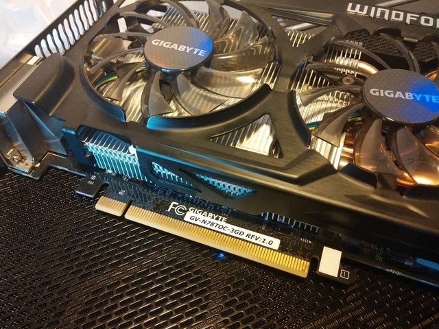

hello Svl7 I love your work and managed to duplicate most of it through trial and error for my pair of 680's (disabled boost 1.0) and just recently did my Gigabyte 780TI (b1 revision your 780 TI bios wouldn't post) I was hoping you could clear up a few things.
It seems to be if you lock your P0 voltage the same as the clock speed you are using from the boost table (say 1.1v and then set the max voltage on table entry 36 to 1.1v) the voltage will be one stage higher (1.11v) I have found just setting the voltages in the boost table to be LESS than P0 makes the P0 voltage just override it completely for complete control. have you found the same?
Also the one thing I would love to do is edit the fan speed table, not just uncap it, and I have yet to find a way to do so, I'd like it that my fans hit 100% at 80c for max cooling, if you have any insight on how to do that it would be fantastic.
I would also be happy to post my GB 780 TI bios that I modified, (ver 80.80.34.00.3E) and we could add my 680 GTX bioses to the list if you like as well (they were reference boards and I would have to remove my custom clocks but that is trivial).
