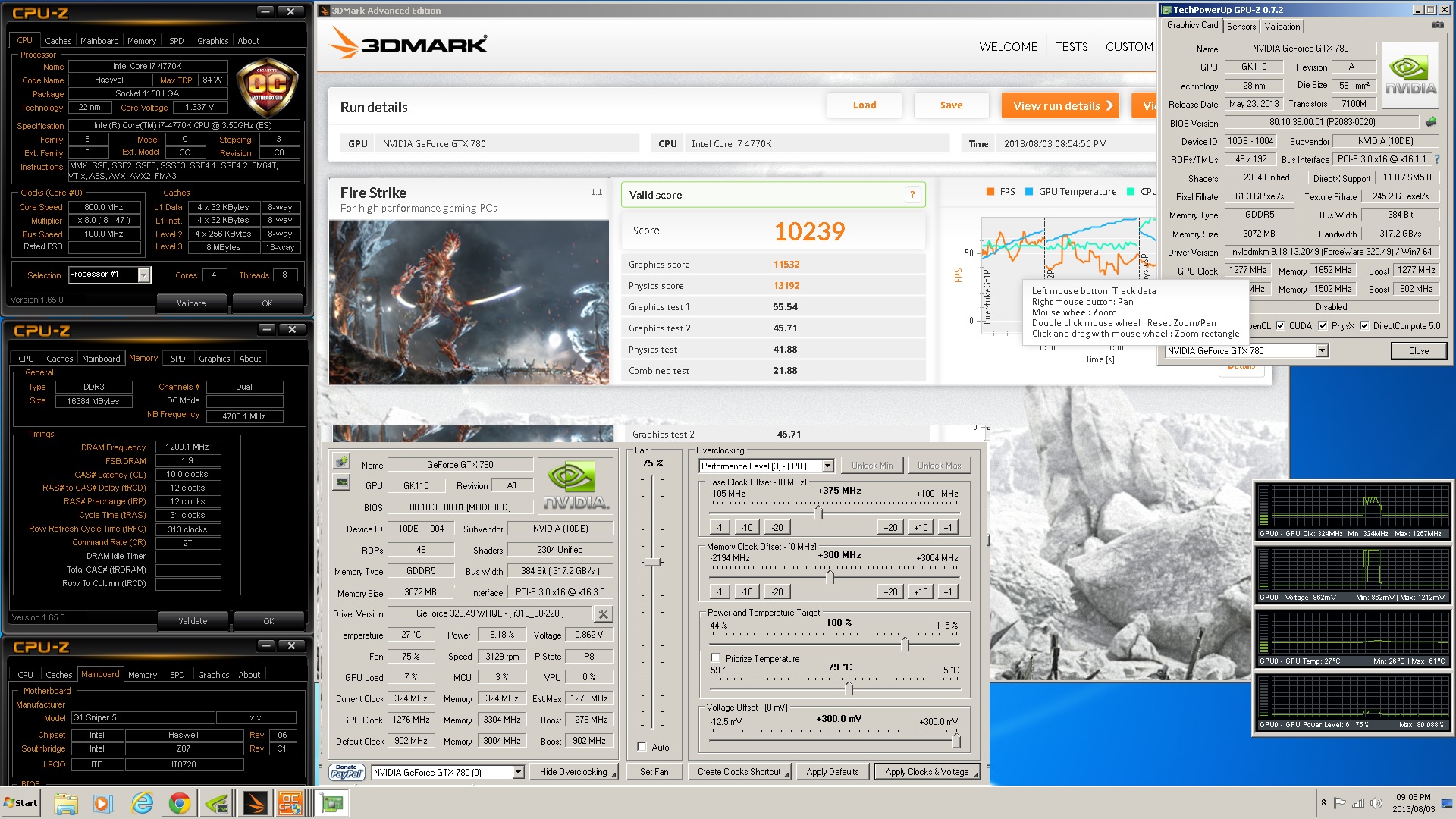

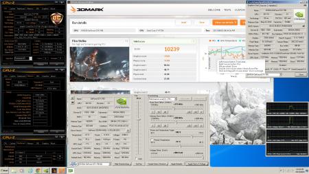

pharma 13 Posted August 4, 2013 @svl7,Thought you would like to see 780 Classified results using Svl7 TI Classified bios - Nothing extreme yet i7 3960x @ 4.9Ghz --- GTX 780 Classified --- 1306.5/7718 --- +274/+855 --- P11349 --- Air ASIC 67.1 Nvidia Driver 326.41Power Target: 95%Temp Target: 94chttp://www.3dmark.com/fs/726888 Thanks again for your work and solutions with evga Modded vbios. 1 Quote Share this post Link to post Share on other sites
