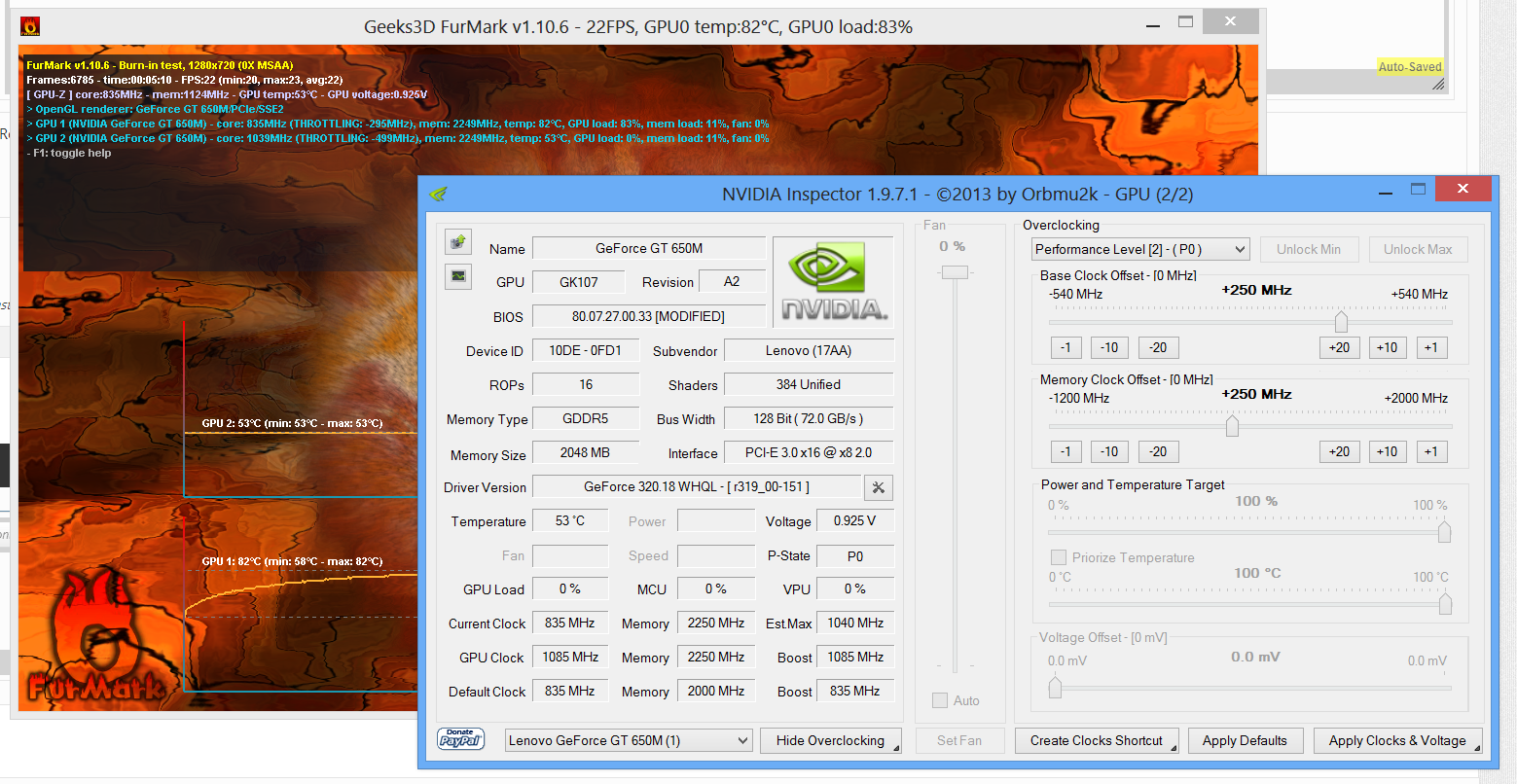

I've probably missed something small-but-significant, but here goes: I attempt to flash my onboard 650M that's already been worked over with a fixed 2.02 BIOS flash with an overvolting BIOS, and nvflash screams "Supported EEPROM not found". Can I presume I've inadvertently haven't done something I've assumed I've done?
A late addition: I've just also noticed that the NVIDIA Inspector won't touch the onboard GPU's clocks either - in fact, it can't read much off it; note how a temperature of a constant 53 degrees is recorded, even on a FurMark burnin.
[ATTACH=CONFIG]7899[/ATTACH]
Furmark doesn't support SLI currently. What you are seeing is your ultrabay sitting idle at 53c.
You're entirely right: I run Unigine Heaven, and clocks scale up as expected. So it turns out to be an entirely different issue - sorry for wasting time with the false association.
So I should come clear with the actual question: how do I flash the separate VBIOSes here onto the MB's 650M? jester_socom's original post links me to svl7's sticky, but he only provides BIOSes with modded VBIOSes already included - the only instruction I get wrt VBIOSes modded separately is to use nvflash, but since that isn't working I presume that's not what I'm supposed to do.

I think I'm going to go back to the SVL7 unlocked BIOS without the voltage mod. For whatever reason, my system is very unstable (the BSOD on waking/shutting down problem) whenever I have the card overclocked, no matter how tame the clocks are (even at 1100 Mhz, stable on stock voltage). I'm assuming this has something to do with the card not liking operating at 1.1V, ot just something else in the BIOS...
The modded BIOS already includes the modded vBIOS for the main GPU. If you have SLI you need to flash the vBIOS of the Ultrabay GPU separately using NVFLASH. All instructions and files are in svl7's sticky. Read it carefully.
