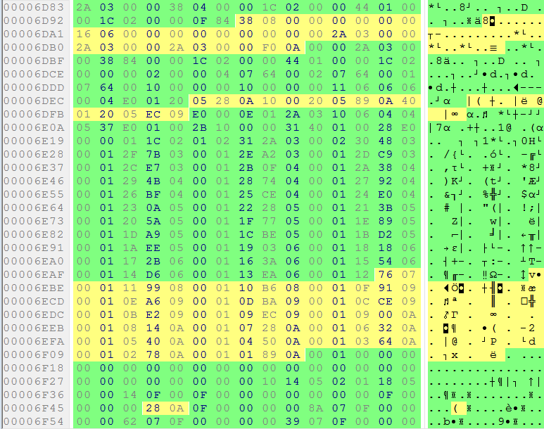

at first you have to find the lines in the vBIOS for the clock-table...
this is how it looks like in the vBIOS of my GTX 660m
e.g. the lines with the yellow backround are the ones i had to change for overclocking...
as you can see, is ''28 0A'' my new core clock. 1300 mhz.
damn, i needed so much time to find that out :D
*and no, you can't change the clocks with the Kepler BIOS tweaker, sadly...
because it doesn't take effect to the clock table... and you only can change the clocks of the new kepler's by changing the clock table
