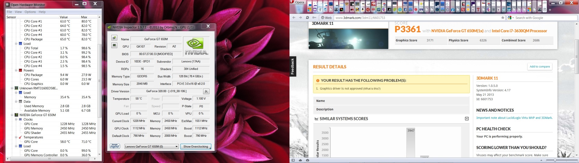

Watch out though with ocing. At 1100mhz core and 2500 memory im already using 150w from the wall at peak moments with my i5- 3210m running prime 95 at the same time. Most of the time i sit around 110-120 w

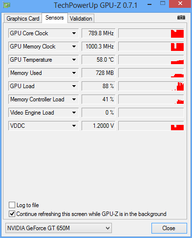

Stock VBIOS has max load temps of 60C on my machine. With the 1.1v mod i get about 80C with the new max overclock.
What I am saying is let's overclock further with the unlocked vbios, but let's play safer with a lower voltage.
For the extreme people wanting to do extreme benchmarks the 1.2v should come in handy.
