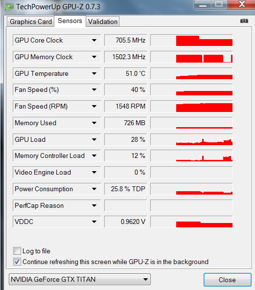

Hi, I have a Zotac Titan "AMP!" edition and have just followed the procedure to flash it with the v3. vbios, but have not noticed any effect on the clock scaling. It's as though the BOOST functionality is still active.
My default clocks, as reported in GPU-Z seem correct (and infact have changed from the original vbios), but in the "Sensors" tab the clock regularly drops to lower values, as in the screenshots below.
Has anyone else noticed this? Is there some step that I'm missing?
[ATTACH=CONFIG]9334[/ATTACH][ATTACH=CONFIG]9335[/ATTACH]
EDIT: So I just re-read the entire thread and thought I would add some clarification: The clock throttling I'm seeing is not only related to 324MHz as in the above image (which I now understand is the idle clock). My problem is that I regularly see clocks around 600MHz / 700MHz while gaming... which is essentially the same behaviour as before the bios flash (though the numbers are different, I assume because my original vbios had different max clocks?).

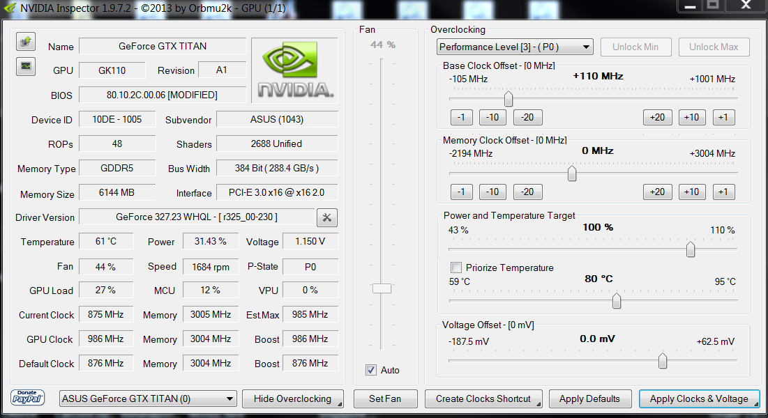

No! I hadn't! Thank you very much! Now using the v3. bios I have a constant clock of 875MHz at all times. Great.
My question now is: why do the clocks behave differently when running, for example, the GPU-Z render test vs. a "normal" game? Is there maybe some dependancy on the GPU Load?
For example, whenever the render test is running, I can overclock just fine using the nVidia Inspector "Base Clock Offset", and my I see Current Clock = GPU Clock, but whenever I'm running a game, the Current Clock just stays at 875MHz (see image below). Is there any way to set a absolute clock speed and have the GPU use that at all times?
