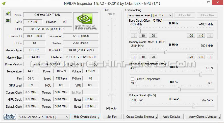

svl7 Posted July 26, 2013 Author Share Posted July 26, 2013 Haven't been visiting this thread in a while... what did I miss? Just added rev03 of the 'OC edition' to the first post. It corrects the slider so the default reading is the actual 3d voltage and added undervolting capabilities, meaning you can now lower the voltage per slider, see the following pic: 5 Quote Link to comment Share on other sites More sharing options...

OdrzutoweWrotki Posted July 30, 2013 Share Posted July 30, 2013 OK.Uploaded.Etc.Not SC.Normal 02 version.Power throttle increased to 110 %.ASUS GTX.What is strange.That of course I can set higher CPU CLOCK and MEMORY CLOCKbut.... scores in 3D Mark are lower.So i move them in Nvidia Inscpector higher (than before).And receive the same score :Around 5900 what I receive with oryginal BIOS from ASUS.With Throttle 106 %.Strange.I am stuck. Quote Link to comment Share on other sites More sharing options...

OdrzutoweWrotki Posted July 31, 2013 Share Posted July 31, 2013 He is using a bios with gpu boost, so his max clock is way higher than yours.His Titan clocked at 1320/1750 mhz. Look at GPU-Z parameters. GPU & MEMORY Lower than main.(BOOST only 4 points higher,means nothing 1146 vs 1150) And clocking memory doesnt give me anything. Clockin and Clockin.no progress. Bios of SVL is great... BUT as I wrote,the same scores with lower GPU and Memory settings I received on genuine Asus Bios. But why ? I do not understand it. It loooks like some terrible dream PS.Look for example for next guy. High lower parameter than main and score higher. http://img38.imageshack.us/img38/8813/t90u.jpg http://hwbot.org/submission/2388573_mrtooshort_3dmark11___extreme_geforce_gtx_titan_6409_marks Only SVL can explain that OR/OR CPU from 4.53 to 5.00 gives so high BOOST to 3DMark score EXTREME TEST. But : 5800 to 6500 3d scores ? of CPU ? I dint receive any progres after i passed with my Haswell 4.3. Or this is it ? And I shall try go to 5Ghz ? Quote Link to comment Share on other sites More sharing options...
