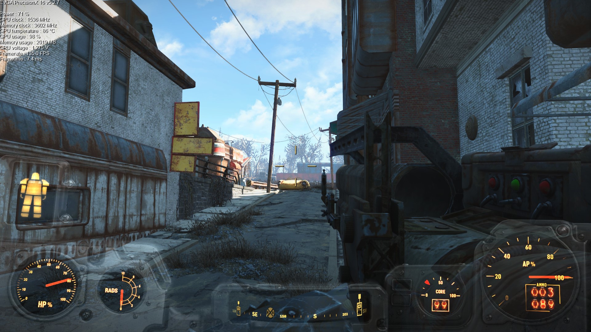

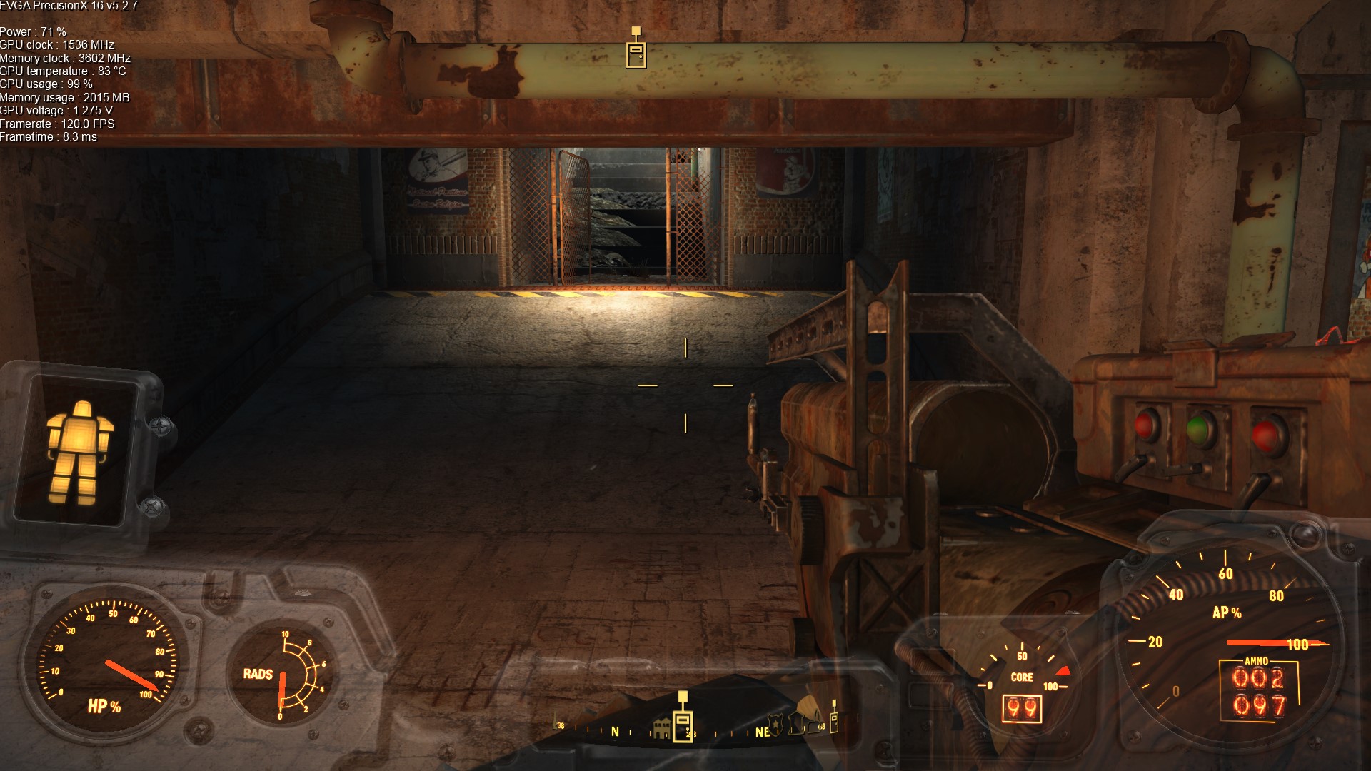

Pretty warm, but was able to game at 1536/3600 or 7.2 ghz. Single card
Edit: Fallout 4.
Edited by johnksss
What game is that? I don't recognize the environment. Fallout 4?

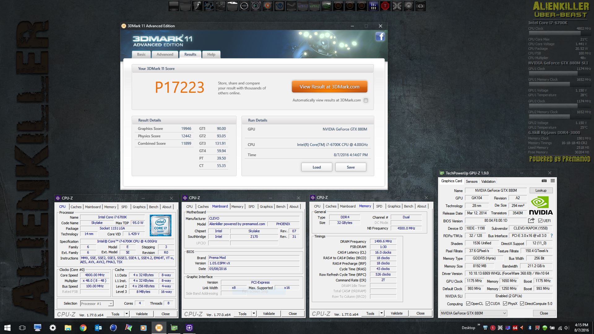

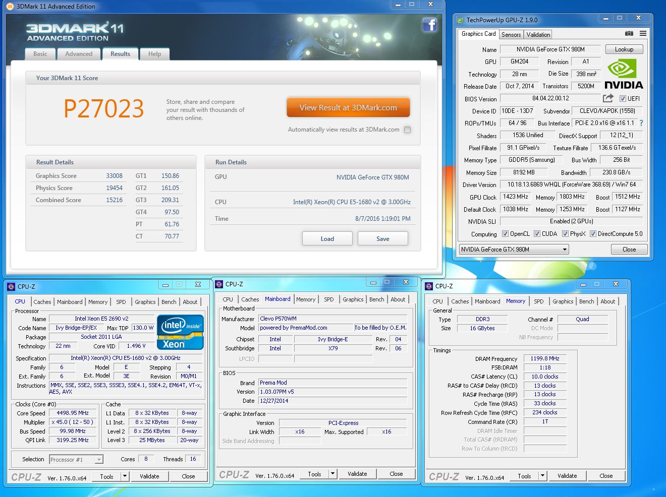

Here is the highest recorded 880M SLI score for 3DMark 11 on a laptop with a quad core... It is not many points behind the highest score recorded by a P570WM with 4930K CPU.
http://www.3dmark.com/3dm11/11477144

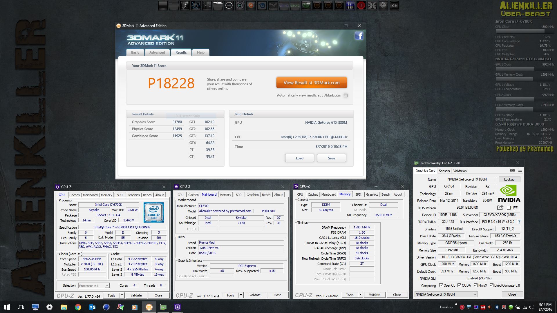

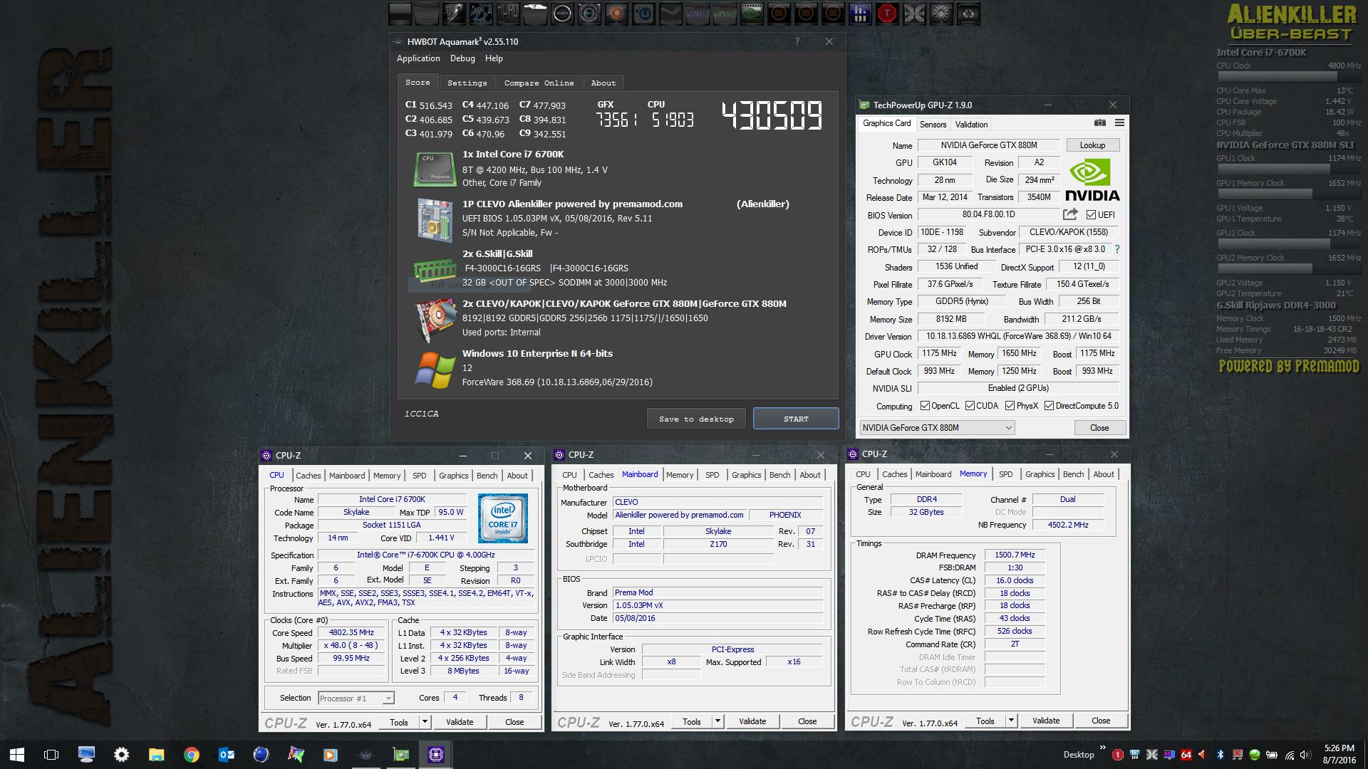

Here's a new 880M SLI world record for Fire Strike. Once 3DMark adds the hardware ID (requested) the score will be validated with the GPUs recognized.
http://www.3dmark.com/fs/9676618
[IMG]

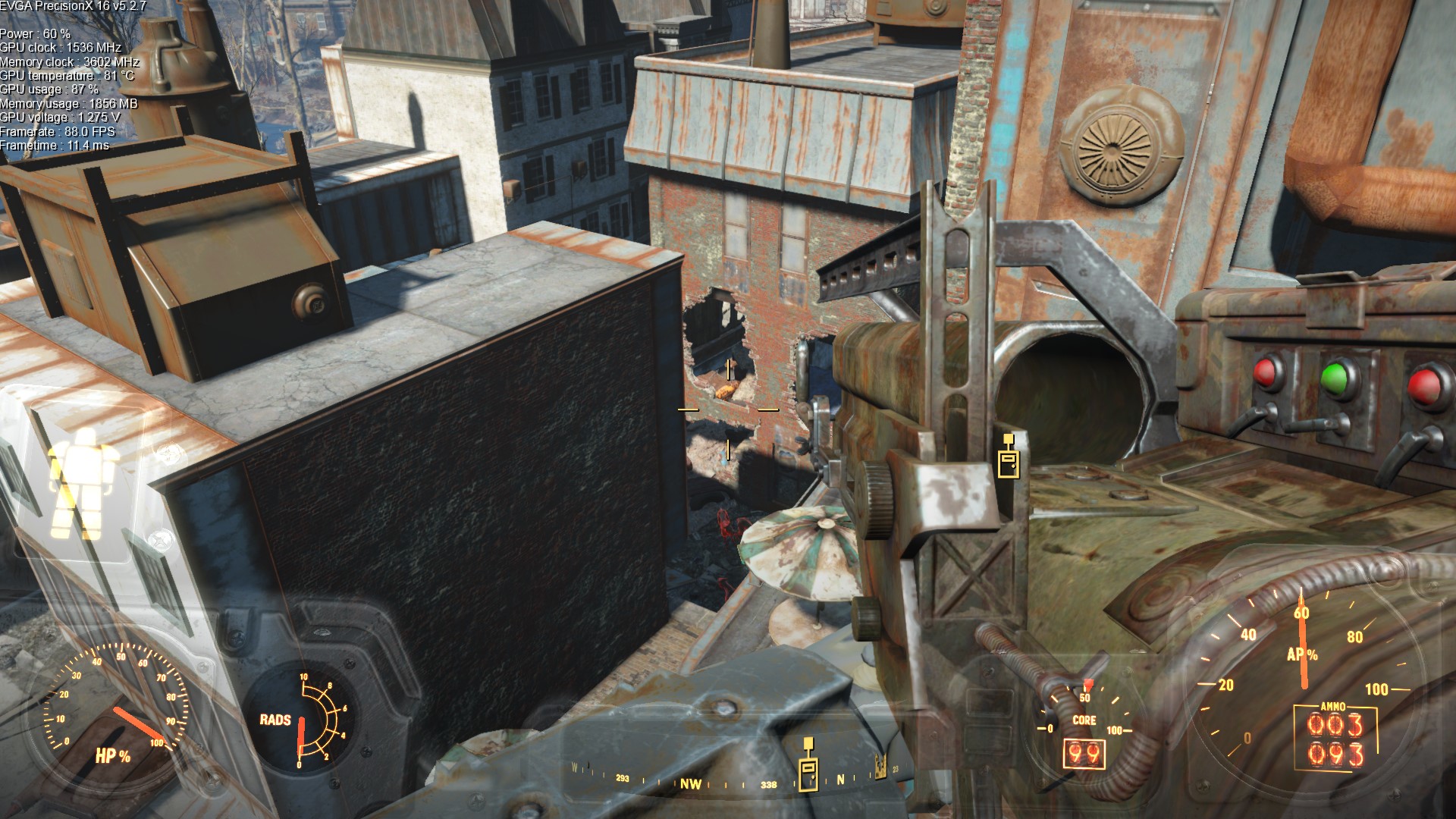

I posted gaming benchmarks a few post earlier. I was playing at Fallout 4 @1.536ghz / 1.8ghz overclock on 6ghz rated memory.
It seems to be somewhat less under windows 7 though. 1.5ghz / 1.753ghz.

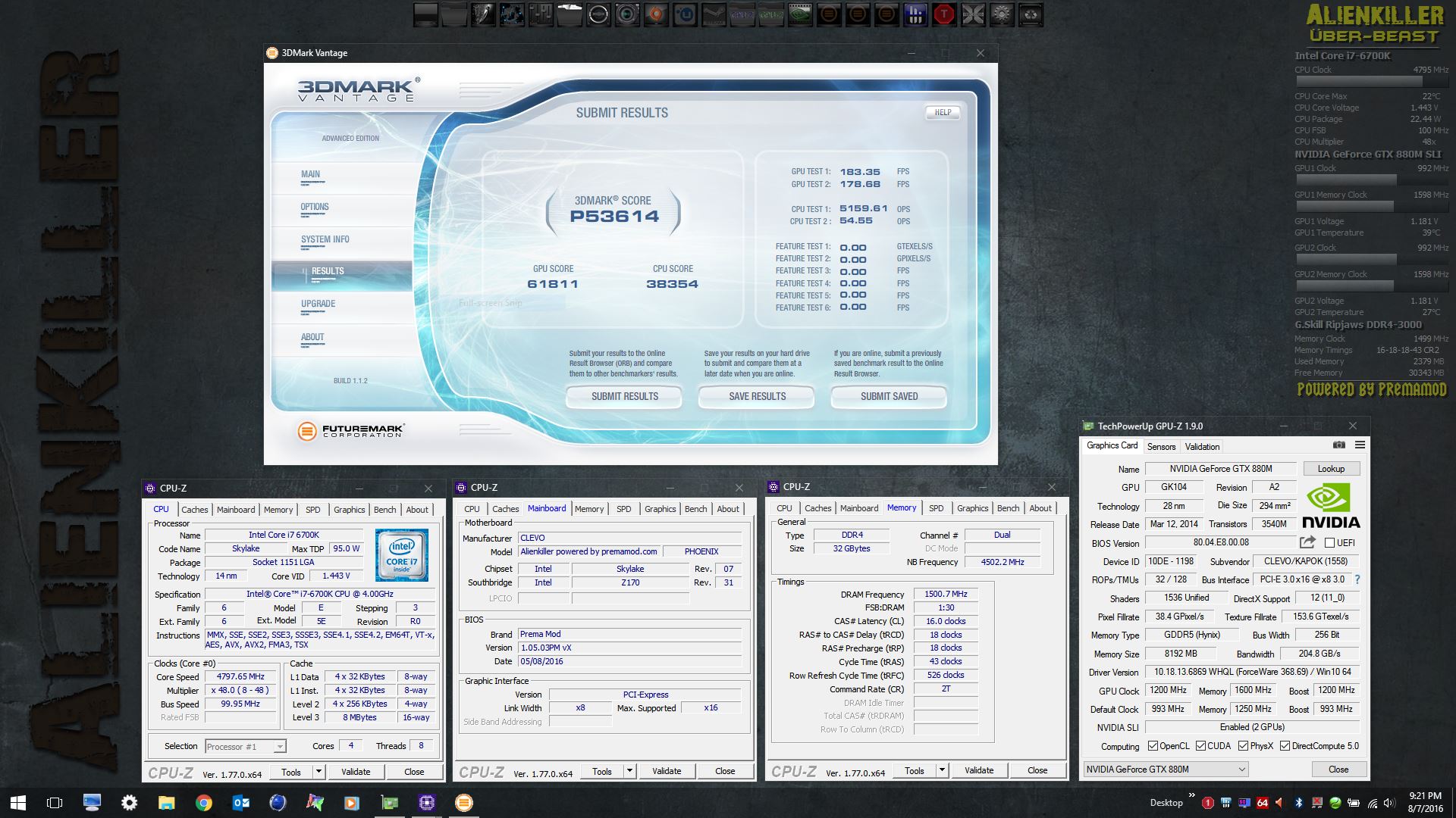

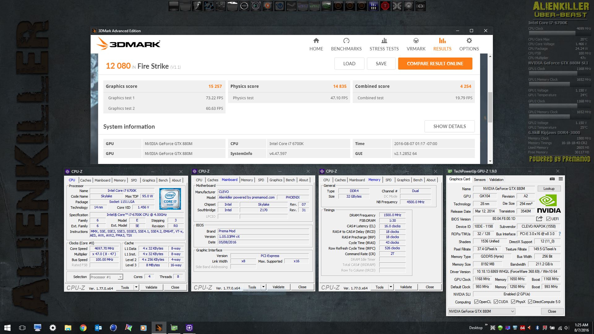

OK, just took first place on Fire Strike, 3DMark 11 and Vantage for 880M SLI... These comparisons are against current first place scores. Once 3DMark adds my hardware ID these will show in search results and displace the guys currently in the #1 spot to the #2 and #3 spots based on what I have uploaded today.
http://www.3dmark.com/compare/fs/2402025/fs/9686855
http://www.3dmark.com/compare/3dm11/8510683/3dm11/11477498
http://www.3dmark.com/compare/3dmv/5067708/3dmv/5494902
