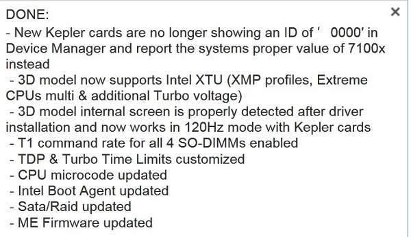

You need to use Intel XTU Utility. It will allow the multi for your CPU to be raised by 4.

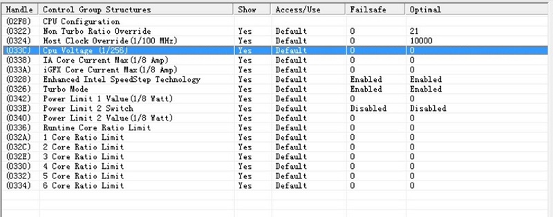

Will Cpu Voltage (1/256), how to set? Set how much?
Don't do that in BIOS use XTU

Yes most of those EM tweaks will be part of the HM versions and then some 'real hacks'... ;)

Perma could you enable XTU on a p150em bios keeping the P150EM EC and ill test for you please?

So I used Intel XTU and pushed everything up 4 - everything seems smooth as butter. Hottest temp I have seen with benchmarks or stress tests is about 79C. So that seems great! Thanks Prema! But I have more questons! And don't worry, I will send some beer change your way soon! Just waiting on PayPal to correct an eBay issue - the ticket got closed today so I should be set soon =)
Anyway, the values don't seem to be loaded on startup and I see no option to set that. With it running at that temp, I feel safe keeping it there. So is there a way to load the OC values on boot?
