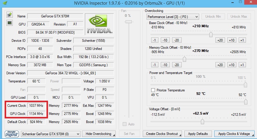

Hi to everyone!
I got a small problem with the overclocking my GTX 970M 3GB . I have a Clevo P670SE and I wish to raise the GPU and Memory clocks. I am using P6xxSE Prema Mod v2 for both BIOS and vBIOS.
I use EVGA Precision and NVIDIA inspector software for overclocking. The thing is that I am able to overclock the memory, raise the core voltage but can't go with the core clock higher that 1037 Mhz (Boost clock). You can see it here below on the picture. GPU clock is set to be: 1134 Mhz (+210 Mhz) but Current Clock is blocked to be only 1037 Mhz. The memory offset works fine (+270 Mhz) and the voltage raised from 987 mV to 1050 mV.
Any ideas how to unlock the core clock offset? I attached my vBios back up down near written with red letters.
Thanks you very much in advance.
Brgds.
@bartolini9
Just run on AC Adapter and set your system power plan to "performance" in Clevo Control Center and/or Windows power options.
31 minutes ago, Prema said:
@bartolini9
Just run on AXC Adapter and set your system power plan to "performance" in Clevo Control Center and/or Windows power options.
  hi prema. there bother bios life for this model that I have? W650SF?
Yeeeh. It works. I had AC adapter plugged in and power plan set to performance. The thing was that when I started the game or 3d Mark, the current clock immediately went up to 1134 and then to 1248 (Boost) like it should be. So everything works and it's unclocked. Thanks Prema for your BIOS :)
Brgds.
