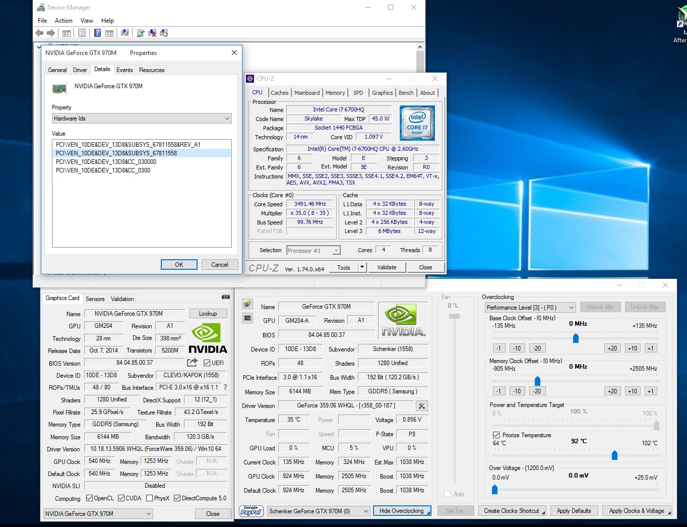

Thanks for the info... Oh  by the way this is how I manage to update the vbios of my 970m to your vbios by using svl7 procedure
- Disable 970m under device manager
- Use command prompt with administrative priviledges
- use Mnvflash (under windows) and input the following command:
   ex: c:\mnvflash -6 bios.rom (where "bios.rom" is your vbios filename)
I did this procedure because the "Modme.bat" is not executing the way it should be. Maybe because MSI is not officially listed in your thread and is not compatible with the batch file that's why I use "Mnvfalsh" of svl7 and it did work flawlessly. Or you can stick this procedure on the first page if you want to thanks.
Edited by omega939
You only have to make sure the nvidia GPU is actualy active and not only the Intel GPU. Simply opening GPU-Z is enough to activate it.
Also no need to manually deactivate and reactivate the driver, it's all automatic...

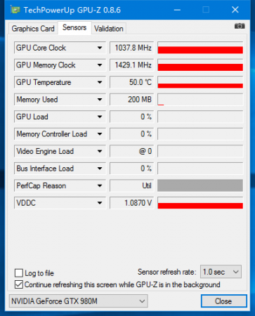

My 980m-g has ASCI 68.7% if I want to OC +150 for core and +350 for vram, what voltage should I set? keep 1.062v or add?

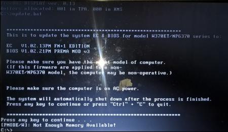

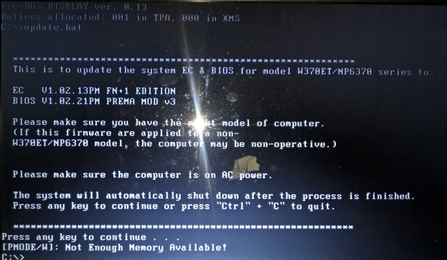

Hi Prema,
Question. I have a non clevo nb. If it's ok to post here since you're active on this thread though... Is it possible to mod the bios of my MSI GT60-ONC ivy bridge to read mxm gpu up to 9xxm Maxwell cards without modding ".inf" of Nvidia drivers? Plug and Play just like clevo nb? If yes I can post my bios file here and of course a donation.. Thanks :)
