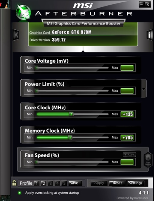

Thanks for your hard work PREMA, flashed the vBIOS for my 970M GTX 6GB working great!
I had a problem at first when I installed the 361.43 drivers, which they gave me a BSOD straight away, had to install the previous one 359.06, now everything is working fine so far.
Donation done! ;)
Edited by yukinok25
Yes, those Mods are for all DM-G model GPUs. ENJOY! :)
Will sort and upload everything here on the new TI in the NY...
Just make sure not to use 361.xx driver as they broke support for older vBIOS (which most Mods are still based on).
Mod or stock doesn't matter in this case, the driver bug effects both...just use 359 driver until they get it fixed.
