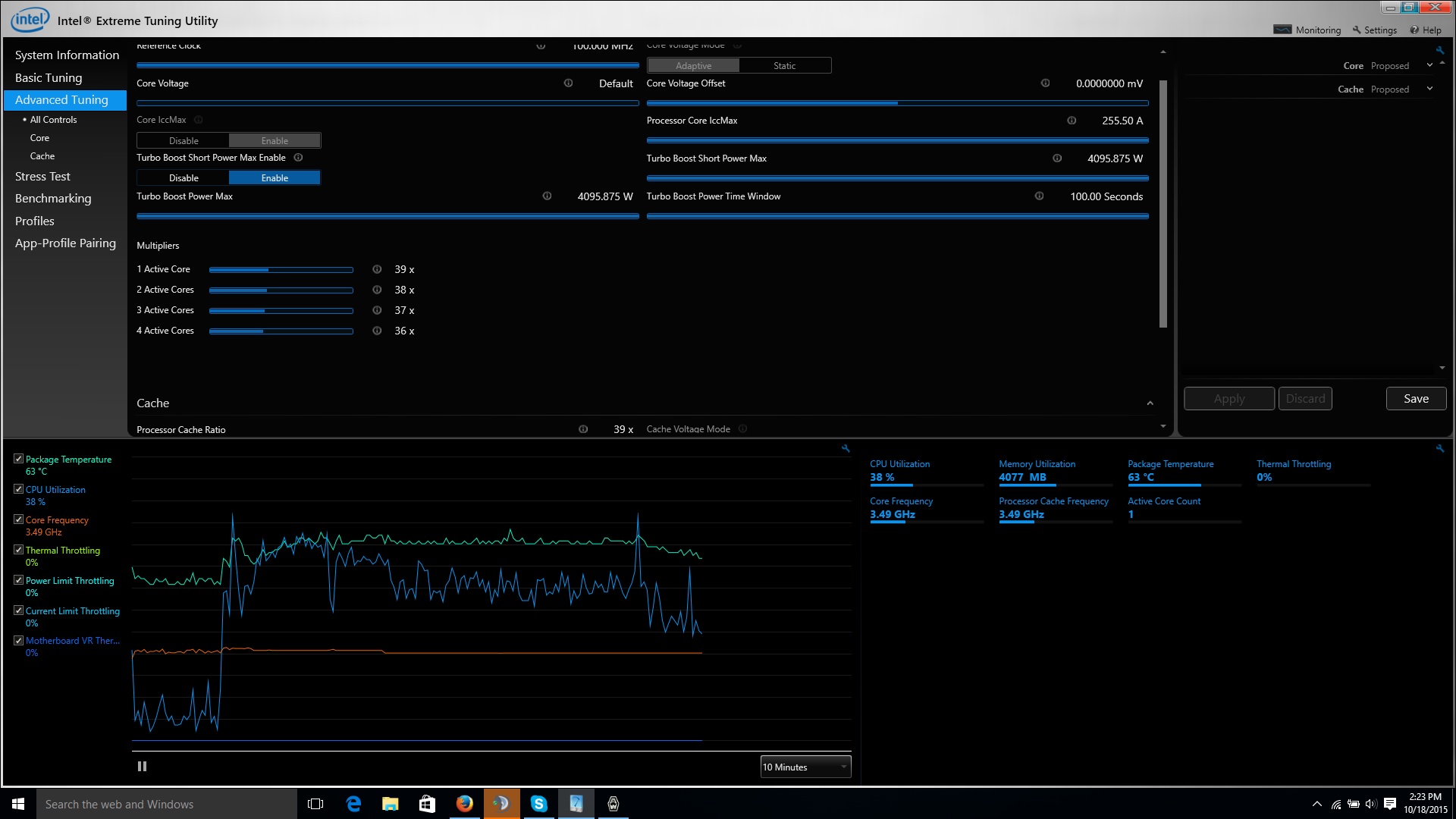

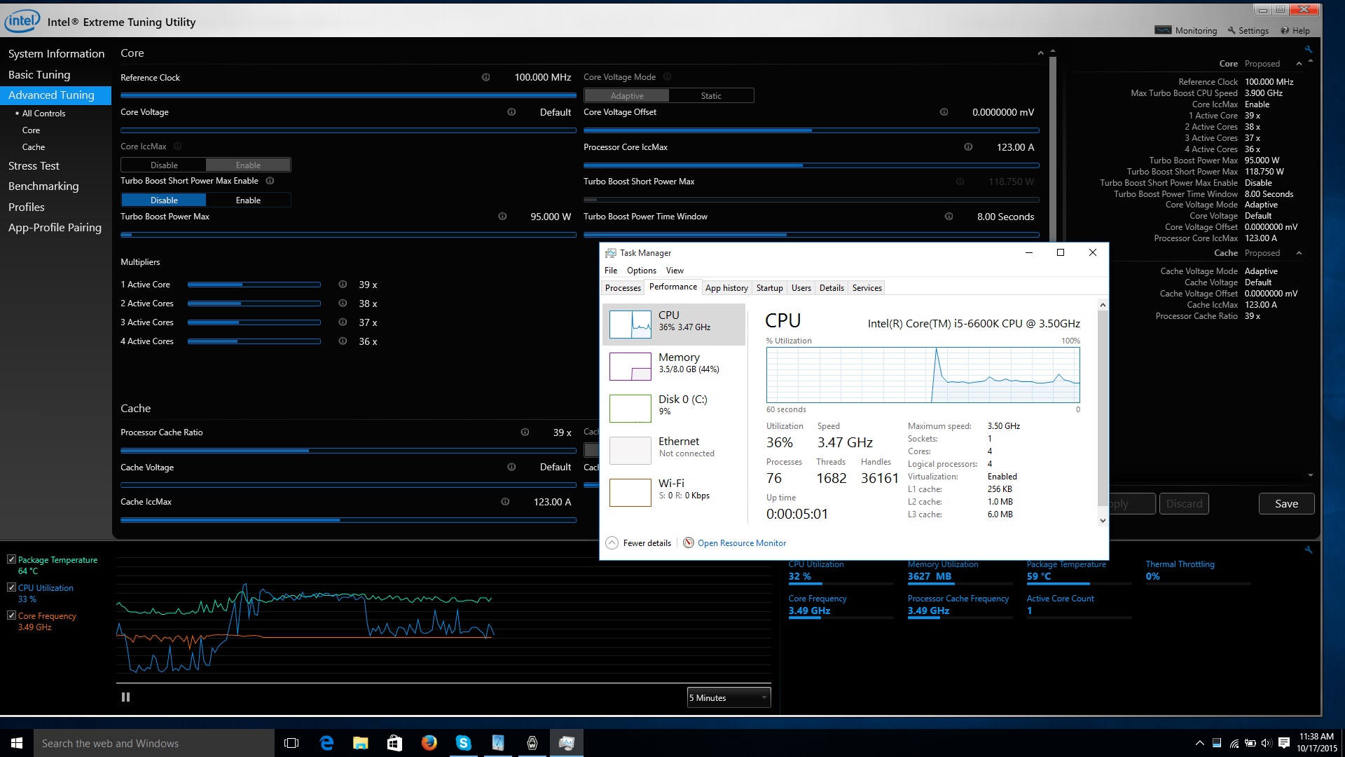

hi can you please upload latest stock P751DM-G bios
hi, I just bought P751DM-G with i5 6600k and gtx980m, bios version is 1.05.01 please help as cpu turbo boost deactivates in games and cpu stays at constant 3.47ghz(value in task manager) until i reset laptop or put it in sleep mode and back. I've read its an early bios issue, can you please advice where I can download latest bios. thank you in advance
HERE
thank you
, just updated to this version but unfortunatelly it didn't change anything, turbo boost deactivates and locks at 3.47 as before, cant even run it stock. temperatures are fine tho. found this review , they said that latest bios solves this issue but just updated it tested and its same.. im hopeless atm. :(
Schenker XMG U506 (Clevo P751DM) Notebook Review - NotebookCheck.net Reviews
in comments they said its solved , maybe they were using different bios version, who knows...
thank you
Uninstall Clevo Hot Key App, see if that helps.
hi, i did but no effect, here's a screenshot of xtu where you can see how cpu behaves after turning on laptop and starting a game, turbo boost goes above 3.49ghz and then after couple of seconds locks at 3.49 and stays like that...post-39935-1449500092922_thumb.jpg
