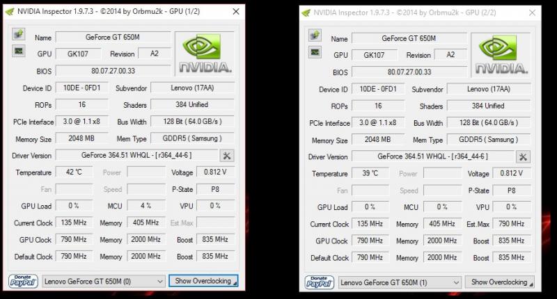

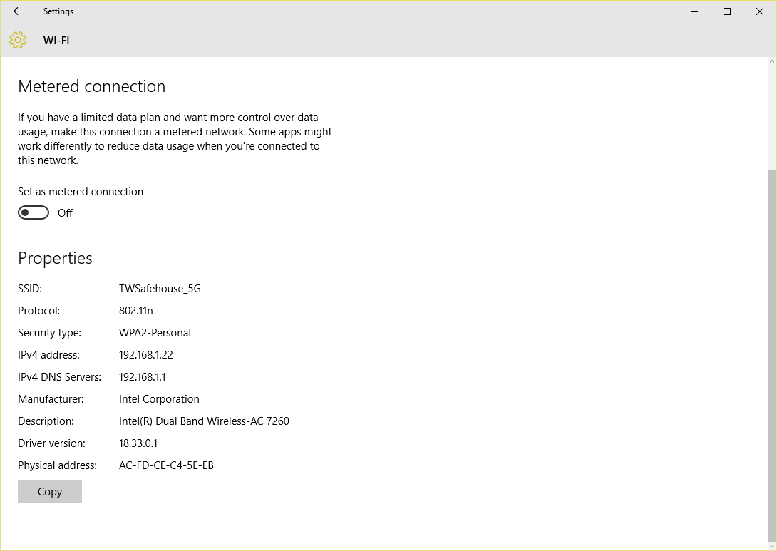

Hey Guys, I can confirm that these instructions are still good. And those files are all still there. I did this today. I've now given my y500 a little more life. I bought some generic Intel AC-7260 in Nov 2015 off Ebay, and was really bummed it wouldn't take. I didn't have time to futz with it until now. Joined the club, took my time, and then followed the instructions. Wish there were some guides for the unlocked BIOS.
pic:
y500_AC7260.thumb.png.7674dddb6e24522f6a

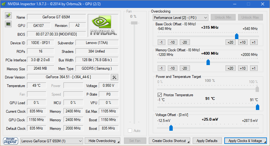

What I wasn't able to do though is install the OC vBios to the 2nd 650m GPU. Not sure what to do about it. Tried unlocking the EPROM, and when I tried both DOS and Win versions of NVFLASH, it acts like it's flashing, it even warns me when I try again that the vBios is *.33 and not *.3A, but NvidiaInspector still says it's 3A, and it's definitely locked.
pic:
y500_650mOC.thumb.png.dff2dd933b3e07598c
Good luck you guys!

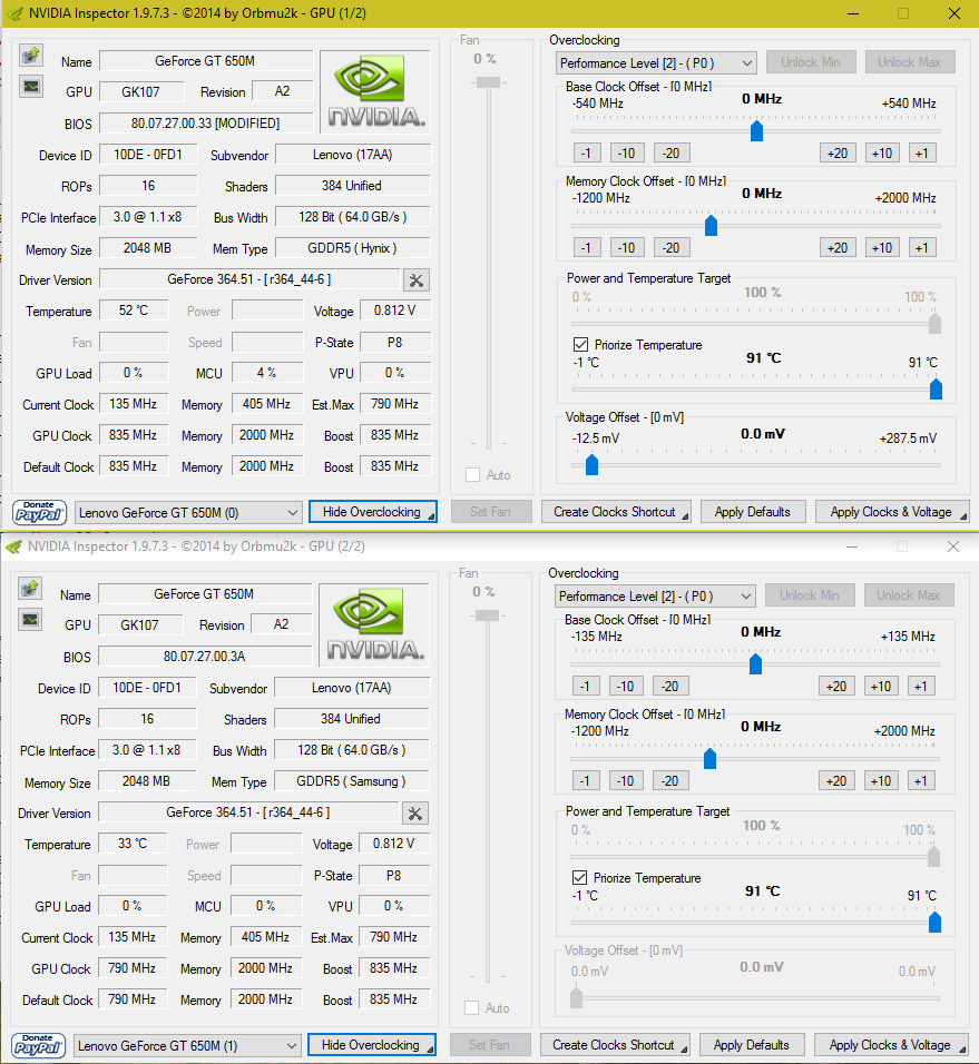

Oh man. UPDATE!
So, I was able to update the bios on the Ultrabay 650m. I used the latest NVflash64 for Windows I could find (v.5.265_win) that I could find. Remembered to UNLOCK the EPROM (nvflash64 -r). Then Followed the instructions. I think the different thing I did this time was REBOOT IMMEDIATELY, before doing any futzing around.
I may have forgotten to say that this was all on Windows 10 Pro (64bit). I'm pretty happy about this. Totally extending the life of my Y500 from 2013/14??? I can't even remember. Next up will be to install a mSATA SSD drive as a new boot drive with a FRESH install of Windows 10, and not have to worry about losing all my stuff (meaning game installs) on the slow stock HDD.
y500_650mOC1.thumb.png.cdce87b8e366f7a3a
