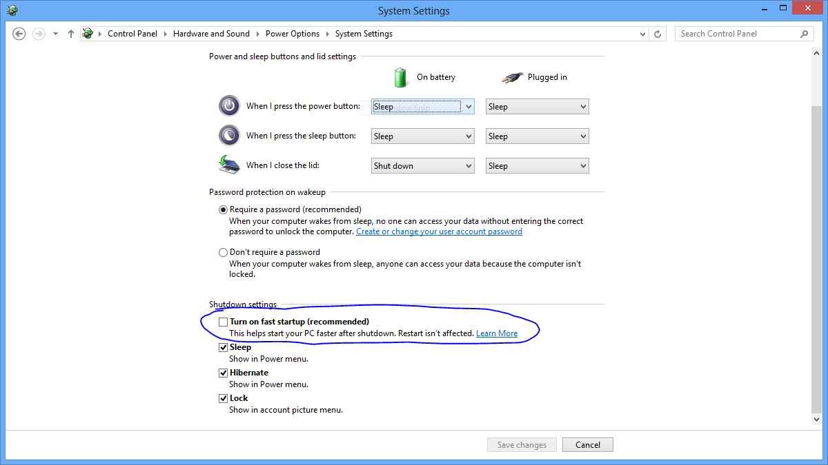

Hey svl7 after I flashed the custom v 2.02 BIOS on the Y400 I'm not able to use Bluetooth....it doesn't detect it. Do you know how to re-enable it? Or the modded BIOS disables the Bluetooth feature completely? Perhaps I did something wrong while flashing
Try restarting the system. There's a bug with Windows 8 where Bluetooth disappears when you put the computer to sleep, hibernate, or use hybrid shutdown. The only way to get it back is to restart the system or perform a full shutdown and boot. It has nothing to do with the BIOS mod.
what do you mean by doing a full shutdown? you mean removing the battery and disconnecting it from AC? because if it's justa normal reboot then it doesn't work...
No I mean shutting down after unchecking this option:
