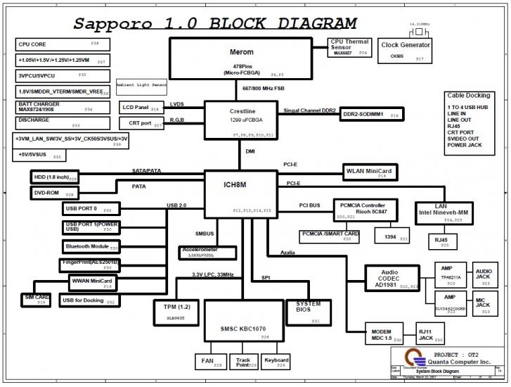

Schematic 2510P-Quanta-OT2-schematic.pdf courtesy of laptopdesktopschematic. Block diagram in the spoiler:
