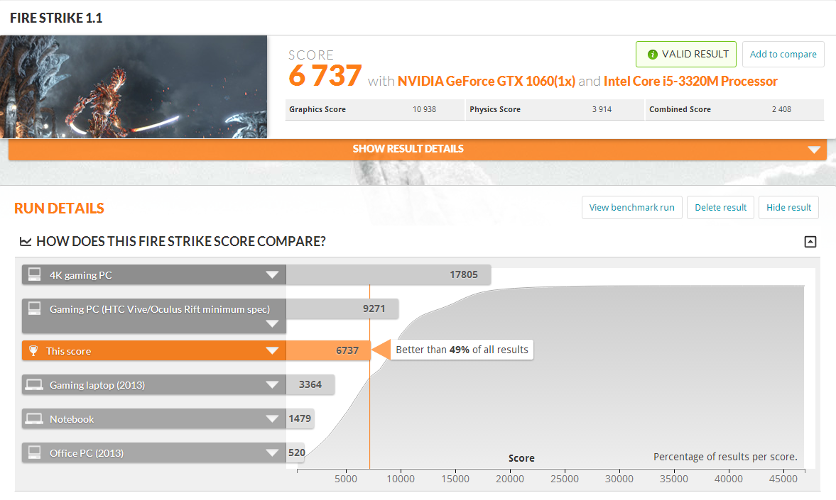

Benchmarks (highest OCed GTX660) 3dmark: 06/vant.gpu/11.gpu=19842/21071/6108, RE5.dx9=160.3, dmcv4.dx10_s4=159.4]

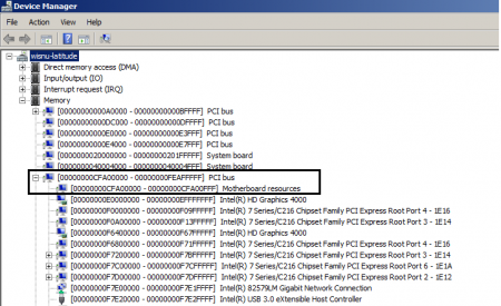

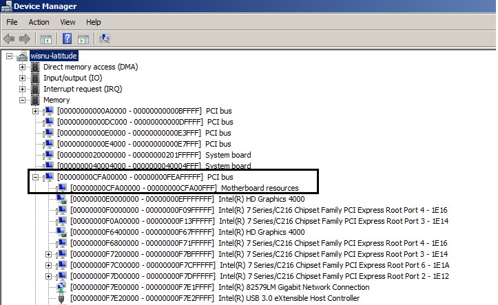

  • It has a dynamic TOLUD. Initially it had a TOLUD of 3.5GB, however, upon the bios detecting the powered eGPU on bootup it changed TOLUD to 3.25GB. If you happened to have performed a DSDT override with TOLUD=3.5GB to get the eGPU functional, as I did, then when the bios had changed to TOLUD=3.25GB you'll see a bootup BSOD. The only fix was to reinstall Win7 from scratch.
  • The eGPU becomes primary video device if detected by bios on bootup. The maximum 6.9s PCI Reset Delay on the PE4L isn't sufficient to prevent the bios from seeing the eGPU. There the bios sets the primary video device to be the eGPU, disables the iGPU and results in only x1 2.0 performance rather than x1 2.0 with pci-e compression (x1.2Opt). This is useful only for my purposes as it allows x1 1.0 and x1 2.0 testing without the pci-e compression engaged. The workaround is a manual start the eGPU after bios boot as described below to get x1.2Opt performance.
  • The expresscard slot is set to Gen2 (pci-e 2.0) as the default link speed. No bios option exists to downgrade the link to Gen1 (pci-e 1.x) speed in case you are using older pci-e 1.x specced PE4H 2.4 or PE4L 1.5. You'd need for Setup 1.1x to do that. For best performance it is recommended to use Gen2-capable PE4L-EC060A 2.1b DIY eGPU hardware instead.
Starting the DIY eGPU on a Dell E6230
Once TOLUD has been set to 3.25GB, the DIY eGPU implementation on a Dell E6230 with a PE4L-EC060A 2.1b is plug-and-play. Here's how:

Hey Nando, Here is my config : Dell e6230, Core i5 3320M, 4GB RAM BIOS A09 + ASUS GTX 660 Direct CU2 + a PE4L.
I tried to enable the eGPU but my TOLUD doesn't change from DFA00000 to CFA00000 automatically. My eGPU does get detected when I connect it, I know so because it shows up in the device manager when I turn it on when Windows loads, and also when I boot with the eGPU running, my internal display doesn't work, my external display also does not work, but I can "hear" windows boot up, login and shut it down with out the main display.
Can you please help ? Thanks a ton in advance !
Latitudes will dynamically adjust the TOLUD if they see an eGPU on startup. The problem is that they also disable the iGPU. Because of this it is necessary to hotplug the eGPU after BIOS POST so that the BIOS does not disable the iGPU, but this means that the TOLUD will not be automatically lowered.

Further to Khenglish's comments, I've documented that the TOLUD changed in my E6230 bios from 3.5GB to 3.25GB upon detecting the eGPU. This was a permanent change that I couldn't, nor wanted, to reverse.
I'd suggest installing the latest E6230 bios. Furthermore, I had 8GB RAM installed when this TOLUD change occurred. If yours won't change then you can still do a DSDT override, as I did, to get successful eGPU functionality with 4GB+ of RAM installed.

Is that 3dmark06 score with internal or external LCD? You can see I got a score of 19673, quite a bit more than your 16111.
Try changing your Power Profile to be Maximum performance to see if that improves your 3dmark06 score. Ensure the external LCD is attached via the HDMI port on the video card rather than the HDMI port on the notebook so it routes out directly rather than via Optimus/internal LCD mode.

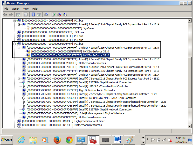

dear all, I have follow step by step instruction and get same problem with @Sunay here is my spec Dell E6230 - bios a14 i5 3320M 2,6 ; 8GB ram ; win 7-64 with
PE4C v3.0 (PSU - CX600M) Nvidia GT210 (trial GPU, borrow from my friend). Samsung Monitor (1440 x 900, 60 hz)
I think, I need do dsdt, so I folllow dsdt step by step using DSDT editor Linux_Windows when i reach the end of dword entry and going to add qword entry, i found that dsdt.aml file already have qword statement.

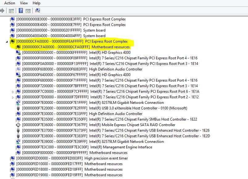

Hi, I just solved tolud value without changing DSDT
initial before tolud value permanent change
<spoiler>
</spoiler>
permanent tolud change
I modified step from solustion#3 error 12 - DIY eGPU trouble shooting FAQ
Step to change tolud value
1. Set delay switch1 value to 3 and delay switch 2 value to 2 at PE4C G3
2. Turn on laptop with EC adapter (GPU also turn on using booth together function)
3. Device manager will detect GPU as standard video card (with error 12) and several HD audio hardware (in audio section)
4. Disable HD audio from GPU and disable Standard video card
5. Restart laptop, as per win7 request
6. After restart, open device manager, vga(egpu) disable then turn off eGPU, rescan hardware change (eGPU not detected)
7. Put laptop on sleep
8. Turn on eGPU then wake up laptop
9. Enable standard video card on Device Manager and restart (as per win7 request)
10. Check device manager (device manager > view > Resources by connections), tolud has change as per @Tech Inferno Fan documented)
Tolud has changed but i still have error 12 problem.
I going to follow @gharimanto step by step solutions
@gharimanto solutions work perfectly, without restart problem and unable boot with eGPU.
I'm using delay switch to prevent bios detecting eGPU

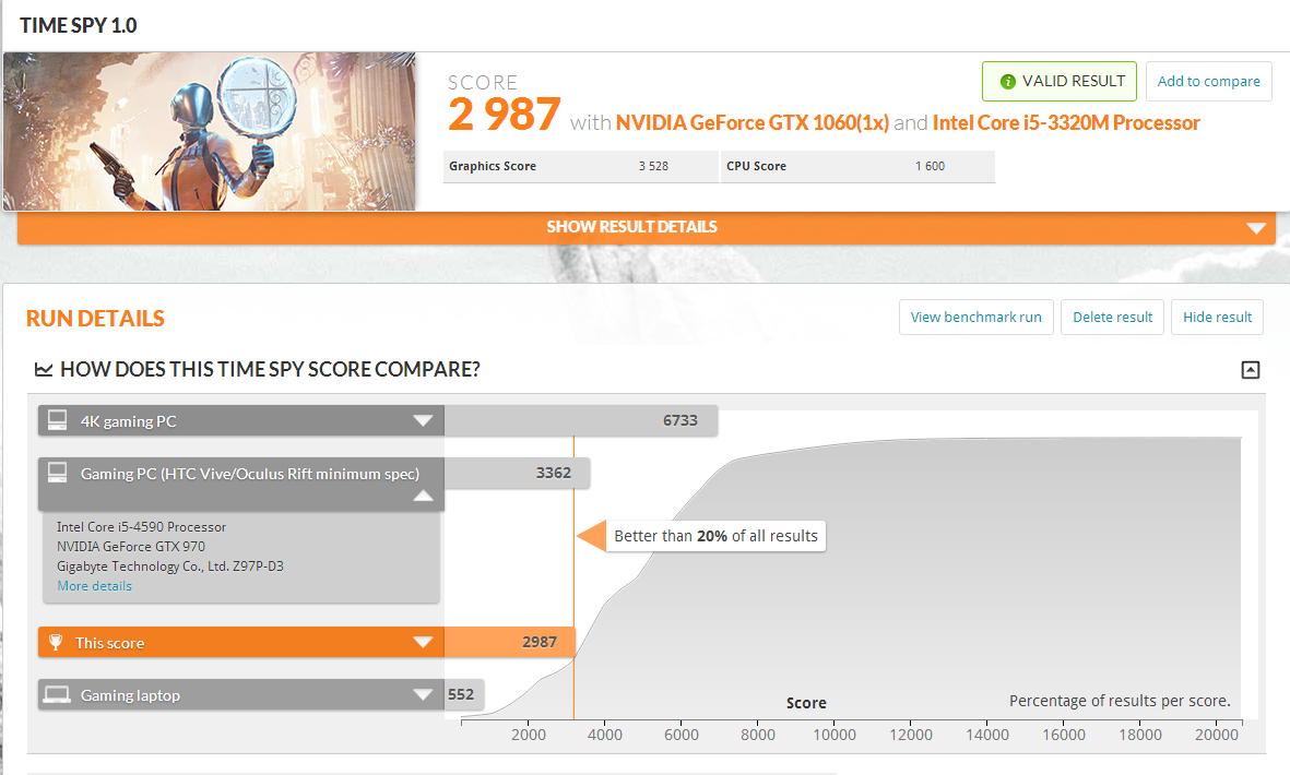

I just post about performance gtx 1060 with this laptop
Firestrike. Look the graphics score, performance decrease about 20% than the desktop
Spoiler
This is same with Time Spy
Spoiler
