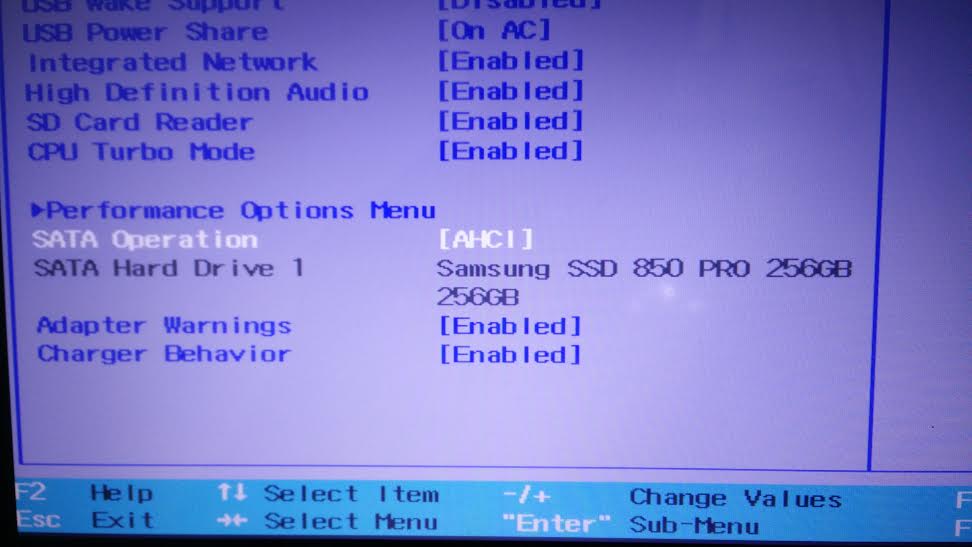

Bought the 850 Pro 256GB for my M14x R1 and it works like a charm. But haven't bench-marked it to verify the speeds but I have flashed the SATA fix A08 bios and boot up takes less than 20 seconds. Pretty happy with it.
Hey llcooljerry! Since the ssd upgrade, are you experiencing any issues? I'd like to get the same ssd for my m14. Thanks!
