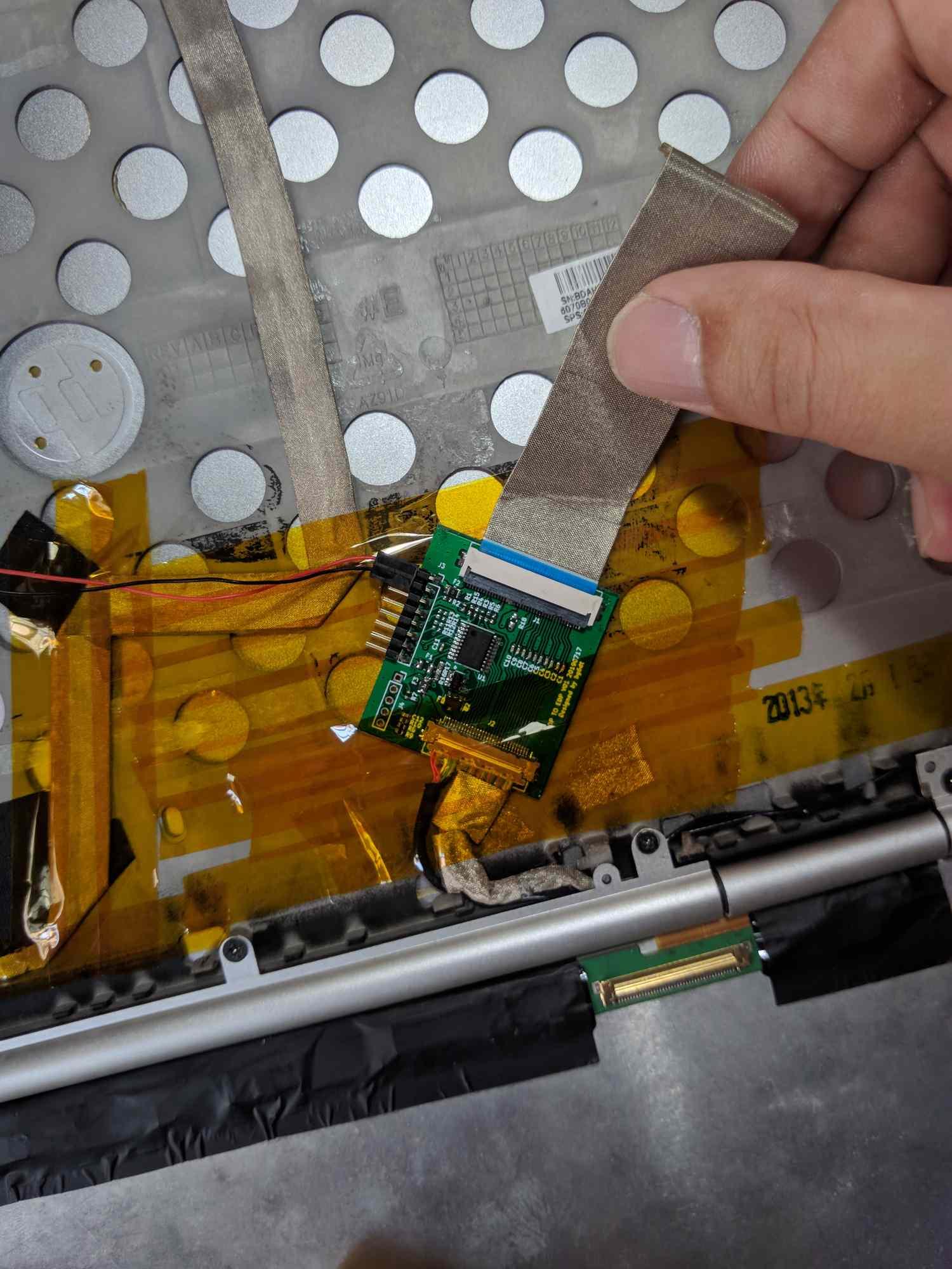

@adrian_sa, we are still waiting for your explanation about the mod how to change the screen. Where did you solder the high-speed pairs on the motherboard? And show schematic of every wires that you soldered on the motherboard. How did you do VBT modding? How did you change the default LVDS resolution to 1080p and the BL PWM frequency to 2000Hz?  Everything pls.
Posted (edited)
@invait53 Sorry, I was busy using the notebook in the field :D So far the mod holds up. I soldered the pairs to the dock connectors, there are vias on the board from which you can scrape off the solder mask and solder the pairs. Also you need HPD and I soldered the backlight enable and PWM pins to the pins of the old LVDS display. To do the VBT mods download the UEFITool and search for $VBT in non-unicode, you will find three modules, extract their bodies and open the files with Intel BMP, you can find the tool in the winraid forum. Now its been a while and I dont remember all the changes I did, I will have to find the bin file and share it here so you can compare. My method is flawed because right now I cant use a third monitor, the old LVDS interface is still working because of the backlight part, I will have to disable the LVDS and add a Arduino to control the backlight instead. I think that the HPD pin goes low when the display goes to sleep so I could probably use that.

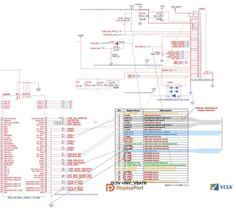

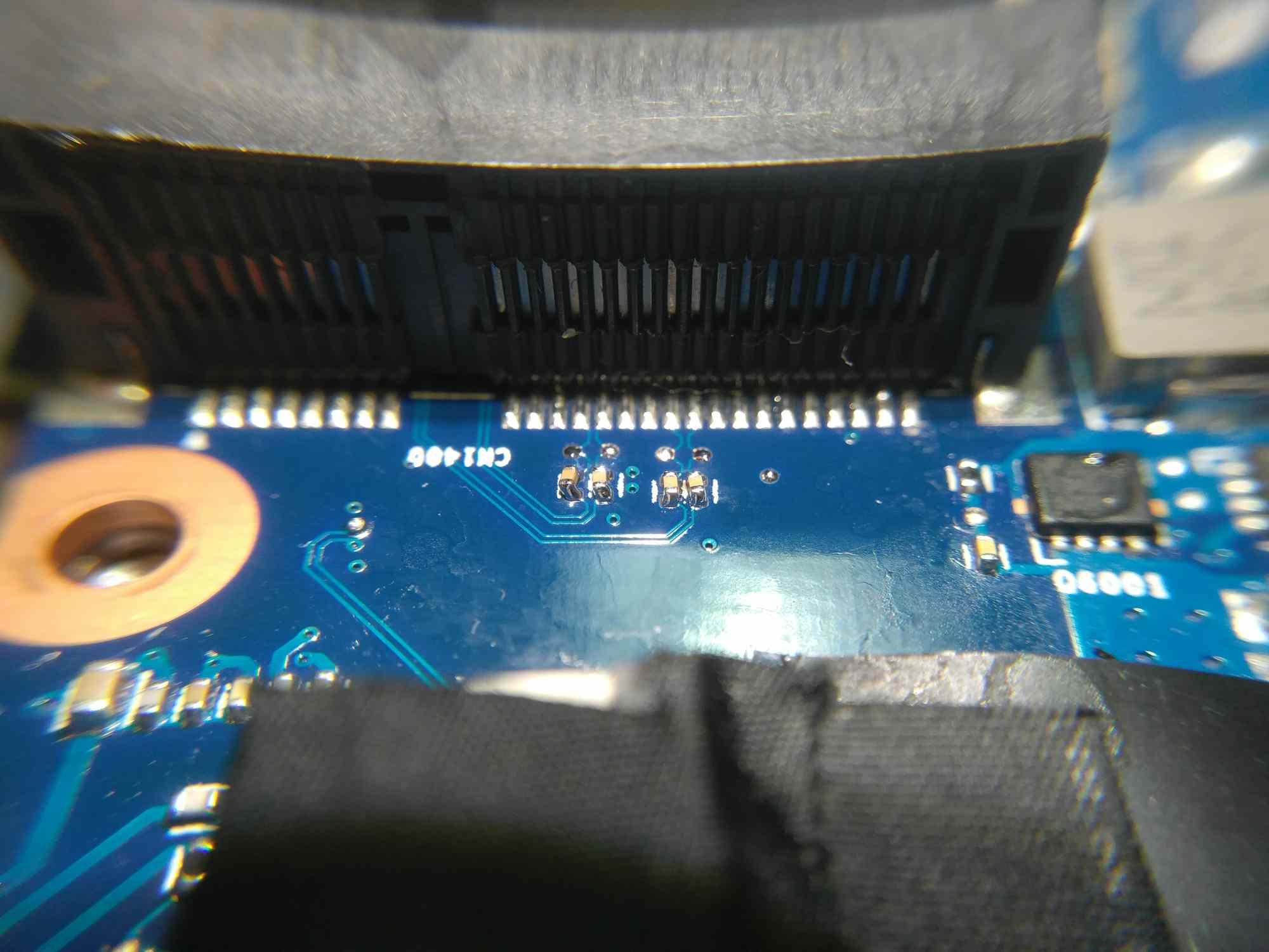

@adrian_sa, did you use for your mod capacities like in DisplayPort connector:
Hi, guys, please forgive my english is every poor, I hope you can understand what I said. about msata, I delete the BIOS's SecureUpdating module and modified PlatformSetup module, removed the modem option, added the msata option, msata works perfectly, but can't boot the system directly from msata. The BIOS version I use is F.72, modified with the UEFITool tool, if you are interested, you can test it, but you must be careful, you must know how to use UEFITool and flash BIOS. It is important to backup your original BIOS before you start.
The motherboard's WWAN socket sata line needs to solder four 0.1UF capacitors or 0 ohm resistors.

46 minutes ago, bg6dt said:
I also changed the TFT to 2K display, using the DP in the docking station's interface.
Good job, show schematic pls.

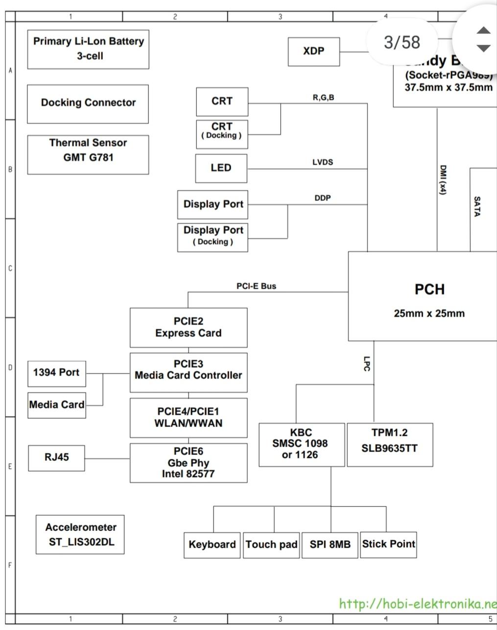

If am I right, according to hp 2560p schematic, if we remove the wwan whitelist we can get egpu pcie x2 2.0 bandwidth with expresscard and wwan mpcie slots.

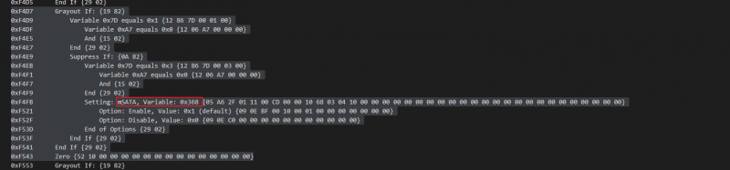

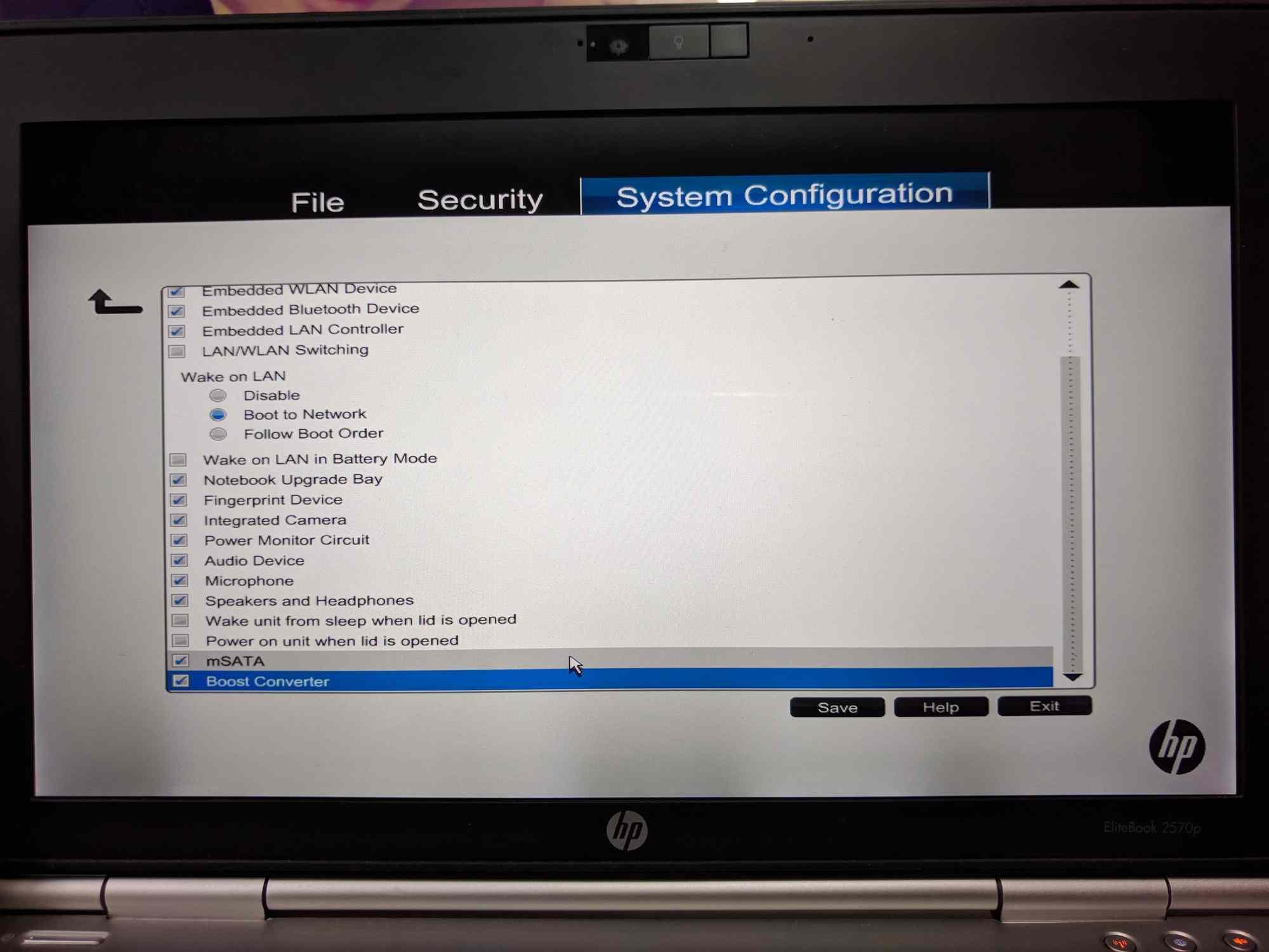

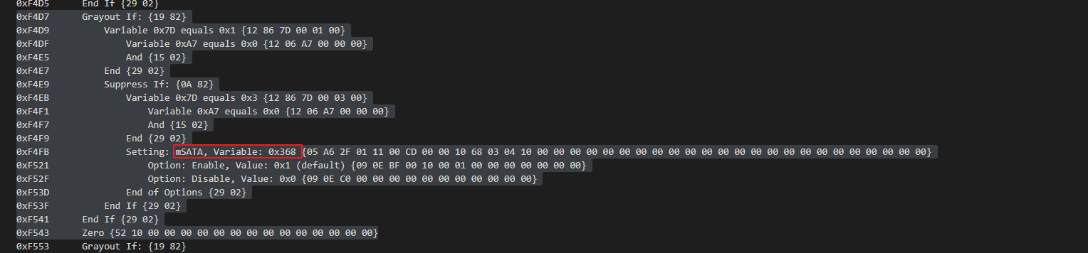

Hello, how do you found that? Did you edited IFR section (or replaced from 8*70 PS module)? I see a lot of changes. Am i right that WWAN-device will be inaccessible then? I've noticed that Bluetooth option after removing according module didn't affect anything thought, maybe with WWAN will be same story.
Quote
Well, there's no surprise. @juandante asked about msata-enabled RAID, maybe it's available now.
Good work anyway.
Only if pcie lanes is physically wired to the slot. @adrian_sa tested WLAN card already in the WWAN slot with no success. I've checked some schematics, pcie is wires into the same pcie pins that mSATA is used, so there signal commutator is needed. Dunno if it really exist on the motherboard side under the keyboard, but i think there is just no any option for combo cards in WWAN slot.

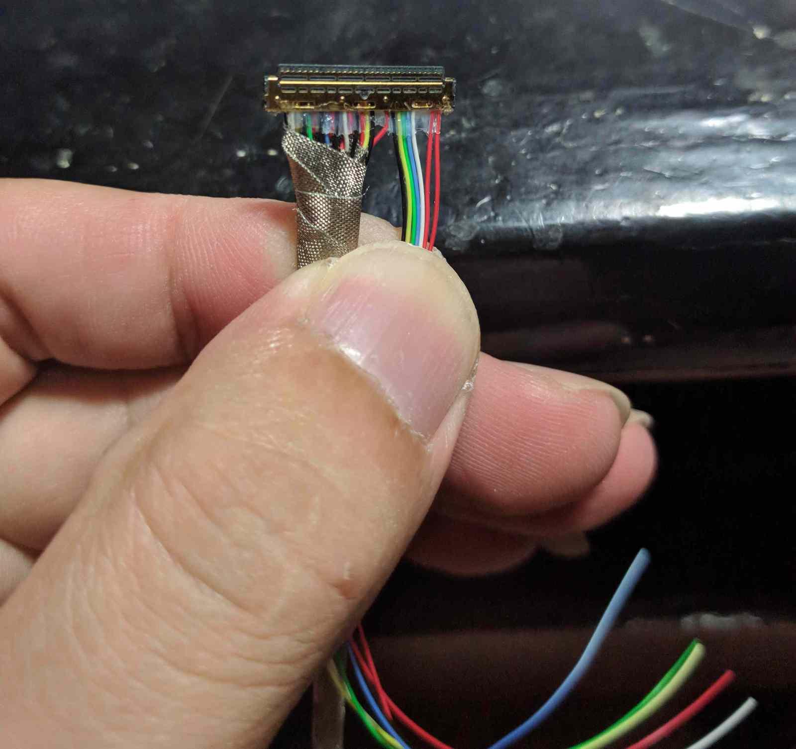

eDP and DP are compatible, you can buy the cable I linked a few pages ago and solder it directly to the board, The vias are exposed near the dock connector under the heatsink.
@adrian_sa Thank you very much. If I'm not mistaken, with your mod I'll not able to see Bios. Did you twisted the line wires? What the length of cable? In theory this mod let me use the 4 line display. @bg6dt have done the mode with 2K screen. Maybe by the same way. I hope he will share it with us.
I used the wire that I linked on aliexpress, just cut off the connector and solder the wires directly. I can see the BIOS, posted also about that, the BIOS doesn't work in full UEFI boot mode but if you switch to hybrid it does work. I also modded the VBT so I can use clone mode for the display. Right now I can you only the internal display or an external display via DP or VGA. I can't use extend mode. I dont know if 4 lines would work with this basic method, 1080p uses RDR(reduced data rate), for 2k you need HBR so there is bigger concerns about signal integrity.
The next step would be to implement MCU which would take care of the backlight control, but I don't where to get the Backlight enable pin if I disable the LVDS interface. The HPD pin is always high when machine is on. The Chinese x230 FHD mod uses USB with software I suppose to control the backlight.
Yes, what you said is correct. I compared the BIOS of 8770W. after edited the IFR section, the key point is this: Variable: 0x368, and I have deleted the WWAN module using UEFITool. I plugged the bluetooth device into the WWAN socket, bluetooth Work perfectly, no whitelisting problem.

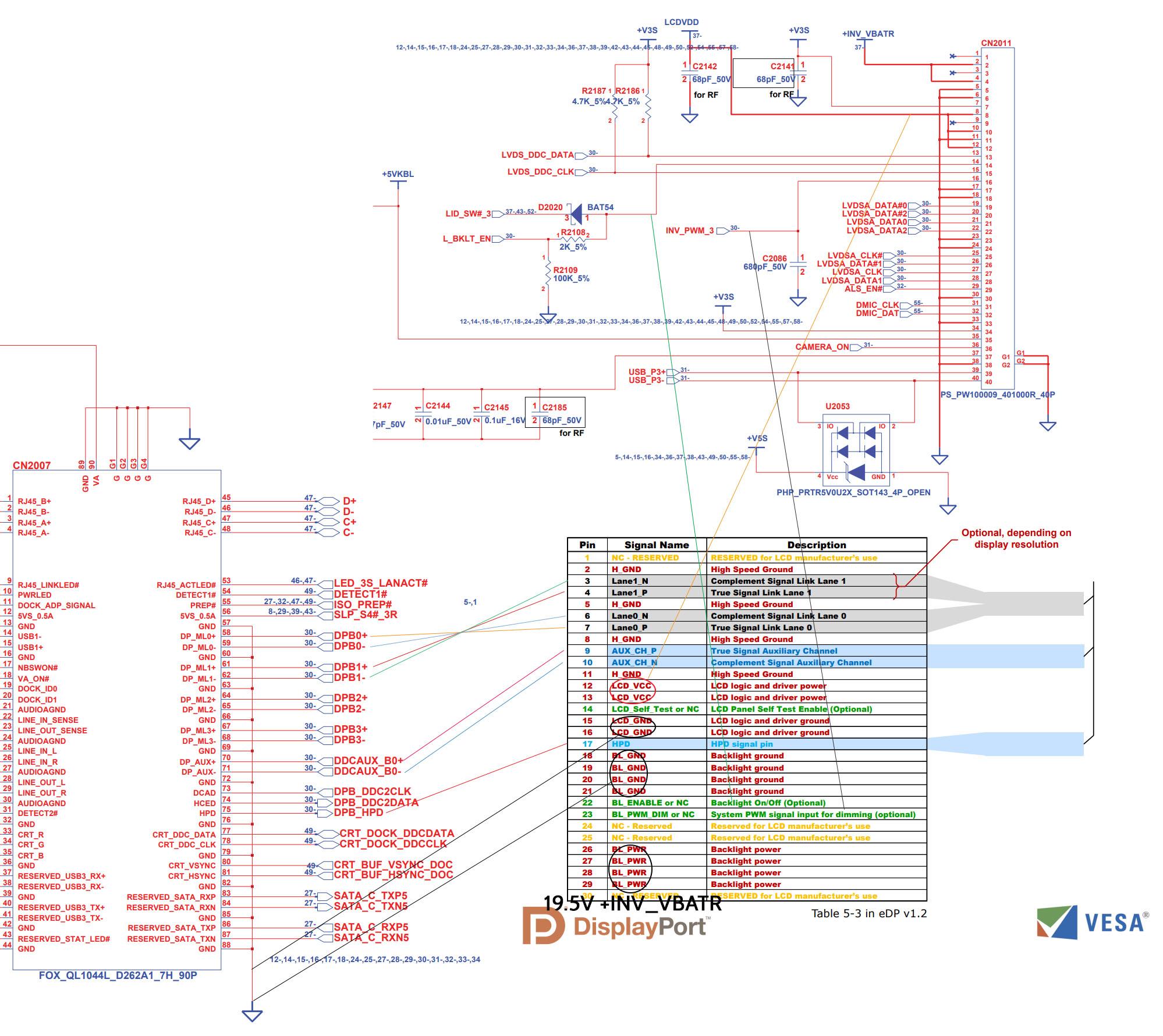

Backlight enable detection, I used the voltage detection of Lane0_P, when the EDP has a signal, the voltage is 0.5V, when the EDP has no signal, the voltage is 0V, MCU uses ADC detection, output high and low level signal control panel backlight.
Backlight brightness PWM, MCU detects keyboard FN+F9 and FN+F10 buttons, output PWM signal  control panel brightness .
Modify BIOS VBT, modify with Intel BMP Utility tool, delete internal LVDS display, do not use clone mode, only one monitor, full UEFI mode works perfectly, external monitor works perfectly. The BIOS version I use is F.72, see VBT.ZIP file.
2K panel model: LQ125T1JX03C
Edp signal cable, I made it myself, the signal cable length is 13cm, the differential signal cable is twisted and twisted, covered with shielding tape.

IMG-20191017-002856.jpg@bg6dt Thanks for the tip, got the backlight working and also applied the VBT mod. What did you do to the IntelIvbGop and IntelSnbGop drivers? Is this from a another machine?
That's great. I am very happy that this is helpful to you. You mean IntelIvbGop and IntelS nbGop drivers?I replaced the new driver with the UBU tool(UBU_v1.71.1).
I am curious to know how your backlight works, panel enable signal and the pwm signal.
Edited by bg6dt
