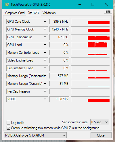

Hello again,
Im using svl7's v2.07 bios (40ww) and I knew this bios have 1.10 voltage. But there is my problem. Im checking my gpu sensors and sometimes it shows the gpu voltage 1.0870.
I wanna ask this to you. Is there a problem ?
