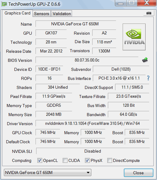

There are three 650m vbios in there, which one gets actually used? What does GPU-Z say? I assume the latest one... but still... let me know.
Please take a look on gpu-z screenshot, it says bios - 80.07.35.00.0c (I think it should be inside A11 dell's bios file that I'm currently using - '7720A11.exe'). Is it what you need?
